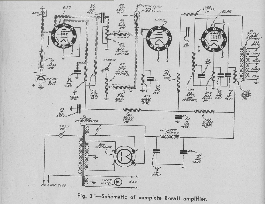

"I did not notice comment on the large unbypassed 10K screen resistor in the original schematic."
Well, a high screen resistor would certainly soften clipping in one direction as the screen current suddenly rises with saturated (minimum) plate voltage. (By dropping the screen voltage.) But 10K seems very high, so maybe some dynamic gain compensation is intended in the output pentode's "linear" region.
(ie, countering some of the non-linear 3/2 power law characteristic of the pentode) Seems the design was tweeked by ear until they got the sound they liked best.
"One of my PP amps uses 6P1P outputs with screens of each in the pair joined and connected to 260v B+ via 1k5 with no bypassing."
This would seem to be intended to soften clipping in both P-P directions by dropping the screen voltage when a plate V drops into the saturation region (via suddenly increased screen current). Having the two screens connected together would tend to cancel out any variation of the screen voltages while the two tubes are in the linear P-P region. Well, providing they are operating in class A. For class AB or B, I would think that a bypass cap there would be a good idea.

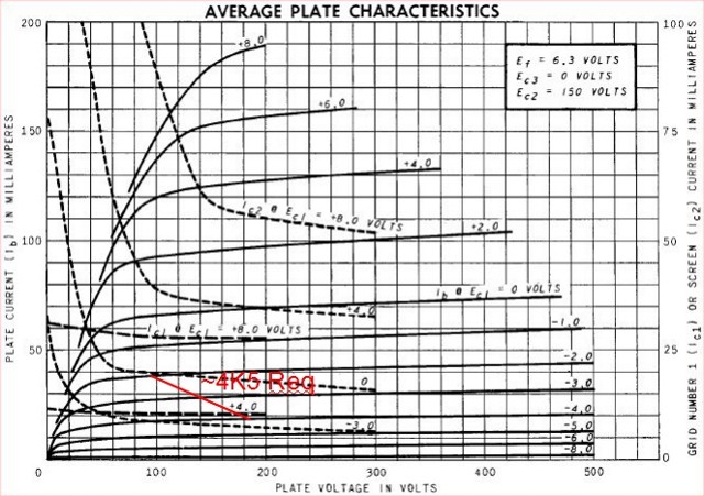

"what are the implications of the screen at a higher potential than the plate? Good or bad?"
Well, the screen current takes off when the plate voltage gets down to the 50 to 100V range. The resistor in the screens will protect them from over heating by dropping the screen voltage. So the screen resistor is a useful safety factor.

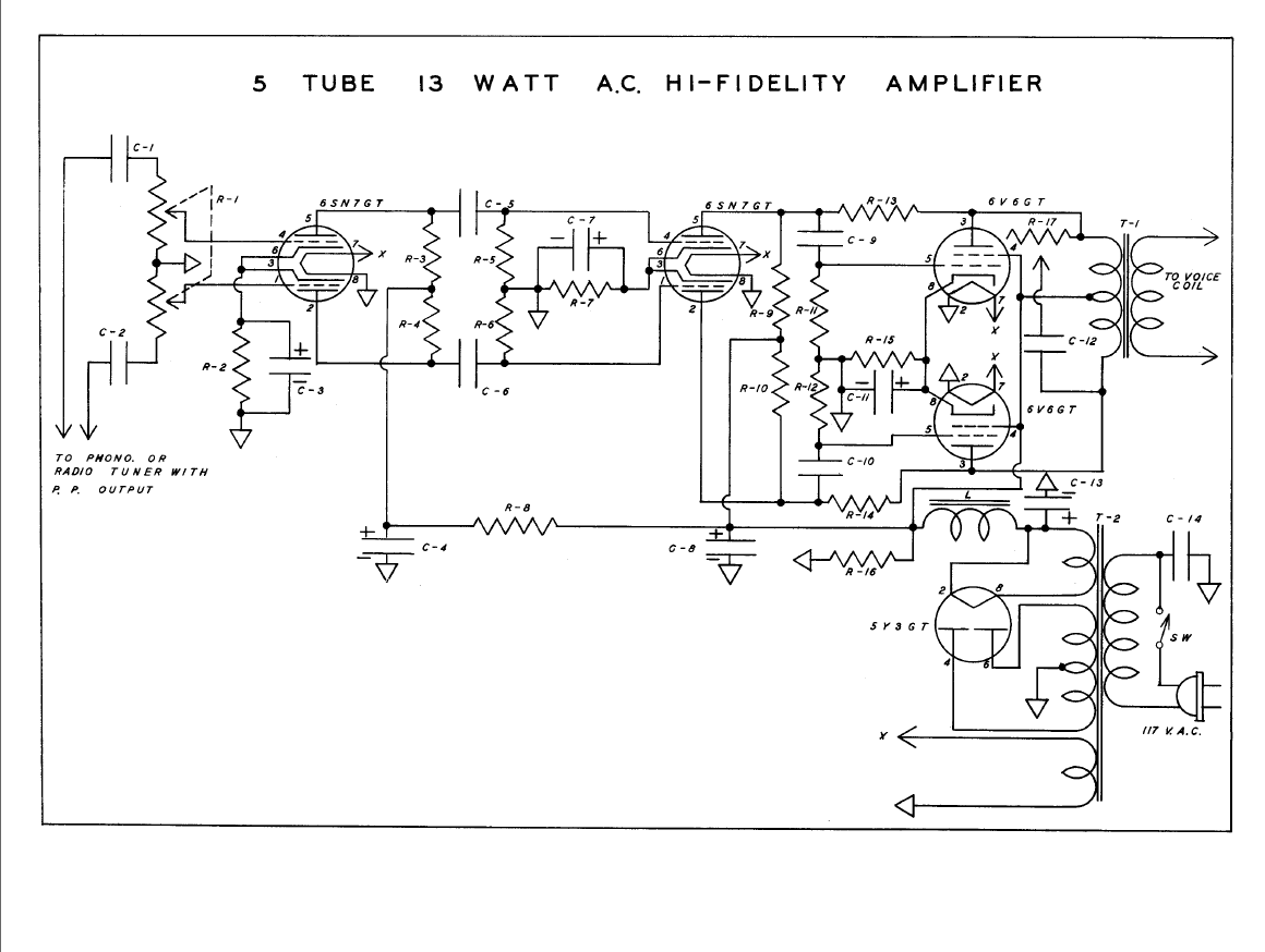

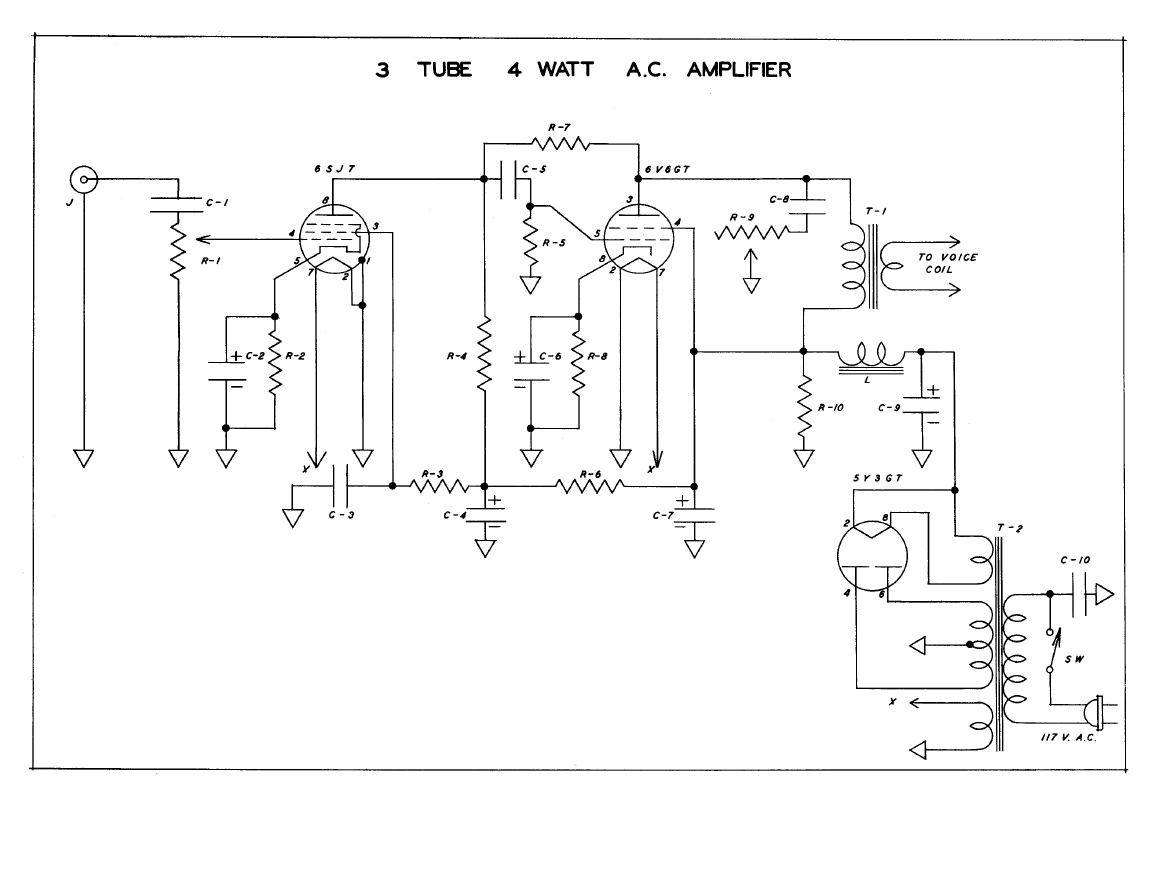

..... But 10K seems very high, so maybe some dynamic gain compensation is intended in the output pentode's "linear" region.
Not that uncommon, I was wondering about this myself until I found a schematics in the "Amplifiers Builder's Guide" publication number 33 by the editors of Radiocraft. (Especially after I read some STC documentation over the 807).
See attached scan where a 5000 resistor is used (although this has a capacitor added but I read somewhere that Alex Kitic experimented with that and a stabilised voltage too but found this to be the best solution)
Unless I misunderstand, you are talking of signal conditions; the plate going down during negative signal swings. But if a screen voltage drops under those conditions, it will promote 2nd harmonic distortion! (...unless the screen voltage is 'force-dropped' as in UL, and not going up/down according to its own current.) I am always a little apprehensive of a screen 'doing its own thing' (referring more now to voltage amplifiers) - I have seen graphs of distortion variations of 4:1 by just varying the (dc) screen voltage with all else being equal - and this is oscillatory, meaning going through several good/bad distortion areas as the G2 voltage goes from low to high. There is thus not necessarily one optimum, there are several, and they can shift about according to other parameters (wish I had never seen that EF86 analysis!).
Regarding fears of plate-swinging-below-screen-voltage during signal swings, one must again keep in mind the average effect - every alternate cycle the plate will go 'far' above Vg2, averaging the heat generated. When tube specs say that plate and screen can work at the same voltage, this is taken into account by the designer. E.g. provided average dissipation is within spec, a (say) KT88 with Va = Vg2 = 500V max. will be happy even though Va = 80V and Vg2 remains at 500V steady every other half-cycle, because during the alternate half-cycles Va will = 920V with Vg2 only at 500V. This is how I take the specs (and supported by the manufacturer). Thus one also finds that where max Vg2 is given as lower than max Va, for e.g. UL the max Vg2 is increased to = Va. (Vg2 is thus allowed to go above 'safe spec', but only while Va is much higher.)
