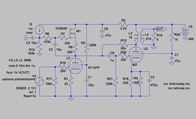

Since no one seems to have ever published the measured FFT spectra for any RH type amplifiers, the relative success of this harmonic cancelllation strategy is still a mystery.
Don
Don
The RHxx designs are based on an old feedback method that commercially has been largely overlooked.
Basically you get feedback from the plate to the plate of the previous tube through a resistor which means there is no phase lag in the feedback which is extreemly important.
Manufacturers were more concerned in showing the customers max output, minimum distortion and a flat frequency response. This max output at minimum price was achieved by using push pull, the THD has no relation to the fact that second (even) order distortion is hardly noticeable but odd distorion is very annoying. Also the distortion has to be in a waterfall effect (2nd > 3rd > 4th > 5th etc).
Most manufacturers take the feedback loop from the secondary side of the transformer so they have a nice looking flat frequency response. However the transformer introduces magnetic lag which leads to phase shift which is different at different frequencies and what is rather annoying. Taking the feedback of the secondary allowed the manufacturers to use real cheap output transformers.
What Alex showed was something that was already well known in the 1940's. Look at the two designs that I will upload from the book of "practical amplifier diagrams" which was published in 1947. Today with better output transformers (preferbly those that have been wound interleaved) we do not need to concern us too much with the 2nd harmonic generated in the OPT. Neither should we be worried about the frequency range so we can take the "short feedback loop" or "inverse feedback" as mentioned in the RCA manual # 20, 26, 30 amongst others or the Radiotron Handbook 3 and get a very nice sounding amp. Ever wondered why so many have build this amp and then proceeded to buying more expensive output transformer to build an even more "visually appealing" and "technically advanced" version of the same amp? If that is not an endorsement of an design then I do not know what is.
Actually, from plate to grid.
Since it is from plate, it is a feedback by voltage that lowers output resistance (feedback by voltage).
Since it is to the grid, it lowers input resistance (parallel feedback). Equation for amplification factor roughly includes resistance of feedback resistor and resistance of the previous stage that depends on Ri of the tube that drives an output stage. SinceRi is non-linear, an overall transfer function of 2 stages will be non-linear, even though a feedback linearizes an output stage.
That's why linearity of output resistance of the driver stage is so critical.
What Don were speaking about, he analyzed possible cancellation of non-linearities of both stages, that is quite a bit more complicated than ancient articles discuss.
I personally don't expect such cancellation, that's why prefer to use long tailed pentodes to drive output stages with parallel feedback by voltage.
Interesting examples showing 2 triode drivers and one pentode driver. Also see Gary Pimm's Tabor amps and Pete Millett's "Engineer's Amp", both using the proper pentode drivers with direct plate-grid feedback in push-pull topology.
First description I'm aware of is 1938, in "Beam Power Tubes" by O.H. Schade where he shows that tetrodes with plate-grid feedback behave in-circuit like low impedance triodes, including a push-pull amplifier circuit example. He shows series (voltage) feedback summed with an interstage transformer but the principles are the same.
With parallel (shunt, current...) feedback I think it comes down to 2 things.
1. The internal anode resistance of the driver is in parallel with the "equivalent load resistance" (which is the parallel feedback voltage current swing / driver current swing). This creates a partial feedback shunt, decreasing the amount of feedback (not necessarily a bad thing).
2. The triode is loaded with an equivalent load resistance below it's own internal resistance, resulting in potentially asymmetric current swings and a lot of even harmonic distortion. The situation is not unlike the bottom triode of a cascode, for which there are some operating regions of some triodes that yield acceptable results.
Personally, I prefer the pentode driver with high ratio of internal resistance to equivalent load in this circuit. This makes it a better voltage/current converter and results in lower impedance at the output for any given gm power tube. But the pentode operating range should also be chosen for optimum linearity and distortion profile. There is a big difference:

I agree completely with the pentode being the bog standard driver approach here (Schaded feedback, or plate to grid fdbk) as advocated by Lars, Wavebourn, Michael, .... It keeps the feedback network near linear with its high plate Z. Then some cathode degeneration gets added to linearize the pentode.
Using a triode driver is of interest if one wants to "tilt the feedback table" a bit to counter a known error tendency in the output stage. Since a pentode output tends to conduct more aggressively at high current (3/2 power law, or more like 2 power law for most power tubes, causing gm increase at high current), a little variation in the triode driver output impedance has the right phasing to counter the 2nd Harmonic distortion of the output stage. So one can degenerate the triode driver cathode until one gets the right amount of Rp variation wanted to null 2nd H. (Hopefully the driver still has some gain left after that, so a high gm triode is called for)
This only works for 2nd harmonic though, because the driver and output stages are not tracking V or I wise. Since a heavily loaded triode tends to increase all orders of harmonic distortion, (not just 2nd) one wants a tube that is close to square law (2 power) that mainly produces 2nd harmonic dist. (additional 3rd harmonic being the principle effect from the usual curved gm characteristics of constant Mu tubes) Which brings one to "bad Mu curve" tubes like 12AT7 or similar (triodes in 6LQ8, 6KR8, 6AU8, 6BH8,.... and many others) which have a near linear ramp of gm versus current at a fixed plate voltage. (like a Mosfet)
Alternatively, one could try a pentode with a lowish Rp to get the same dist. cancellation effect, and tweek the cathode resistor around to null 2nd H. (the pentode in a 38/12HE7 comes to mind for low Rp at 6200 Ohm, the 38V filament version allows one to power up just the pentode filament with 21V across pins 10 and 12, but 10W plate diss. is a bit of overkill here. A darn cheap tube though, $0.35 on sale lately. someone once threatened to carpet bomb 38HE7s on anyone who came up with a use for them)

So what I'm seeing here is that as designed this amp may not be ideal. But for my first build it's okay though right? Seems I can endlessly tweak it using different voltage and tubes.
For your first built it will probably be more than just OK - if you have decent iron.
One concern with the RH807 could be the sensitivity, depending on your source or preamp. It will require about 1.4V RMS input for full power.
The EL84 variant is easier to drive, and the dangerous high voltages are a little less dangerous.
If you build the chassis with space for two separate input tubes, you will have near endless alternatives for tweaking and modifications with both input/driver tubes and combination of feedback schemes.
