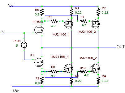

Well, here is an output stage that I have drawn up. No sims or anything. I used the BJT parts that Chris recommended. Any thoughts on this, before I try a simulatution?
The driver stage is biased into class A up to 100watts RMS in to 8 ohms at 100mA. And I just kind of guess with the base stoppers. I suspect this would take some playing around with to get it just right.
I would probably take Chris's advice and add 5-6dB of feedback as this amp has about 30dB of gain.
So, there it is.
So, there it is.

You can't implement that output stage as you've drawn it. The On Semi parts are BJT types firstly, so nowhere near a 1:1 swap. You will need a bias control circuit (there is one already, but the thermal gain may be off). You also need a buffer between the voltage amp and the outputs. Tube outputs are not going to like a highly variable input impedance like one presented by a standard triple either.
I used a power diamond buffer. When you've got it working right, the best sound quality I've heard. When it isn't working right, it sounds "off". Also, it will current limit depending on how you set it up. The core of my output stage is a diamond buffer, but there is more and I'm not done yet. The best part is that my worst case DC offset is +/- 35 mV - without adjusting anything!
