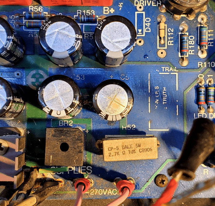

I got a power transformer manufactured by a company in Poland. So now I'm doing the power up testing and it looks like I got a defective Nichicon capacitor! The one at right labeled C5 is in parallel with the one labeled C53 to its left. When I reached 50% line voltage on the variac, C5 started to vent. These are the DC filament smoothing caps. It was a royal PITA to get to the solder side of the PCB because there is no removable bottom plate. The whole board has to be disconnected from the MOSFETs, jacks, etc, to flip it up for solder side access. Super frustrated! Been waiting 7 months to get a transformer for this, and now this happens. This is a negative profit repair. It's become a personal challenge, as it is way over budget and now coming out of my personal time.
You should replace both caps - the other one will fail soon...So now I'm doing the power up testing and it looks like I got a defective Nichicon capacitor! The one at right labeled C5 is in parallel with the one labeled C53 to its left.
And since you have the board out, I recommend replacing BR2 (that also fails), mounting it on flying leads with the rectifier bolted to the chassis floor for heatsinking. That way it has a chance of actually meeting its current rating
2 hours later, I have replaced both capacitors with high voltage caps. In tracing out the paths, I found out they go to the rectifier on the 270V winding. No wonder the originals were exploded too! I'm baffled as to how this amplifier ever worked.

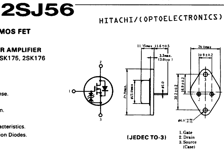

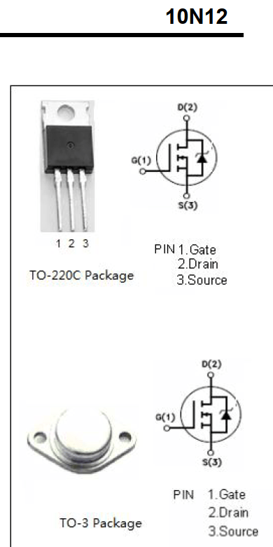

The other thing I am re checking is the pinouts on the Hitachi devices compared to the ISC brand devices.. they appear the same according to these data sheets..

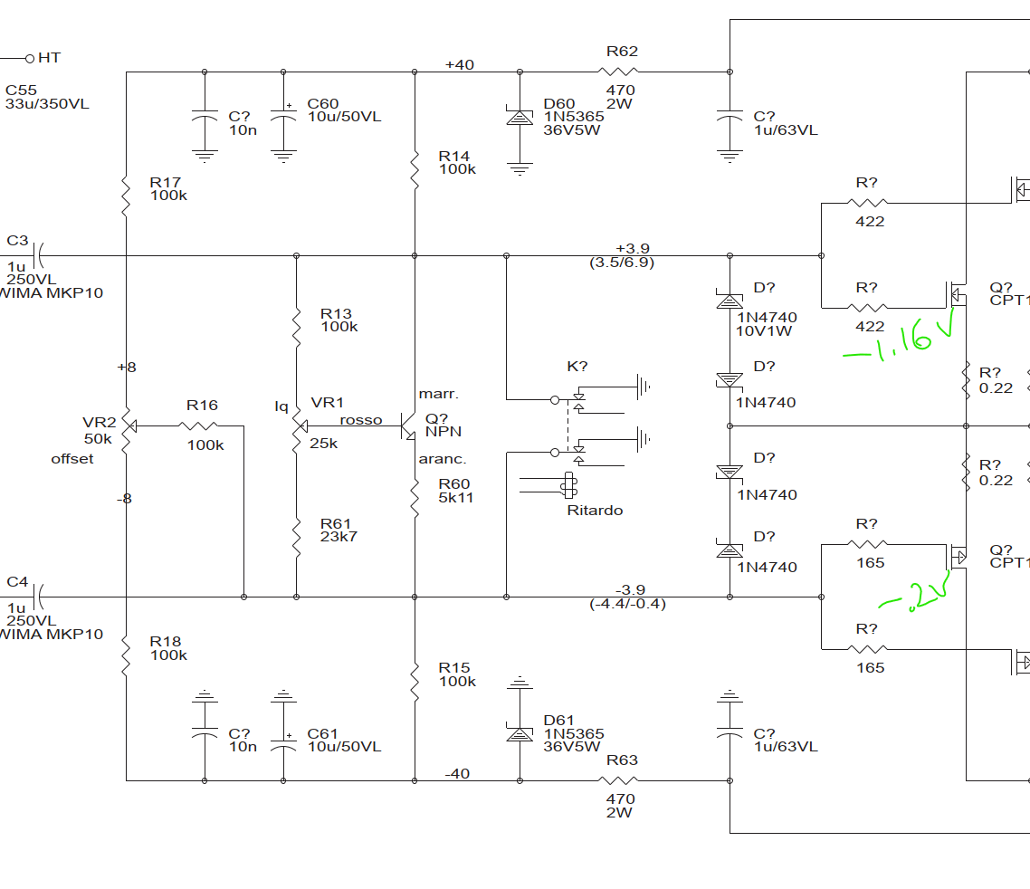

On the P junction, it will only adjust down to -1.164v. The N junction gate reads -0.2V.
I had the thought that maybe the offset adjustment was off, but that only causes the N junction to go to zero when I get the P junction to be -1.1v.
I'll recheck that I did the mods correctly, but failing that, it looks like this amplifier takes the record for fighting me at ever turn.
Well this is what I got in both channels.. MOSFETs not installed yet. Maybe I should retest the four zeners, R14/15.
The best I'm able to do after adjusting the offset and cranking the bias pots full CCW, is -0.95 n P junction and + 0.95 on N junction.
I can't find the four zeners mentioned on the schematic. They don't exist on this particular board s/n 21H11.
