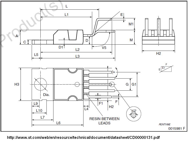

Interesting. Can you measure the die size with any accuracy?
DUG's package details are quite useful here.
15.1mm < L6 < 15.8mm
6.00mm < L7 < 6.60mm
(H2 = H3) < 10.40mm
Let's take the midpoint for these ranges, and assume L6 measures 15.45mm, L7 measures 6.30mm. L6-L7 = 9.15mm which is the plastic part's length in the package, where the die is mounted. Using a ruler I measure 10mm for H2=H3, and 9mm for L6-L7. Good enough approximation, then.
Let's input these measurements into Photoshop's vanishing point:
Picture 1
Picture 2
Picture 3
10mm H2=H3 results in 9.05mm calculated for L6-L7. Excellent. Measuring the die itself, we get 2.07mm by 1.81mm, which amounts to 3.7467mm² ~ 3.75mm². Absolutely tiny. The original, real TDA2050 die looks gigantic in comparison. I think my 4 times smaller eye estimate is accurate enough.
