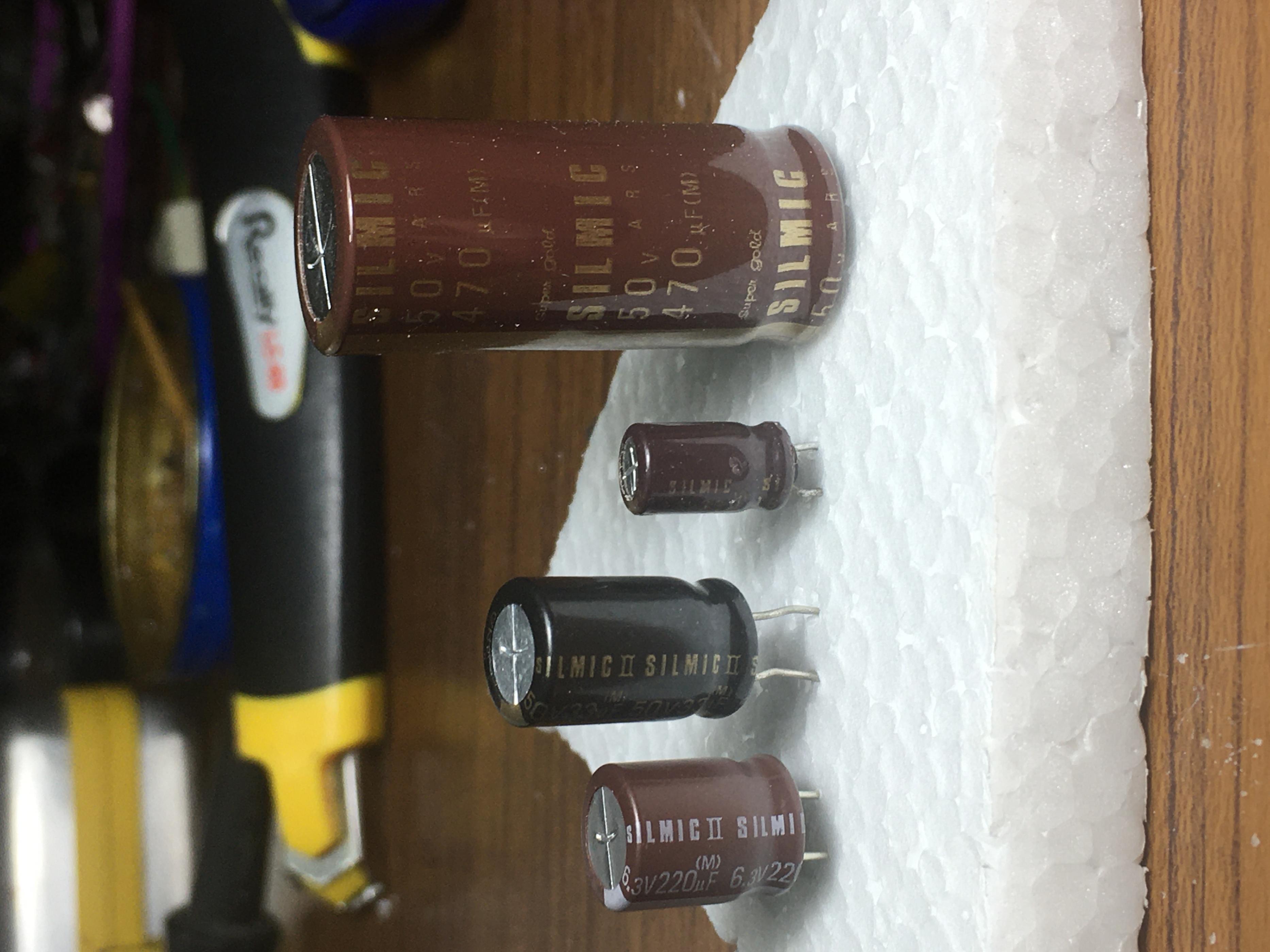

Just to help reduce the confusion. Cap on the left are what you guys get when purchase from Mouser etc these are from Thailand, next Black/Gold from Japan,
as you can see even the little cap will also has the stamped top. Now comes that big cap, bet many have never heard of this one its called Super Gold limited & only for Japanese market.

So it seems that they could be authentic coming from Japan, but it is difficult to be sure....

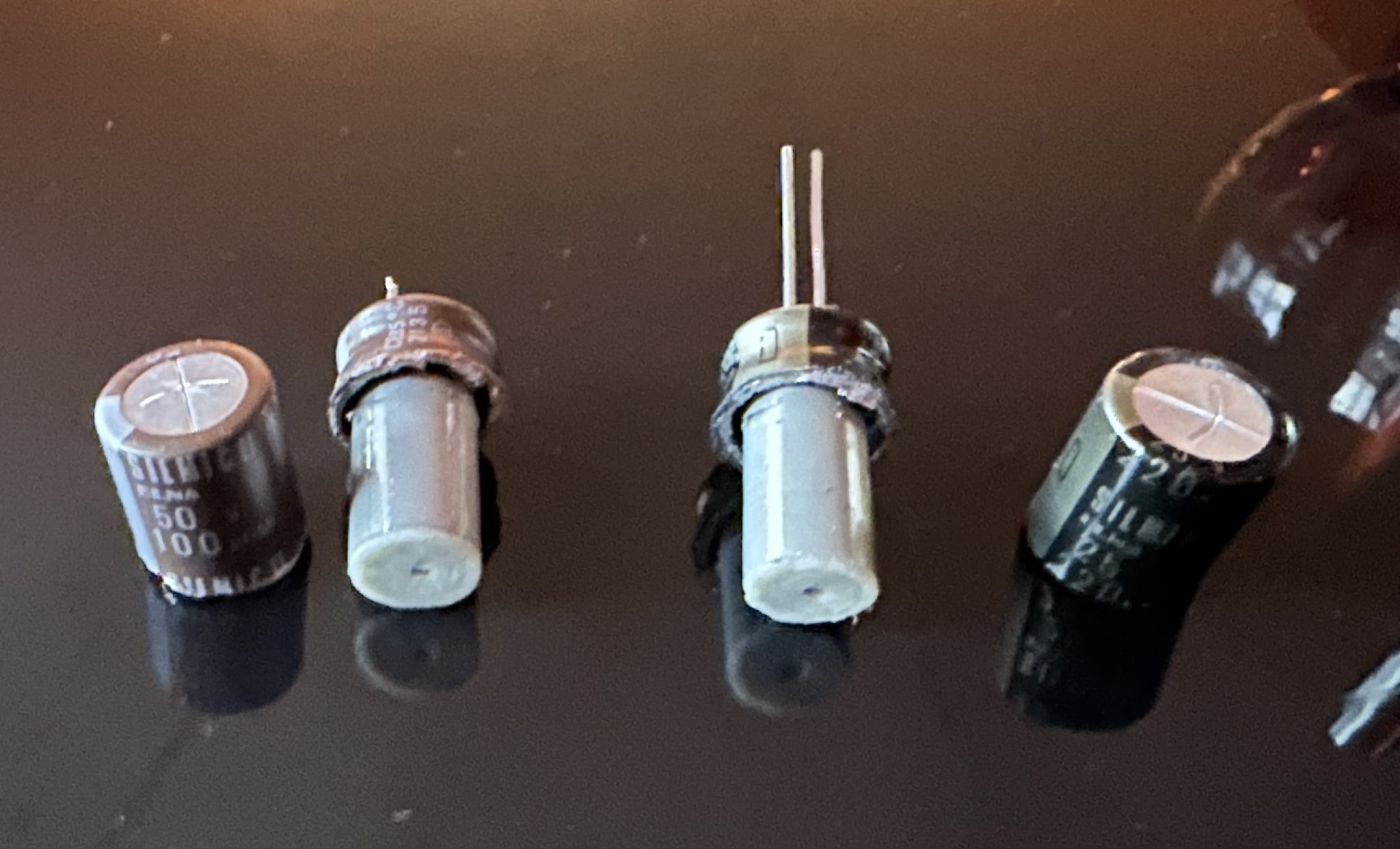

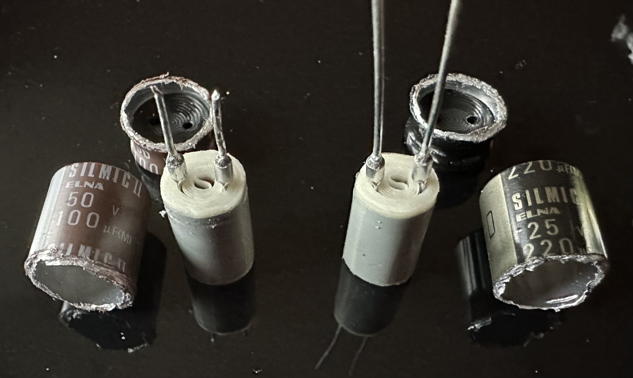

The Silmic II caps with black sleeve and gold markings are the real deal. They probably are manufactured in China by Jianghai which has a joint venture with Elna since more than a decade. They are producing in License for Elna. They even have a plant in Germany near my home.
Just to be sure I opened-up a brown 100uF-50V from Mouser and compared it with a black-gold 220uF-25V from China. See picture
They are exactly the same. Same build, same leads (tinned red copper) etc.
