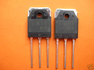

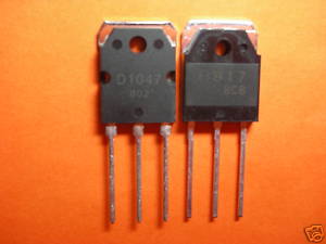

Here is some pics in case youv have those parts mounted. The first is originals and the other 2 are fakes that are being sold by some suppliers.

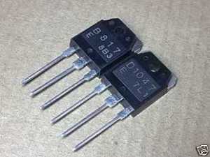

Look at the folowing pic, this is how good fakes can look, these were supplied by german supplier and the pic they sent me of a sample, the stock supplied to me resembled the pic 100 percent. I was still a bit suspicious so I sent them off for sanyo to inspect, fake was the reply. The 2nd pic is of originals in a rotel amp.
Here in my country 90 percent of transistors are fakes, this industry is in a mess. Companies making these fakes are getting very good indeed where the fake part is virtually undistinguisable visually from the originals.

looks real!
Homemodder, that last pic does look like the real thing!
I caught a documentary recently on PBS (Frontline?) that discussed the explosion of fakes across the world. I remember when Blackhawk helicopters were crashing due to fake bolts on the rotors. And they said the probably has gotten significantly worse.

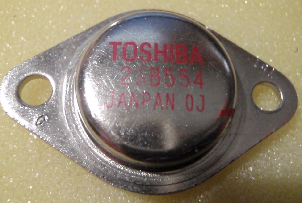

You guys should get a good laugh out of this. I bought 5 of these for $15 from an ebay seller well before I started my Adcom repair. I promptly forgot about them until I was cleaning up the bench and putting stuff away.
I didn't have to look very hard to determine they were likely fake. See if you can see what tipped me off. <grin>
Apparently, sometimes you don't have to saw a TR open to see if it's fake. I'll open one anyway out of curiosity and post a pic here when I do.
I don't know what you're talking about fredlf, but I had some great Janpanese food tonight. 😀
Chris - yeah, I'm having too much fun and this fine-turning should eventually put a big smile on my face. I'm going to check the capacitance on these bad boys and see what I get.
I Googled Janpan and Google asked me "Do you mean Japan".
Why is that Fred?
Apparently our counterfeiter is not too bright. Nice color though.
David.
Why is that Fred?
David.
