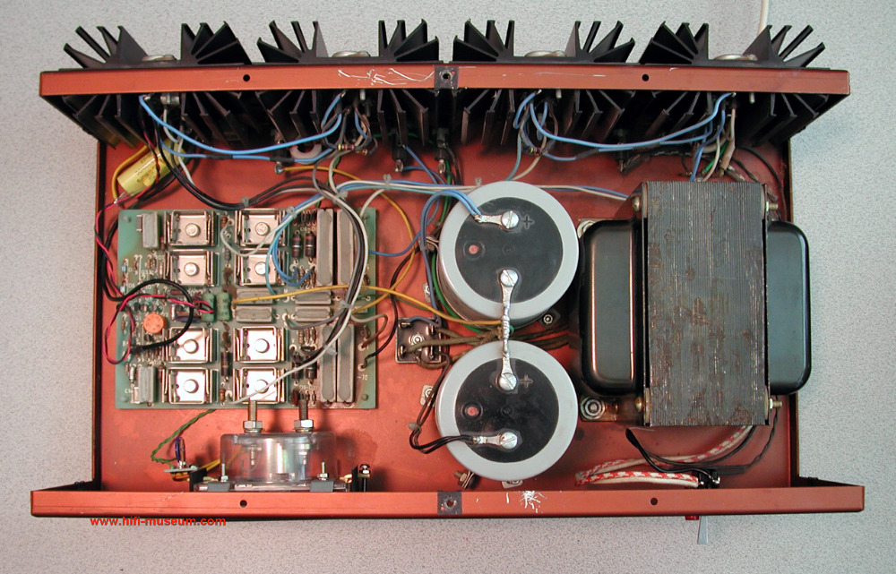

This is a 200W/ch Tigersaurus that I scratch built - started the mechanical design
and power supply when I was 16 years old:

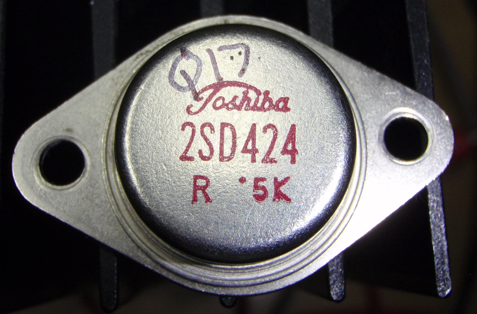

This the first in a series of posts showing pictures of the original Toshiba parts on my Adcom and the replacement 2SD424 I obtained from MCM.

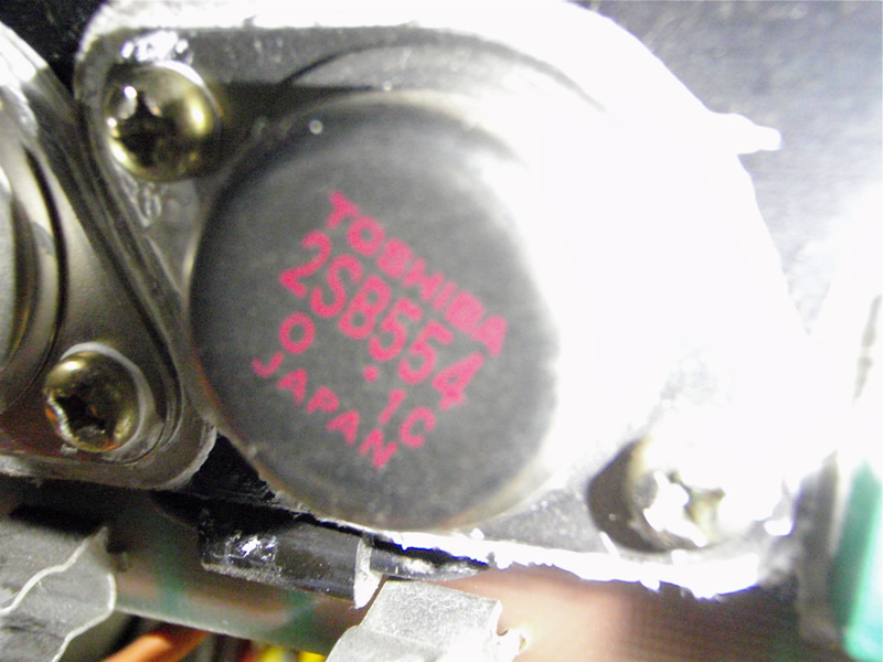

These two are of originals in my amp. Q17 is the transistor that failed. The other picture is of a transistor on the other channel. One side of this channel was obviously rebuilt at some point by the prior owner.

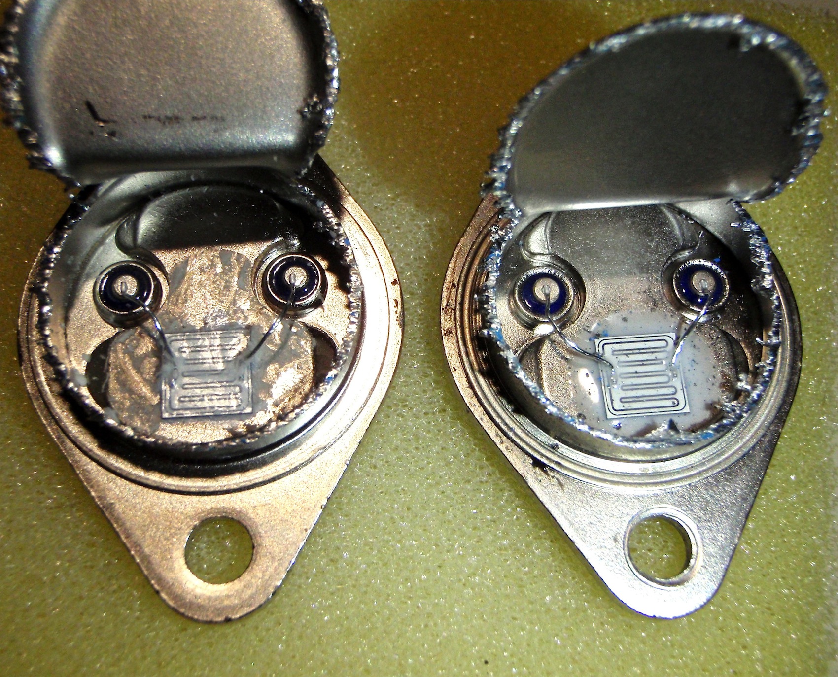

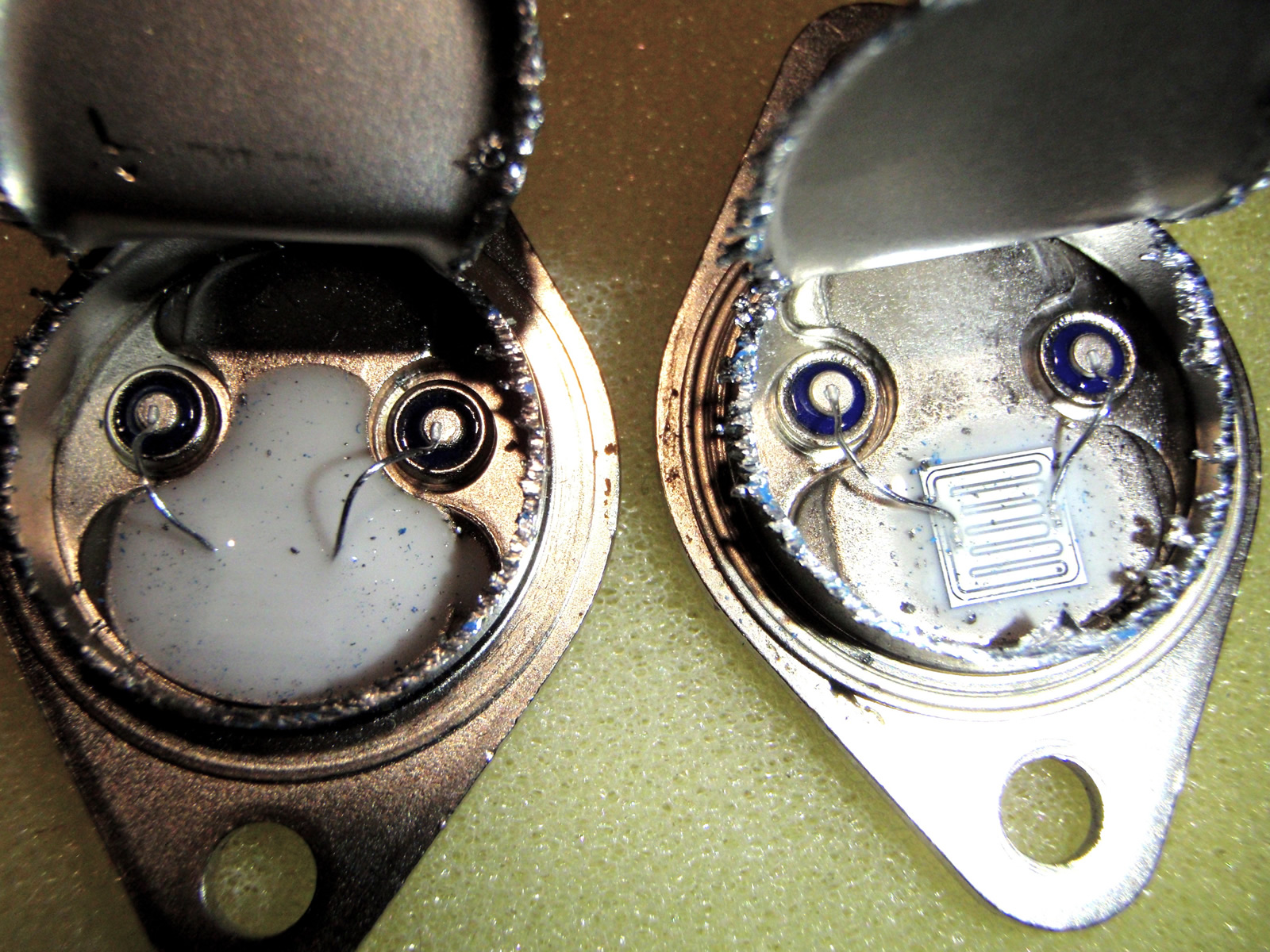

Here they are again, after I spudged off the white thermal (?) goo to reveal the die.
I should also repeat that the MCM part passed the IT-18 tests AND passed Vceo of 160vdc with 0 leakage. I'm not at all experienced, but I'd say this part is good.
What do you guys think?
Right looks like what is currently in my Adcoms.
Left looks like what I pulled out of the Soundcraftsman - probably the older style marking.
Die size and design looks just like what I have here, note that the size is about 1.5-2X what is shown for many fakes.
I'd say it is good but welcome input from others.

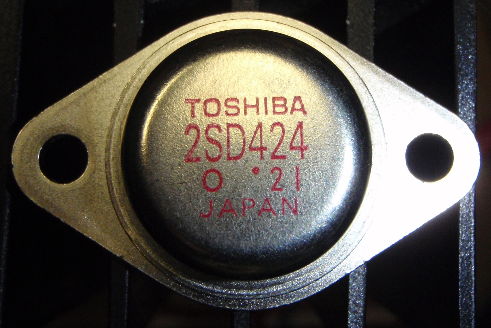

Does the beta code match your others?
Thanks for the confirmation, guys.
No. The originals are R. The MCM part is O. Interestingly, the parts list specifies O. At 50hfe, the MCM part does match the beta the of the others on the board very well.
