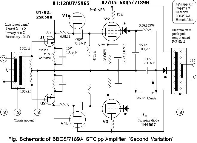

I wonder if the SYclotron topology can be used with succes in a Baby Huey variant. See this: http://www.diyaudio.com/forums/showthread.php?s=&threadid=20889&perpage=25&pagenumber=3
Jaap,
I think it probably could be used - haven't done a real analysis.
For your info - last night I pulled the original Baby Huey off the shelf and modified one channel to the cross coupled feedback to the diff amp grids circuit arrangement similar to the 6BM8 circuit you posted at post #22.
I still had to use 47K 15K 47K network off the output tube anodes to drop the feedback level (15K actually reduced to 10K), thus retaining some of the basic "Baby Huey'ish-ness" but instead of the 220K resistors back to the diff amp anodes I used 100nF cap and 4M3 in series back to the the opposite diffamp grids and the 27K grid input resistors. The 220K anode loads then went to a separate decoupled High Voltage rail (10K + 22uF from the main B+). All else remained the same. These component values were arrived at to set the sensitivity (and therefor presumably output impedance etc.) to the same as the other unmodified channel.
Still listening too it and assessing sound BUT I can say that the opinion I expressed about that circuit configuration giving a different sound is correct. Not hugely different but noticeable. Early days BUT it seems to NOT have that mid range richness and strong (exaggerated?) bottom end of the "Baby Huey", instead it seems to have more tonal balance, improved top end and possibly better detail. That suggests less 2nd harmonic distortion and possibly less higher order (3rd 5th etc.) harmonic distortions as well.
Will advise further, will probably have to do the other channel as well to assess this properly. Of course it is probably the strong 2nd harmonic distortion profile of the original Baby Huey circuit which is what people seem to like about it, getting rid of that may prove a "bad idea".
Ian
