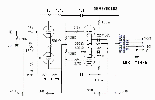

Guys,
Some more comments based upon 2 years of Baby Huey experiments and results.
If you are using that "partial" - lets call it "balanced shunt" feedback from the output tube anodes then you need that cross coupling resistor. IT does two things for you. It gives a self balancing action BUT most importantly it reduces the feedback level to something which can be managed by the diffamp. With out it you will grossly overloading the diff amp expecting it to swing just too much current.
You can think of this in 2 ways:
1) The feedback signal at the other end of that anode load resistor is anti-phase to the swing you have to develop at the anode to drive the output tube grids. These two voltages add to give you the voltage you need to develop across that anode load resistor and so that increases the amount of current you have to swing through it.
2) Another way of thinking of that is that the anti-phase voltage from the output tube anodes causes an "anti-bootstrap" effect on the value of that anode load resistor. That is 220K with 6dB of feedback applied will make that resistor look like a 110K load to the diffamp tube.
The self balancing is also important - it is my contention that everything you do to a push pull amp to improve symmetry (balance) improves the sound.
All off my experiments have shown that about 6dB is the most sonically pleasing amount of feedback - you can run more but above about 12 dB the amp ends up sounding very solid state'ish (Cold, Sterile and Boring).
The Baby Huey scheme also gives one additional benefit - since there will be a virtual earth at the centre (depending upon balance) of that cross coupling resistor it provides a consistent and low source impedance for the feedback voltage.
The feedback voltage will be divided by the anode load and the rp of the tube. So HIGH rp is indicated for the diff amp triodes. The 6BM8 (ECL82) is not as good in this respect as a 6GW8 (ECL86). This is why I used a 12AX7 in the Baby Huey.
One possible good solution to the lower rp of the 6BM8 triode is to use a cascode diffamp with jfets on the bottom and the 6BM8 triodes on top. That will give a high composite rp.
High Rg1 value for the output pentode is also indicated for the same (voltage division of the feedback) reason. The 6BM8 is good in this respect, it tolerates high values of Rg1 well.
A way to use very high (say 1 Meg) Rg1 values is to follow the lead of Lars in his circuit at post #82 and use bias servo(s). I'd be incline to use one for each tube with a common reference setting.
There is another thing to worry about with output anode to driver anode feedback of this type (its effectively output tube anode to output tube grid as far as AC is concerned). The feedback resistor (which is the diffamp anode load) is effectively (AC wise) in parallel with the Miller Capcitance of the Output tube. That puts a definite upper limit on the size of that resistor. Go to high in value and you loose high frequencies. That upper limit will be much lower with the output tube in Triode Mode (since Miller Capacitance is higher).
The way to cope with that is to insert a MOSFET source follower, on each side, AC coupled from the diffamp grids and direct coupled to the output tube grids with fixed bias applied at the mosfet gate.
I haven't done a full SLCF treatment BUT I did change the MOSFEt Source follower to have a current source load. That (as AW says) gave a real lift in performance so I tend to believe that adding the boostrap top device (to complete the SLCF treatment by putting the follower into constant voltage mode) would also be of benefit.
Playing with all of these things over several years has lead to the Baby Huey circuits posted on its thread.
Do I think you can KILL the Baby Huey - you bet
Do I think anything posted so far is going to do it - No Way, but there is certainly food for though amongst those posts and a few of them may well lead to a Huey Killer.
I can add some more "general rabitting" about diffamp balance and the source of distortions and stuff if you like but thought this was enough for now.

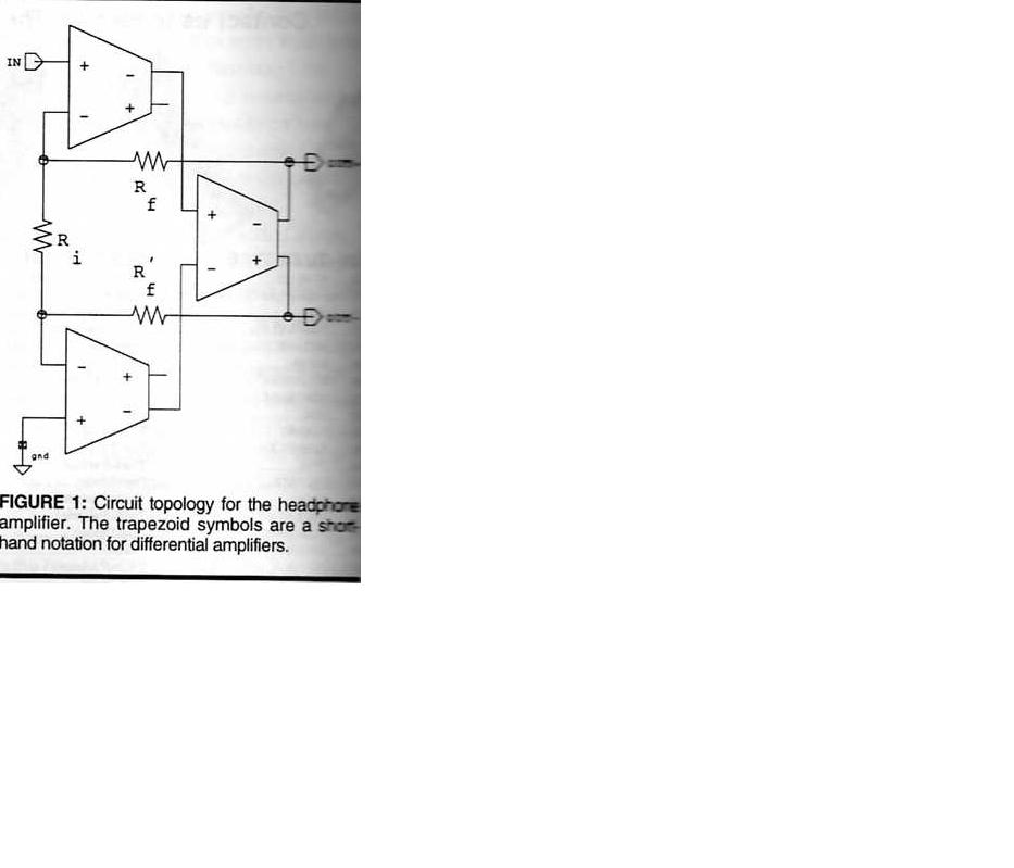

Now it is getting very interesting: the hedge circuit (with a jfet at the bottom). I tried the hedge circuit in the implementation of AW (amp with el34PP) and it sounded outstanding. Perhaps the only thing that would sound a bit better is the Tabor.
I saw an article in Glass Audio 1994-2 (author Denzil Danner) who tries to better the hedge circuit. As far as I understand he places a current source on top of the cascodes (he uses a tube) with good results. He has no CCS in the tail but uses a psu with -150 volt. At the end of the article he says: "It is cheating, but a transistor current source for the differential amp cathode impedance avoids a lot of trouble and expense. FET current sources (on top) are also a possibility".
Another interesting article is from Scott Reynolds in Glass Audio 1996-8. He presents an differential amp for electret headphones with an interesting topology (see picture).
I think it resembles the baby huey in the feedback arrangment. The first gainblocks (12ax7) are in his design no cascodes but LTP's with again a negative powersupply (-275 volt).
If you change that to cascodes and you change the last gainblock (original 6sn7GTB) to a mosfet source follower you have the proposal of Gingertube (?).
Great post Ian,
I knew this cross coupled "balanced shunt" Resistor had a significant role in the Baby Huey but couldn't have explained the details as you have.
So does it simulate accurately? Because someone here decided to drop this R as it raised the THD, AFAIR.
Maybe your post will encourage more investigation into this particular aspect! It's a pity that this thread got sidetracked & didn't pick up on your leads.
Ian, you suggested that Jaaps schematic in post #22 showing a different cross coupling (attached) could reduced odd-order harmonics - a useful attribute in a PP amp. I don't see the plate to plate feedback here - I guess there doesn't have to be one but can you explain more?

Hmmm. Does that the cathode resistor perform all the roles that the "balanced shunt" resistor does?
Shoog said:The ground reference can come from the driver stage cathode resistor, and this takes the place of the cross coupling resistor.
AC ground (in the middle of the cross resistor), for reference by
the Schade partial feedback network. Equally as valid as a real
DC ground for this purpose. Same exact thing as seen by the
driver stage cathode resistors, only different...
This design might appear to break from local feedback, and take
the GNF approach backward two stages. But coupling between
stages is DC, so they behave almost like one. And the feedback
loop wraps around only one reactive phase shift. Other than
what wires might pick up, its still very "local-ish".
So could the Baby Huey be realised with a cathode R & Plate to Plate feedback? Would this cathode R provide a "balanced shunt"? Of course would have to drop the input CCS on the cathodes.
