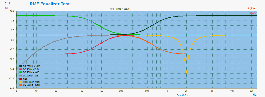

1) please describe your "20-20k Hz sweep"
Where do you get it from?
How long does it take to sweep end to end?
2) you are using a *linear* frequency scale which is useless, you need a logarithmic sweep.
The curves you're familiar with seeing are log-log, and that's really a good idea for your current project.
All good fortune,
Chris
All good fortune,
Chris
Build a sound card interface (to avoid overloading the line input) and use something like RMAA.. properly set up, it can give very accurate results (even with onboard sound)
You can use a loopback cable (line out to line in) to get baseline measurements of how good your soundcard is too

On slow sweep the output seems to be reasonably constant....
May start using my FFR (Fast Freq. Response) Test Bench what is much faster than a sweep. Requires a ADC/DAC using same master clock... 😀
