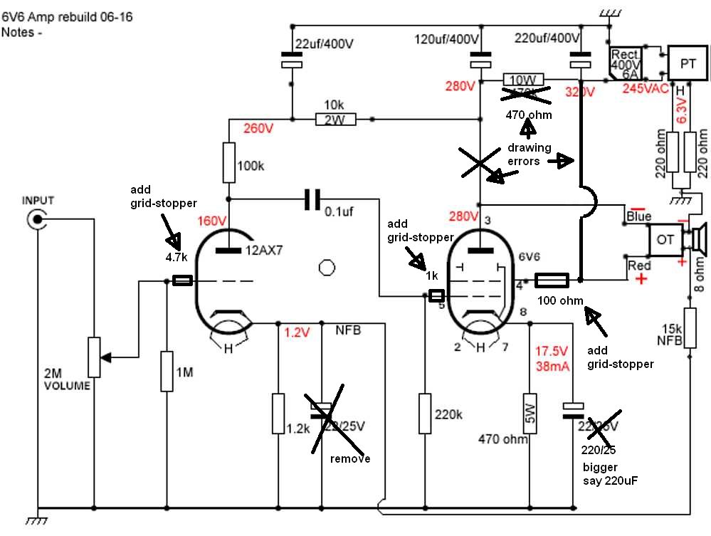

Could someone look over my schema?

I'm not a toob expert, but with high output at such a low frequency, my guess is the output transformer is saturating. "Normal" music usually doesn't go below 40Hz, which happens to be the lowest note on an electric bass guitar.
Details of the actual O/P transformer ratings, the anode/plate voltage and other circuit details would help to indicate a problem area. Trying to squeeze 6 watts out of a 6V6 bottle even with a brand new one, is pushing things a bit. Allowing for a gapped SE O/P transformer to operate 'cleanly' at 30 Hz involves a massive core and even so total distortion (without feedback) would be in excess of 12%.
with the wild assumption that the speaker can go there coherently
O.K. Moving the post titled ''30 Hz distortion'' to this section allows more background relating to the problem . It appears that 6V6dude needs to improve his knowledge of circuit design and the differences defining Hi Fi amplifiers vs basic amplifiers.The O/P transformer is a critical component that will determine the overall performance that can be obtained. Without knowing the specifications of the item used and then following a perusal of the original schematic with its plethora of basic mistakes and the retractions that follow, is a cause for concern. Changing secondary tappings won't help much, as the inductance has to suit the primary load impedance and the desired low frequency response.

6V6 SE is not h-fi.
My other amp which is PP amp handles the 30hz fine.
That is because PP allows a reasonable size OPT to have enough inductance to go down to low frequencies. SE can't do this without using a huge OPT. Also, PP is likely to have more power - needed for the typical loudspeaker/room and person to hear 30Hz.
Ok so possible amp design problem. I've build this amp years ego, at the time I knew even less than now. I'll go over it and see what I did. One thing I'm remember is that the B+ is only around 250V, maybe falling 50V short of the 300V to get enough power for the 6V6 PP? As it is now it is louder than my other SE 6V6 at 280V but starts distorting at about the same loudness level.
Are you still having the B+ connected to g2?
Jan
No Jan, B+ is fine it was a schematic error. The ams are fine now only the 30hz saturation was something I wondered about. As VaNarn and DF96 mentioned it sounds like an OT is not big enough. These are OTs from an old stereo amp (Trio and some other one), possibly not made to handle 30hz and bellow too well. Listening to "normal" music, I never come across this saturation anyway so it's not a problem. I thought (hoped) maybe the saturation in that range could be caused by something else but it makes sense it's probably the OTs afterall.
