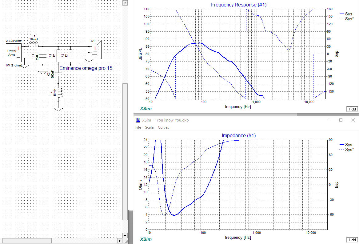

Experimenting passively
I second Pano's thinking. We have not turned to the soft side yet. Ha ha ha.

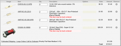

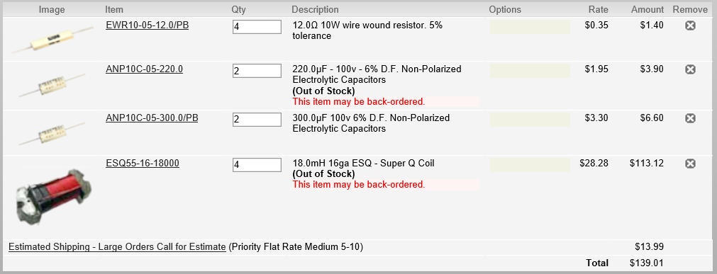

I'd have to study the sattelites more seriously to come up with a HP suggestion. This is a sim of the optima 15 in 100 litres vented, tuned to 40 Hz. Second IMP peak is flattened through RLC. The last graph is how it would have looked without one. Large inductance low pass coil is effectively reducing SPL so we'd not need to turn the woofer further down to meet the rest of the gear.
