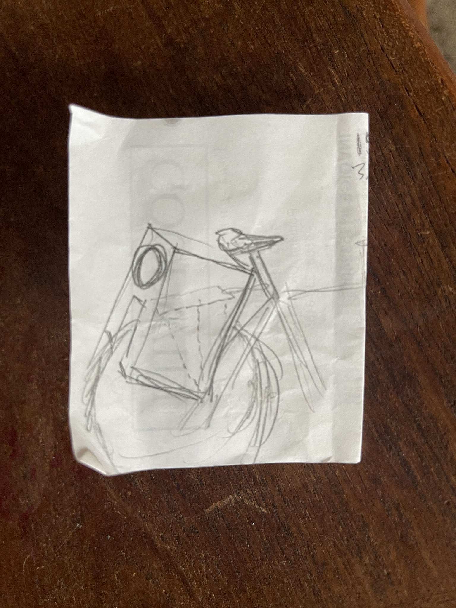

I am a furniture builder by trade, the cabinet construction is easy for me. Could you see a 6th order bypass being worked into a box shaped somewhat like this? (the speaker is drawn in as a conventional sealed box) And could I find a DVC driver for the design, or perhaps a mono class-d amp with some step-up? I intent to carefully build the box with internal stiffing supports to keep the walls from playing. The box can be as wide as it needs to be to make the proper volume. and I can tie the bottom of the box to the wheel axle.
I found this online... maybe I'm getting a bit over my head.opposing drivers likely isobaric.

6th order bandpass boxes can be fickle beasts. They come in two flavors, parallel-tuned and series-tuned. A parallel-tuned box is like two ported boxes with the sub sitting between them, both chambers are ported to the outside. These are the easier of the two styles to get right and you can simulate them in WinISD. A series-tuned box is like one ported box inside of another, only the front chamber is ported to the outside. These cannot be simulated in WinISD, but can be with other software like BassBoxPro or HornResp.
You will see guidelines floating around the Internet on how to design 6th order bandpass boxes, they will tell you things like what "ratio" to use and how much port area you need. My personal opinion is that you do NOT trust those recommendations. They are oversimplifications and as such they may not always be wrong, but they certainly are not always right. 6th order bandpass boxes are a lot more complicated than a regular ported box (especially series-tuned) and require more than a casual attempt to understand them if you want to come up with something that performs well.

I think you're heading in the right direction with the "Stonehenge" box design, maximising volume and attempting to get some weight low. I'd take the same approach if focusing on a single purpose bike-specific design.
You could use two 10" drivers, one on each side mounted low... or even four 8" drivers, two each side mounted low or diagonally offset.
At this point I'd suggest stepping back and considering the system holistically (including cost!) - the output of your chosen amp will inform the best approach for driver configuration.
If using a two channel amp that can drive a 2ohm load per channel, you could go for the 8 smaller drivers at 4ohm each. Or a single channel amp might only want to be loaded with two larger drivers.
Weltersys mentioned voltage swing earlier, and matching the amp to driver makes sense - tuning the system so you hit the driver's mechanical limit at the same time the amp hits it's maximum output voltage.
One last thing - do you have any parts on hand now you wish to repurpose, or is this all starting from scratch?

Only a slew of high end 18650 batteries that I'd be interested in using. Outside of that, I'm without parts.
If you want to use the higher frequencies from the woofer, you don't want a bandpass box.I found this online... maybe I'm getting a bit over my head.
Bandpasses are more complicated and can get finicky, but 4th order is more forgiving than the other varieties and is relatively straightforward. You still need to model it though, and make sure you're achieving something useful with the extra trouble.
If you're trying to keep things small, 4th order is typically more suitable from that aspect also.
Bandpasses can mask driver distortion, making it harder to tell when things are going south. With a 4th order and relatively low power, that should be less of a concern, but still something to be aware of.

Yes, and it won't produce much bass output.What about, two of these, as a sealed, dual opposed woofer bipole design, run from a stepped up mono class-d amp. Would that need to be 2.4cf x2?
Output is limited by "Hofmann's Iron Law": low, efficient, small, pick two.
Using sealed vs ported, you have lost 6dB low end efficiency- cover half the distance, or use four times the battery/amplification power to make up the difference. Picking a high Vas driver requires a bigger ported box.
For better output/size, look for a driver with a higher Fs and smaller Vas.
Since you are committed to low power amplifiers, the driver's excursion won't be an issue, so go for more (cheap)units, doubling the cone area gives you +3dB efficiency, equal to doubling battery/amplification power.
12", 93 dB sensitivity, 71 Hz f3 in 1.2 cubic ft sealed, 41 Hz F3 in 2.8 cubic ft ported (this can likely be fudged for a smaller box with decent bass still - if you're interested I'll run the numbers)
