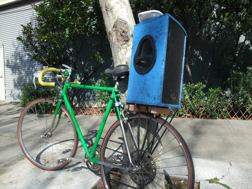

I'd start by trying a woofer I already have, a house-brand version of the Eminence Delta Pro 15", towed behind my bike on a trailer since the 3/4" plywood cabinet wouldn't fit on my rear rack. It's very sensitive, probably overkill on power handling though. Then see what cheaper smaller woofers can keep up with it at lower cost. And preferably with a neo magnet for lower weight (Eminence's Kappalite is about ten pounds lighter than the Delta Pro.) Try making a cabinet from curved 1/4" baltic birch to keep the weight down.
And keep an open mind; a bunch of small speakers with neo magnets might add up to one big woofer.
Forget using wood for the enclosure. It will end up being far too heavy, given that the sides must be flat and thick to be stiff enough.
Use two neo woofers installed in opposite ends of a Sonotube tube. (Cardboard tubing used for pouring concrete columns) This will be vastly lighter than anything made of wood, because the cardboard is loaded in tension, not bending. Mono the signal before the amplifier and drive both woofers in parallel to get the impedance lower, to get the most output from the low voltage amplifier.
