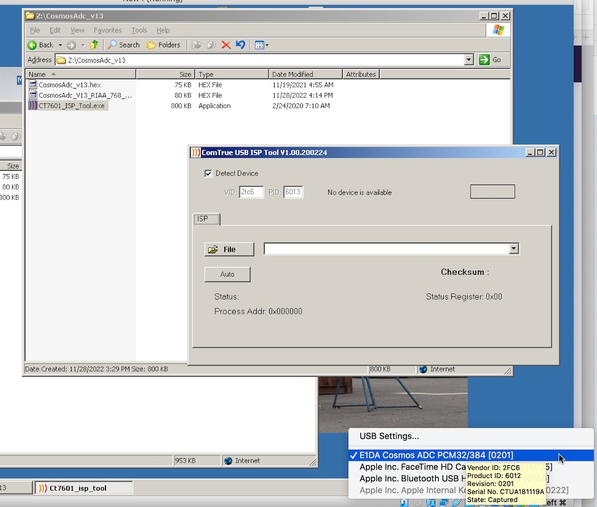

OK - I found them. My virtual PC runs NT4 - will that work?
Also with the Tweak app?

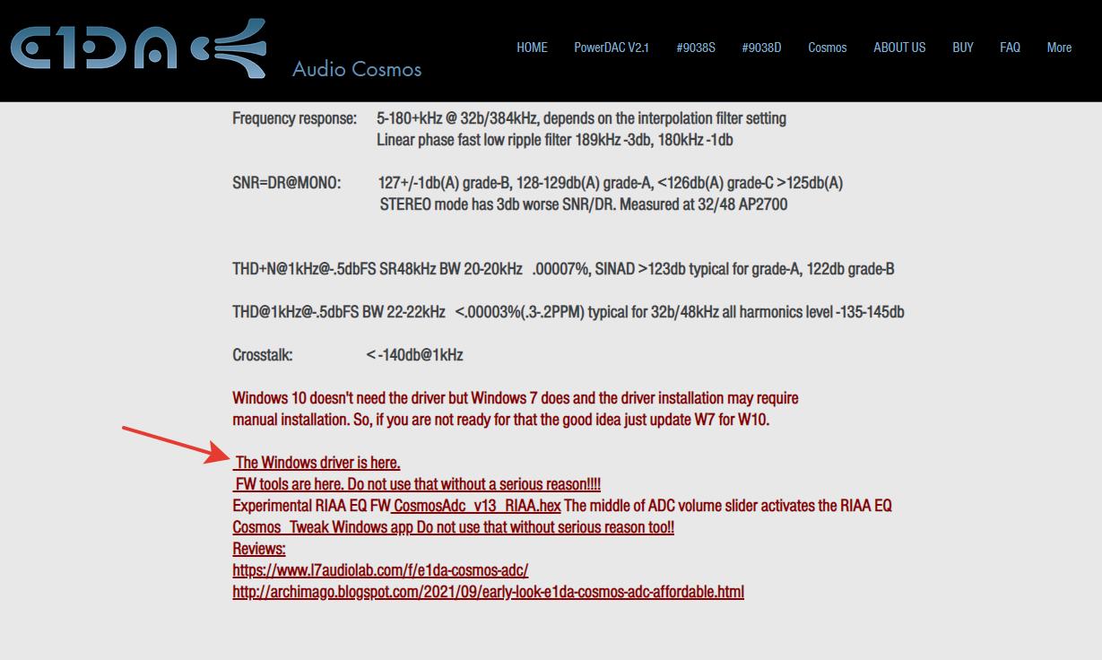

That CT7601 driver - where do I get this?
Ah, Ok, change the PID for 6012 pls. ADC has 6012, DAC 6013. And pls use a short USB cable with the USB port placed on the motherboard, not an extended port for a stable USB connection. Do not shake the cable during the reflashing process!OK - this is how far I get. USB ADC device captured by the VM... bot no contact with the Cosmos...
so, perhaps a newer Windows is needed.Unfortunately 6012 didn't fly either...
When you say "driver" is that the Comtrue USB ISP ?
In my installation of the CT7601, it comes almost to the end where it ask you to connect the USB to the "device" (Cosmos) and hit OK - when I do this and hit OK, I get a error message saying that the installer could not reach the device. When I do "Cancel" on that stage, it goes to finish and states that it was a successful installation of the driver...
Is this CT7602 needed or not?
Windows Comtrue driver https://drive.google.com/file/d/11LDzaULXWbtP1fyH6j7sp2S2SOF5ve3x/view?usp=sharing
If you can't finish Comtru driver installation, try to install their sys files by alternative way.
