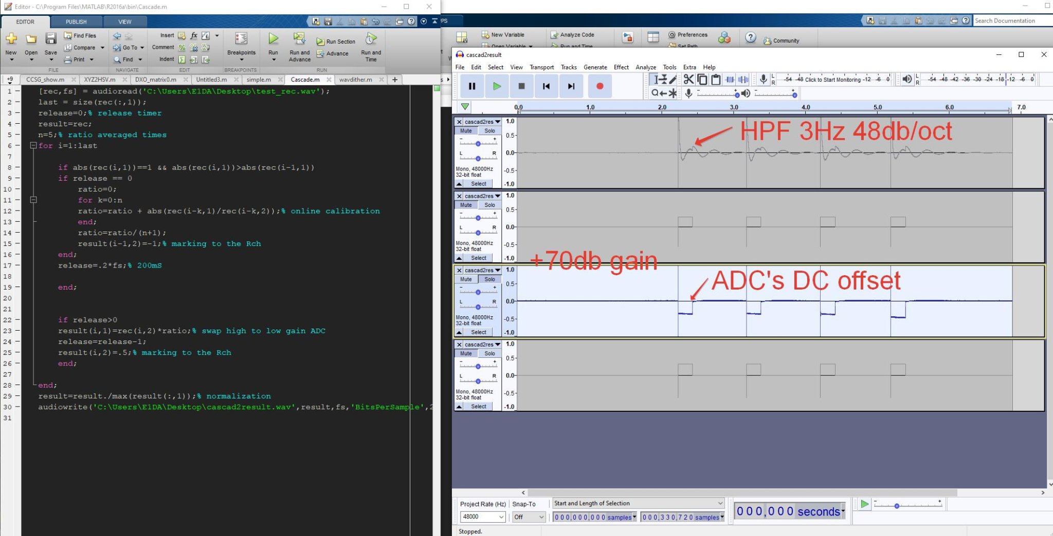

Could have been a nice standard feature in Audacity or REW. Simple but effective to keep noise down but allow for overload. (When overload is like in the example, just a fraction of the time of the recording)
For stepped measurements it is the noise that is interesting at low levels and distortion at high levels. This could solve some of this problem for one take measurements.
For DUTs with limited current drive capability, but low noise, especially.
(The cutover level don't have to be at 0dBFS for high gain channel, could be at -6 or - 20dB)

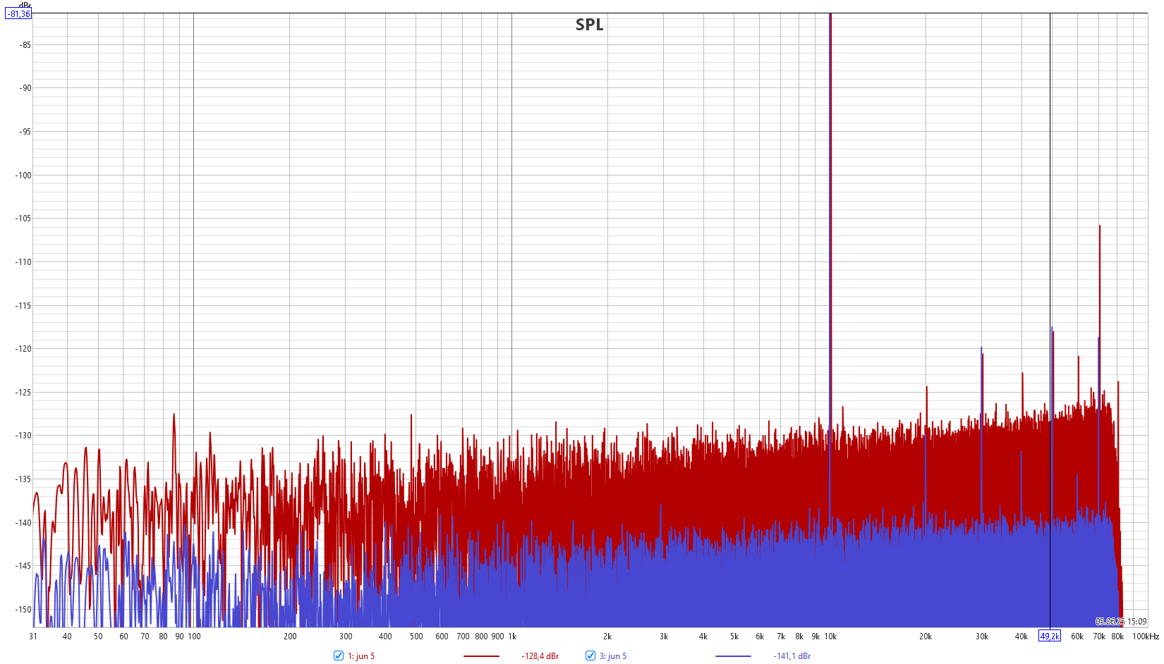

I tested that with 20KHz max amplitude for 1 ms every 1-second of the periodical burst to see if I could notice switching artifacts - nothing even after amplifying for 50db.
BTW, it seems Matlab audiowrite function adds 16bit dither, perhaps that noise masks some clicks.

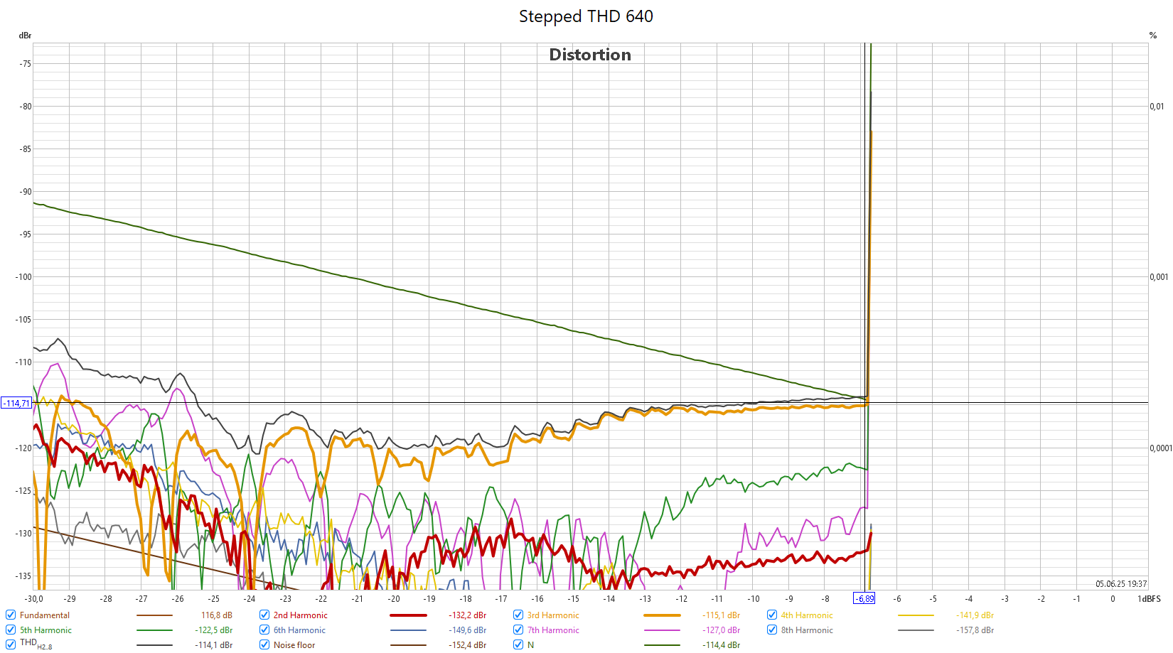

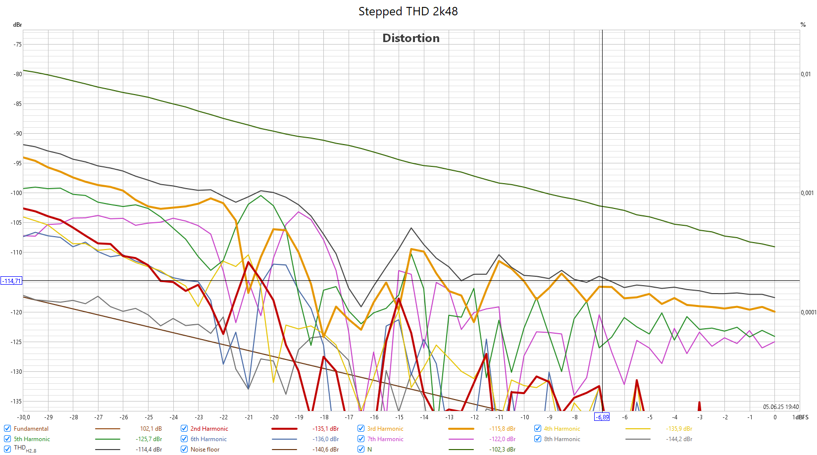

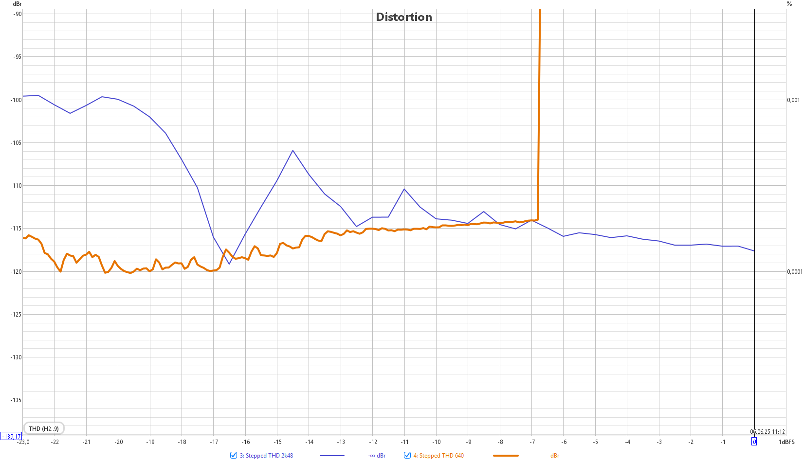

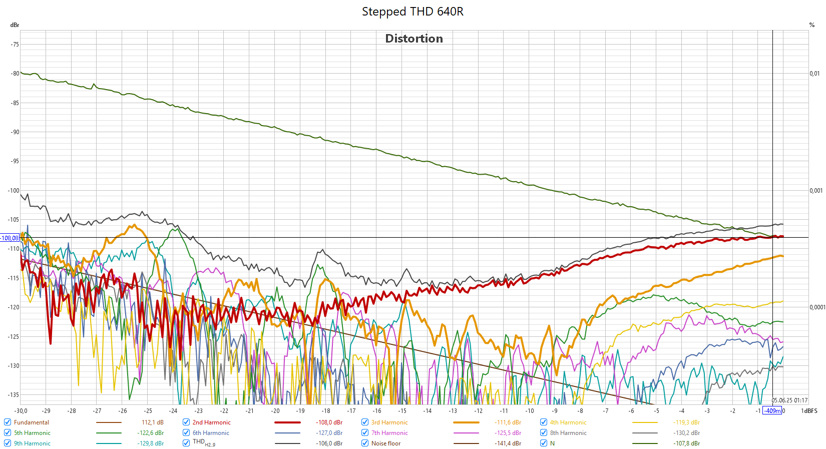

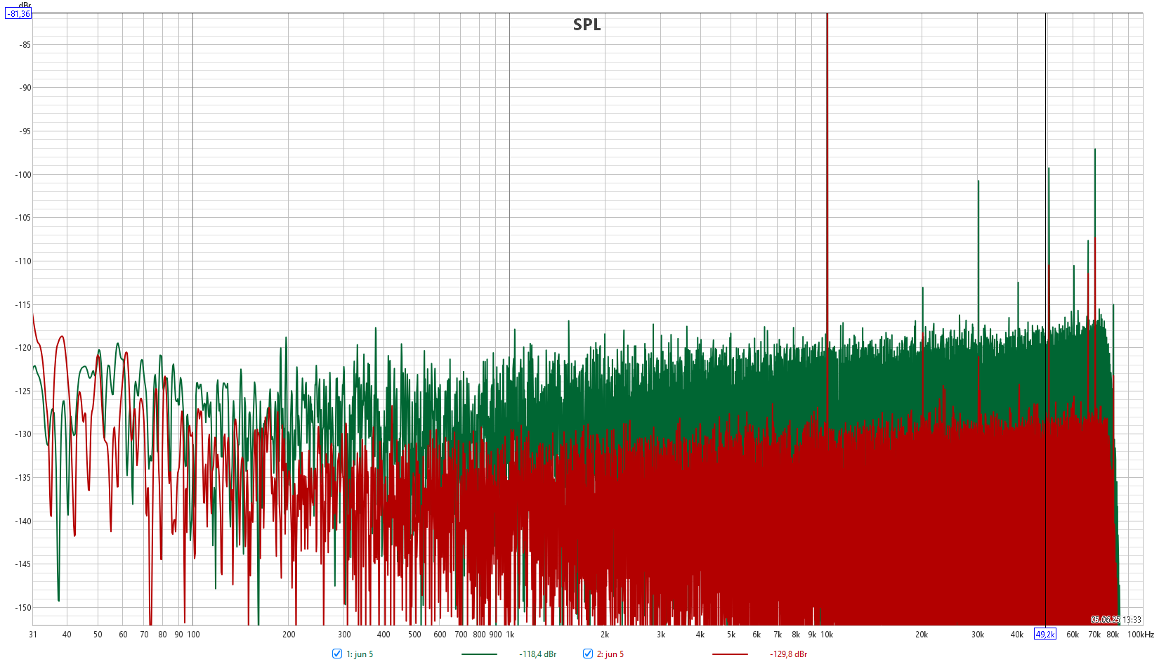

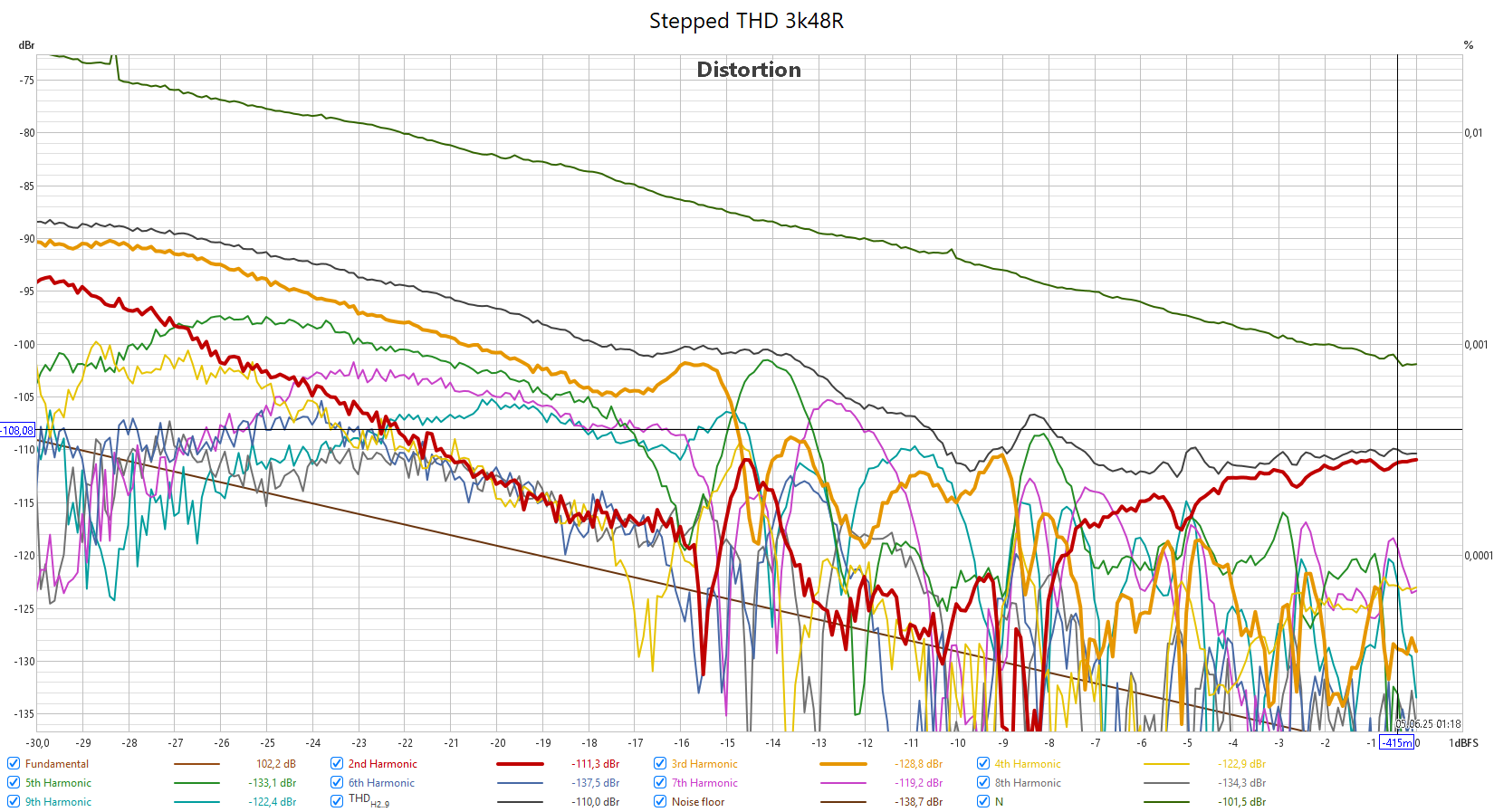

This real world nonperfect 4 series "cheap" opamp measurements illustrates some of the measurement dilemma

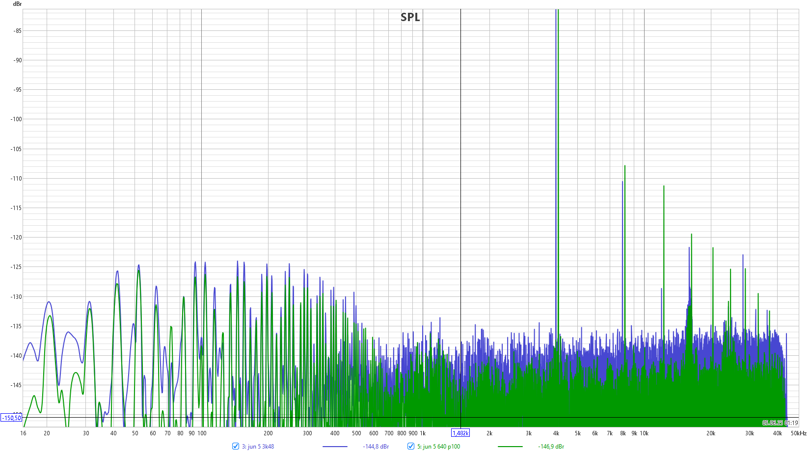

640R gives low noise but can be overloaded and loads the cirquit so odd harmonics rise.
3k48 has higher measurement noise, but the loading is less. So more real harmonics for normal loading.
At low level I want to se the noise. At high level i dont want signal overload and I dont want excessive loading of circuit.
I have added 100Hz in one of the FFT plots for clarity.
4000Hz test tone at max about -3dBFS (640) and -13dBFS (3k48)

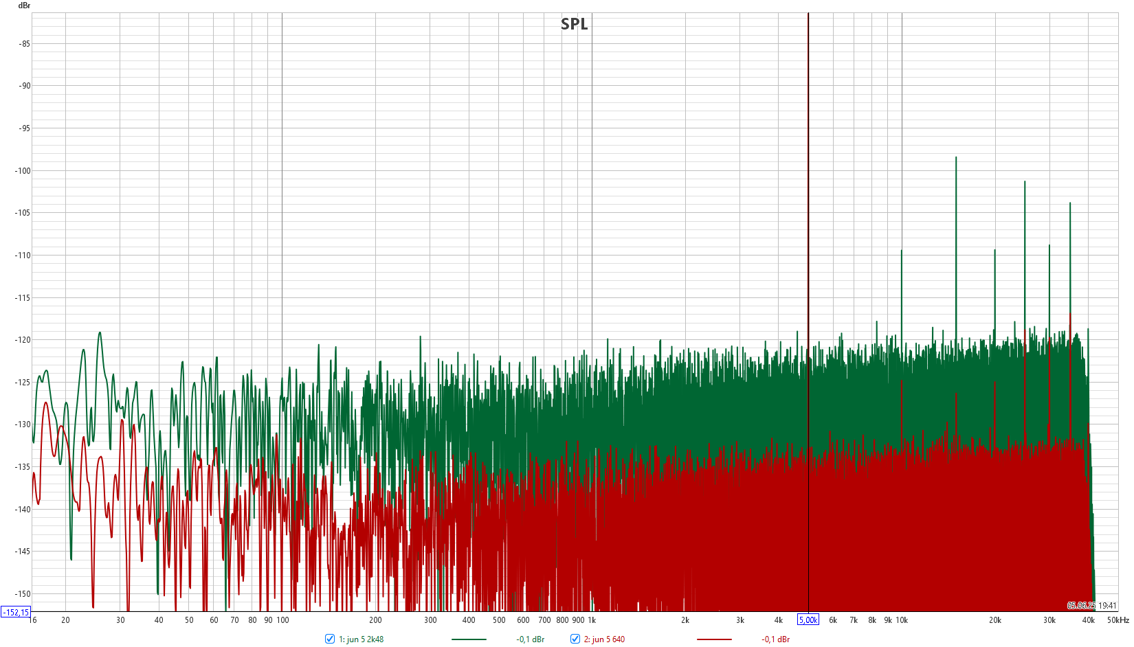

(Single ended with poorly regulated switchmode supply)
Hm, thought the harmonics would be lower with higher input impedance at low outut volume, but no.
Single ended. 640 ohm red, 3K48 green
ESS..39 dac, just 1 single ended part of differential out into ADCiso
So then the input impedance for the ADCiso input amps is to high for lowest THD? Ref https://audioxpress.com/article/modern-op-amp-distortion-tests-part-1-bjt-input-devices
