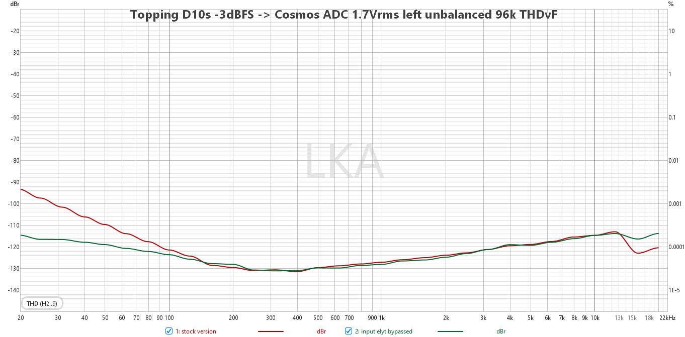

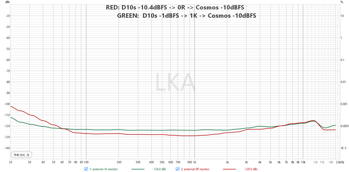

Another THD test. The capacitors are not bypassed !
GREEN trace: inserted 1k resistor (small black box on the picture) between D10s and Cosmos
RED trace: direct connection
The output level of the D10s is chosen so that the input level of the Cosmos is -10dBFS in both cases. ( 0dBFS = 1.7Vrms)
It is clearly visible that additional series resistor helps.
I think this may be what I was suggesting before. The distortion changes with software set output level from the D10s.
The 1K resistor may also be making the load impedance more friendly for the D10s output amplifiers.
Certainly your test shows that there's different results from the DAC when there's no changes to the ADC side.

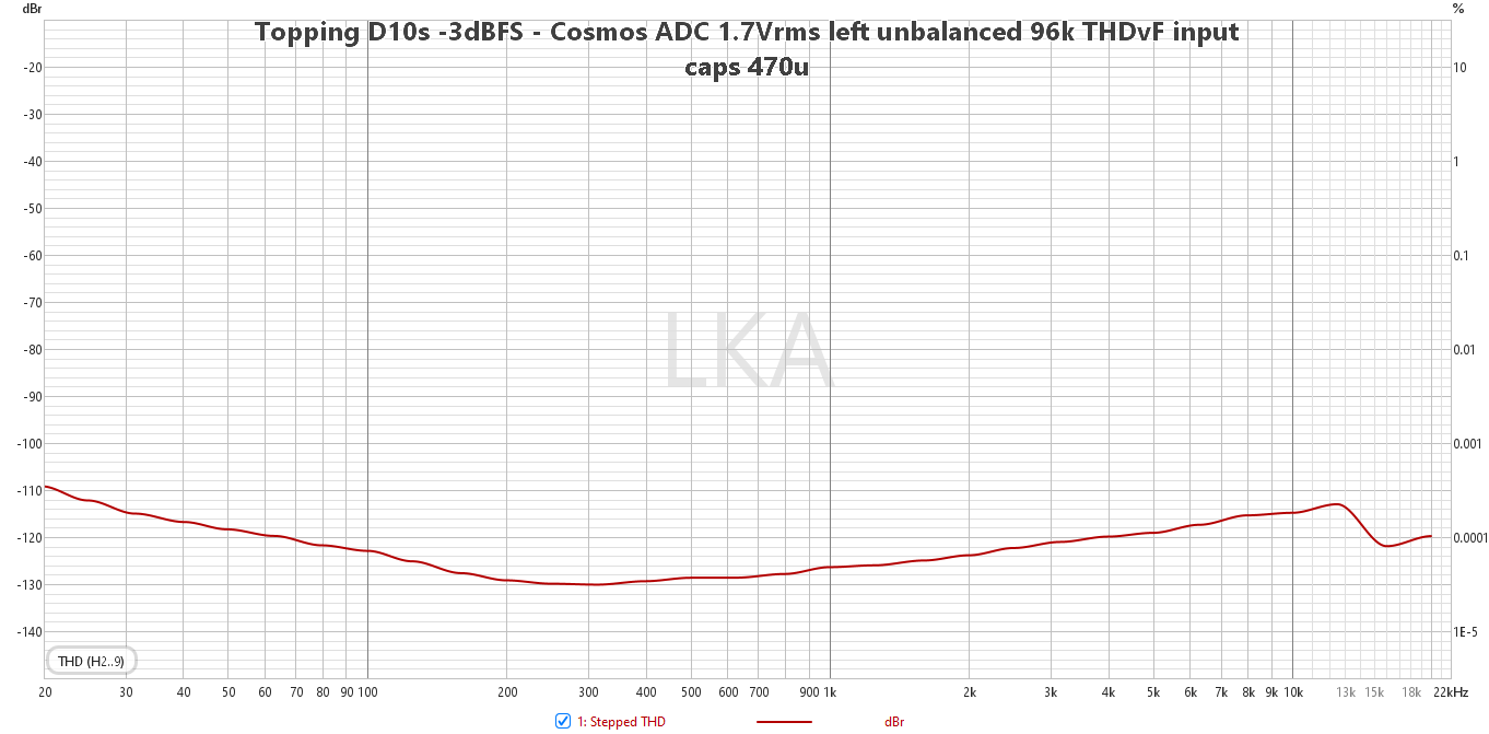

You are wrong. Capacitor size matters. 220u and 320R (1.7Vrms range) is not enough for LF, that is all.
I changed 220uF/10V to 470uF/10V (I used damn jamicon, because I don't have anything else at home)
Now I have much better numbers at LF. 1000uF will be the final.
stock caps and bypassed

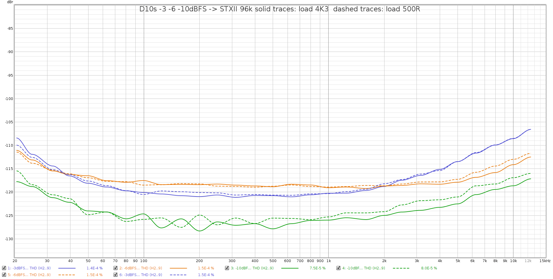

New measurements. D10s -> STXII
DAC Topping D10s, output impedance = 20R, 0dBFS = 2Vrms
ADC STXII, input impedance = 4K3, 0dBFS = 2Vrms
Dashed traces = additional 500R load on the DAC output.
All 20-50Hz THDs are better than Cosmos with 220uF input caps

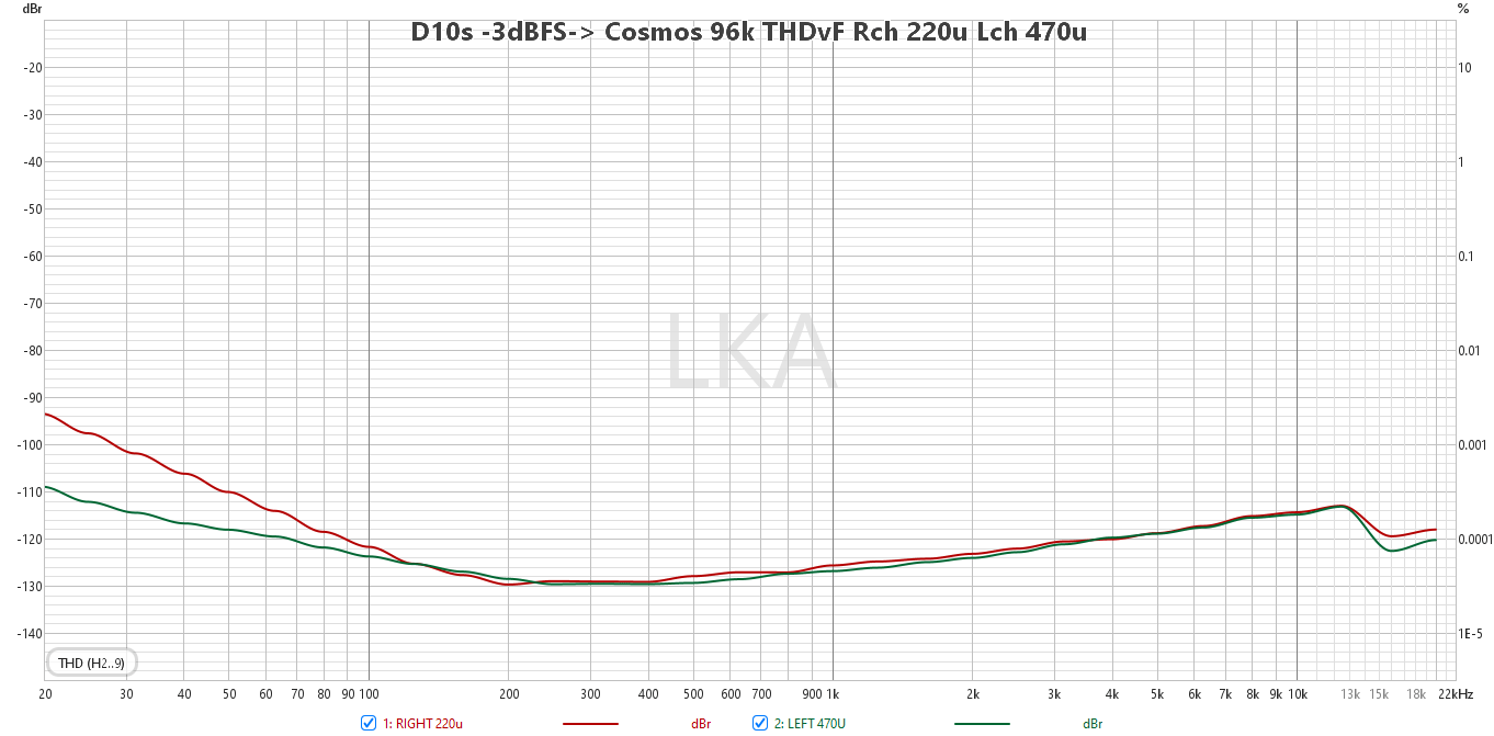

Last comparison. Cosmos Rch with 220u/10v and Lch with 470u/10v super coupling capacitor Jamicon. (the price is also amazing, just 0.11euro)

I told you, you have defective 220uF caps, try to replace for the same value brand new to see the same THD@20Hz. BTW, I have a few, perhaps 2-3 cases when users burned these caps by overvoltage during a poweramp testing. After caps were replaced ADC works properly.

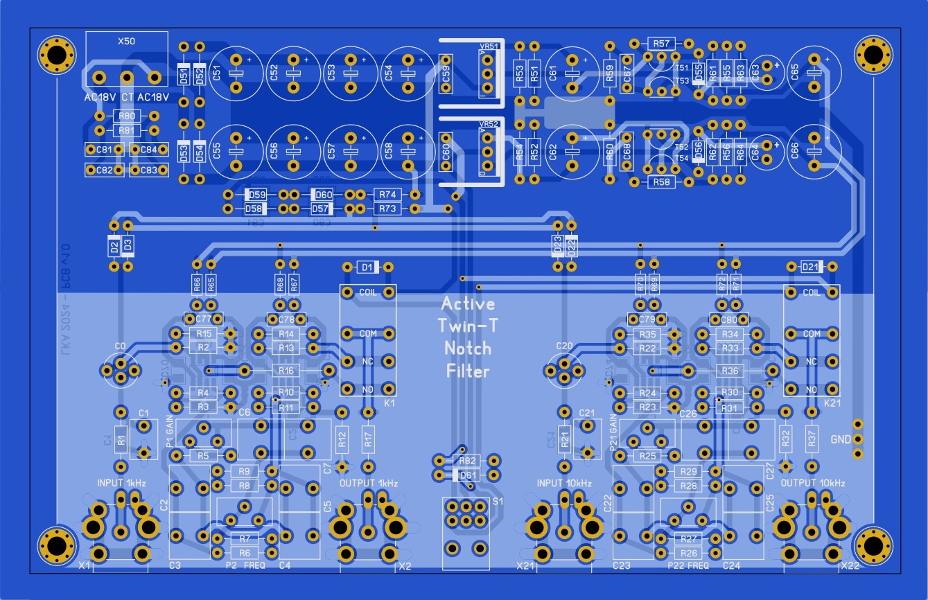

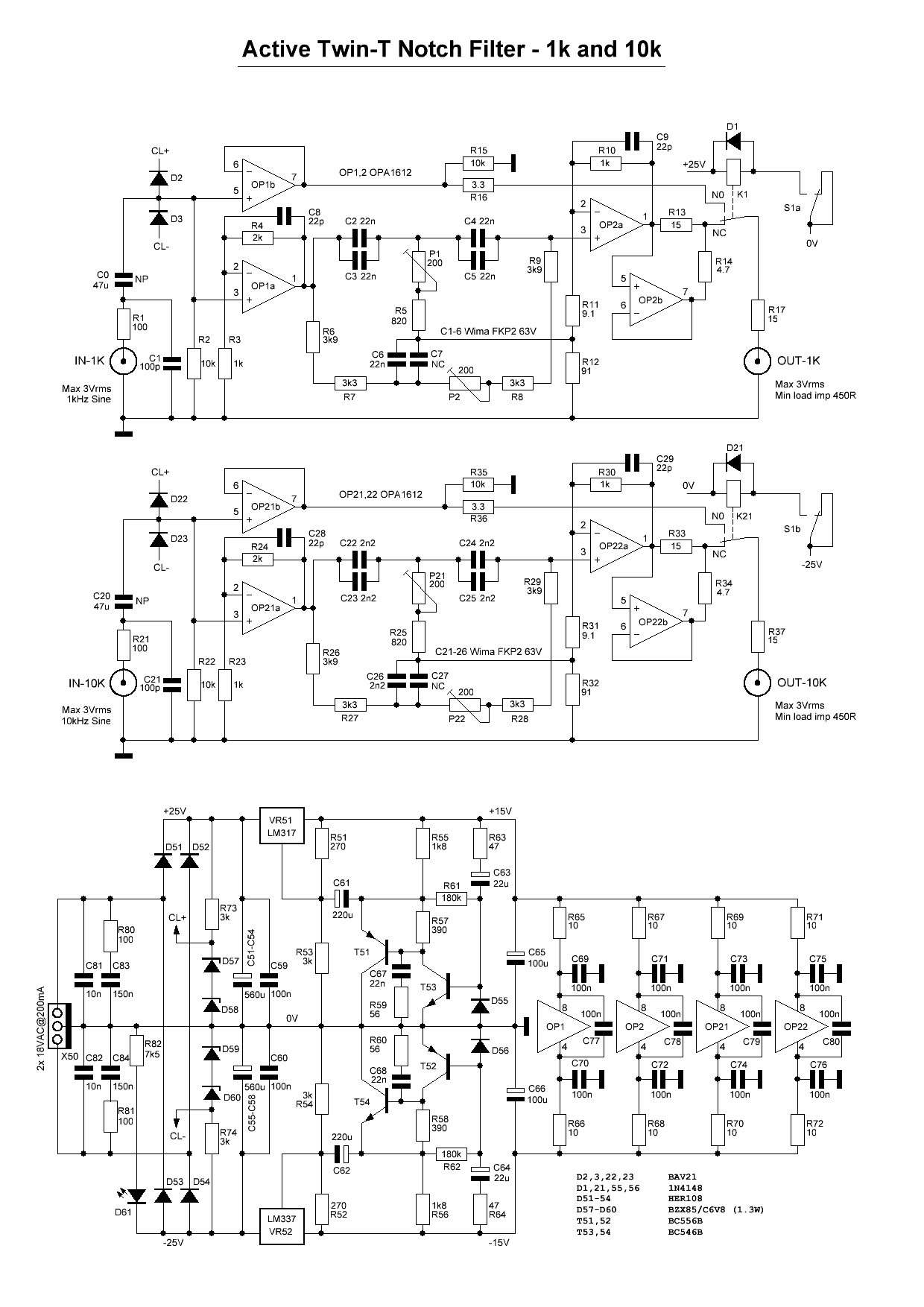

BTW, I'm preparing active notch filter for my cosmos (unbalanced, for 1.7Vrms range )
