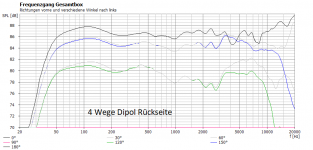

The energy radiated to the speakers back is what is needed to create a wide illusion of 3 dimensional space, to locate the actors and the instruments and to give the listener an almost holographic picture. This works very well when the sound radiated to the back is about 15dB down in level and at least 6ms delayed. Therefore it is best to have at least 1m distance to the rear wall. The dipole speaker brings no energy into the room under the angle of 90° (cos 90° = 0), so there are no loud early reflections to disturb the illusion.
The classical speaker does not very well at this point as can be seen in the simulations to the speakers back:

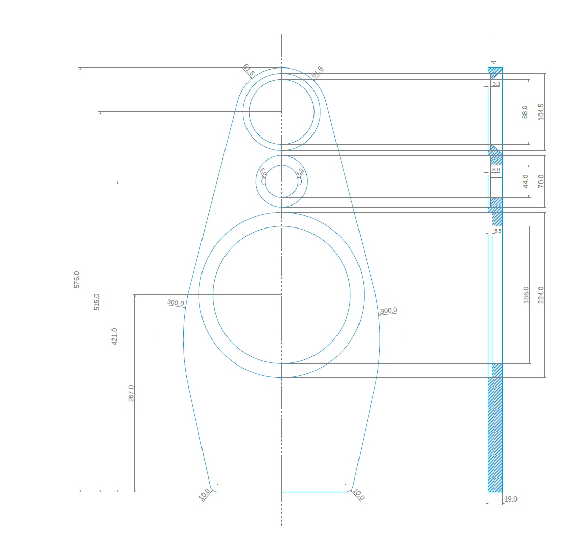

The first thing that comes to the eye is the low level at the lower end of the scale. Therefore the practical dipole is different here - at this end of the spectrum i use a "Ripol". This is a patented form of a folded dipol, invented by Axel Ridthaler. The "Ripol" promises level down to 30Hz without equalizing (or 25Hz with moderate equalizing). This kind of dipole is similar to the W-Frame dipole of Siegfried Linkwitz (that he used in his Orion-speaker as far as i remember), but with a much smaller enclosure, in a way that the air enclosed is an extra load for the speaker used here. The effect is a lower resonance frequency of the speaker when mounted. A negative side-effect of this kind of mounting is the limited frequency range that can be used as about 300Hz there is a massive resonance of the enclosure . So i use the "Ripol" to the maximum frequency of 185Hz, cut by a 24dB Linkwitz-Riley low pass.
To get the radiation of the dipole as posted in post 1 it is neccessary that the baffle is as small as possible and to limit the speaker to his natural upper end (where it starts to radiate only to the front). So it came to a 4-way speaker.
Another problem is the tweeter, only radiating in one direction. Another one mounted back to back is part of the solution. But when mounted this way, the baffle that results is much wider than the active part of the tweeter. So it is neccessary to put the crossover frequency relatively high - so that the tweeter can not see the baffles edges.
And as form follows function, the shape af the baffle that results could look like the one attached.

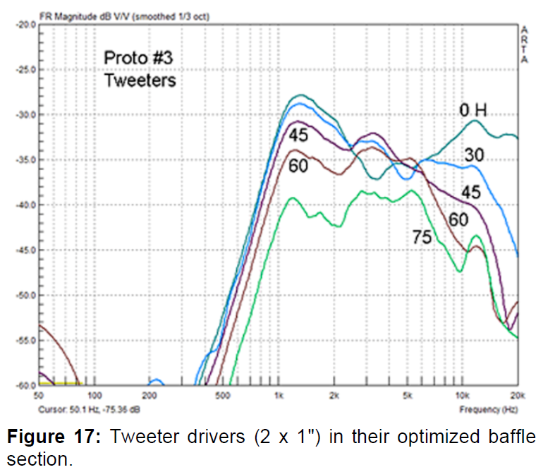

If you can get your 2 tweeter setup to look like the data in this post I will be impressed:
measurements of nude ribbons and a dome-dipole
But it will probably look more like the attached picture (this is the response of SL's LX521 tweeters). You can see why he has to cross over at 7kHz. Between 2k Hz and 6kHz the pattern is bad.
