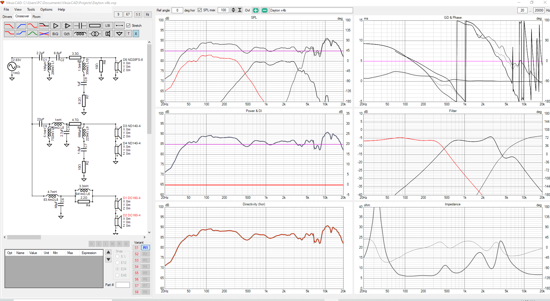

Thanks again for your responses. I tried using your values in VCAD as suggested by Don. Both Don's and Shadow's traces for the freq response came out differently although the impedance traces seem similar. Either I am making a big mistake or the software calculates results differently. Which one is correct or what am I doing wrong in VCAD.

Xsim is not inaccurate. The results should be the same for Vcad and Xsim provided the data and usage is the same.

The factory driver data (FRD, ZMA) was measured, on driver axis, using something like an IEC 286-5 test baffle. This is appropriate for a driver spec.

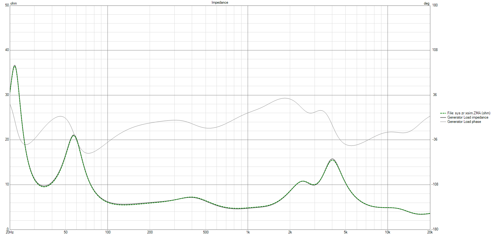

Xsim does not have ability to position the drivers. It relies on you providing the measured data from your box at your measuring position. An accurate SPL graph would require you to build a test box, then measure each driver separately at a fixed measuring position, then import that data (FRD) into Xsim. The impedance calculated by Xsim does not require driver placement, that's why only impedance matches VCAD impedance when factory driver data is used.
The XO relative electrical phase, and the driver relative positions, and the box/baffle shape will effect the SPL at the measured position. So small tweaks in the XO, or driver position may not effect the impedance, but they will effect the SPL output. The VCAD model will include these factors and be more accurate with less work.

Xsim allows you to separately set the delay. No other positioning is needed.. unless you're doing a 3D crossover.
Vcad positioning does not affect impedance or baffle diffraction. It is used for external purposes such as timing and polars.

Differences are negligible, you have to use the frd/zma files located in the directory created when you open the project I attached above.

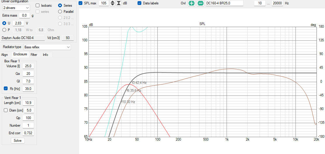

A 25L BR box with stuffing on the wall would be fine. The brown line includes the baffle step.

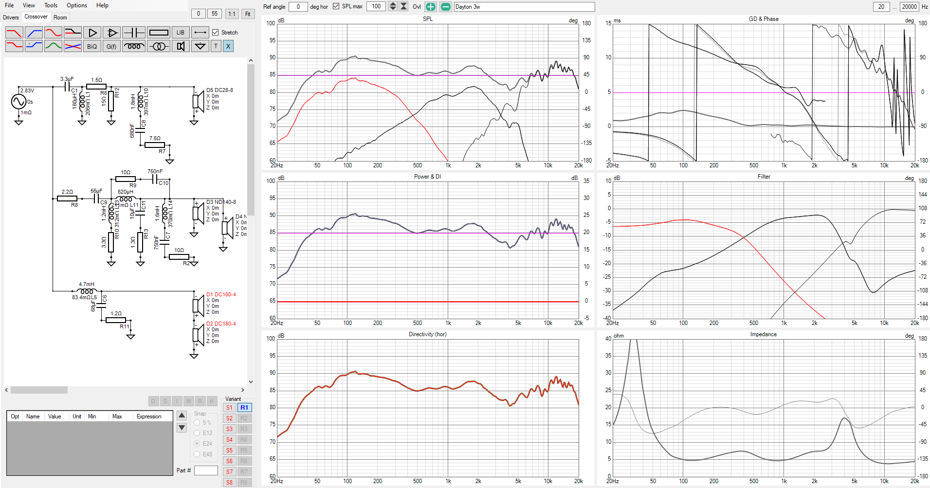

OK, I have changed the mid. The box sizes do seem more realistic. I haven't designed the box yet so not sure whether the mid will be ported. The frequency response is good until the mid/tweeter XO (I don't think my old ears will notice) and the impedance is good. Are there any more suggestions? Xsim file is attached. Thanks
Your mid-tw filter is a mess. Why do you need woofers' voltage divider?

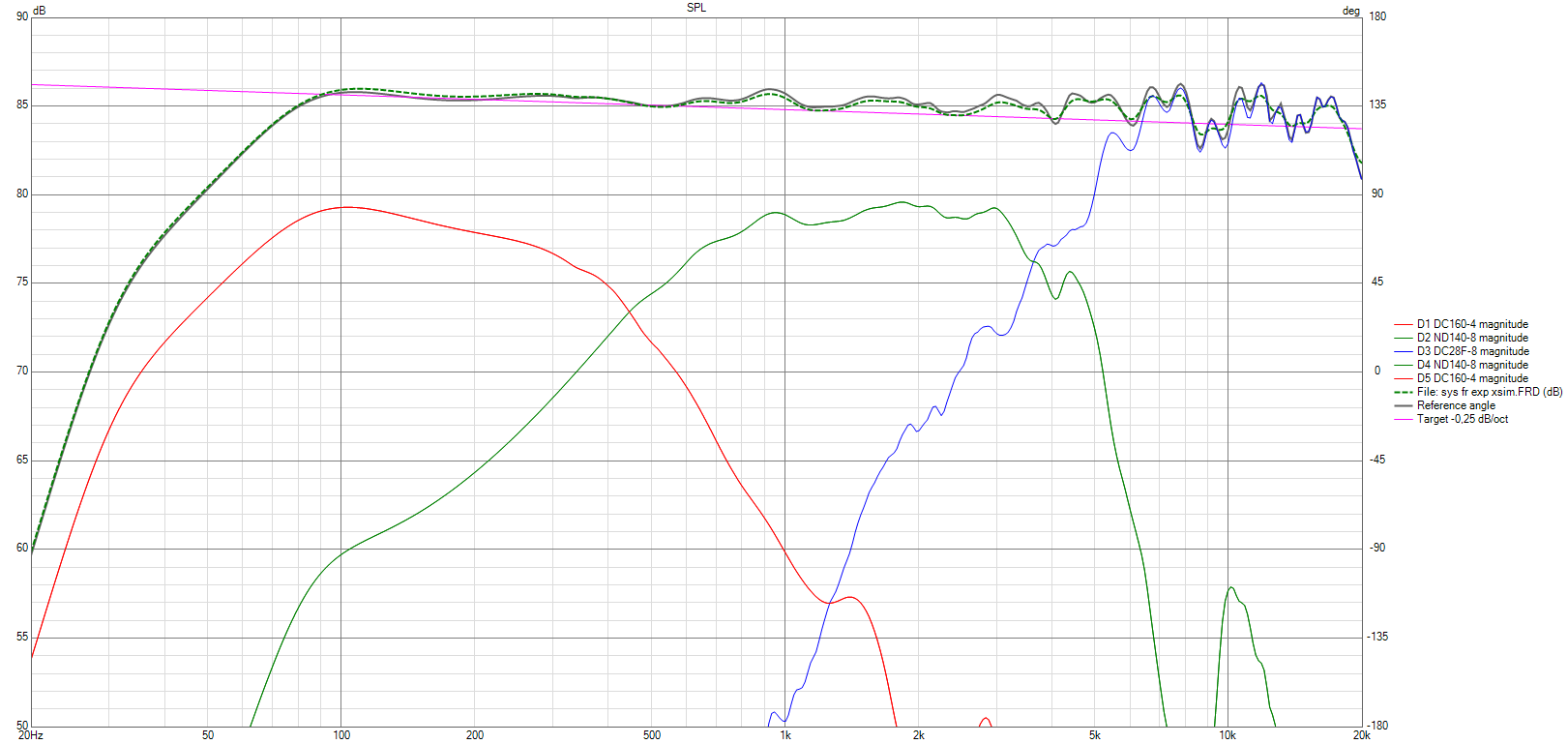

The woofer zma file in your project is that of a driver measured in free air and not in a vented box, also its frd doesn't include the baffle step loss. As the woofer configuration is the same you could use the xsim file I attached above as a starting point. Consider to apply baffle step to the mid too.

Yes, I am still trying for improvement. I thought my last effort was OK, 6 ohm impedance and flat response (until the tweeter) but you called it a mess! I am away from home for a few days. I have added the notches, BSC and zebel.

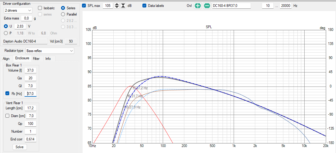

37L @37Hz Vs. 24L @39Hz (dashed blue lines). The brown line is considering the baffle step loss for a panel width of 22cm.
You loose a bit of bass extension (37Hz vs. 48Hz), but cabinet is smaller, transient and group delay are better.
