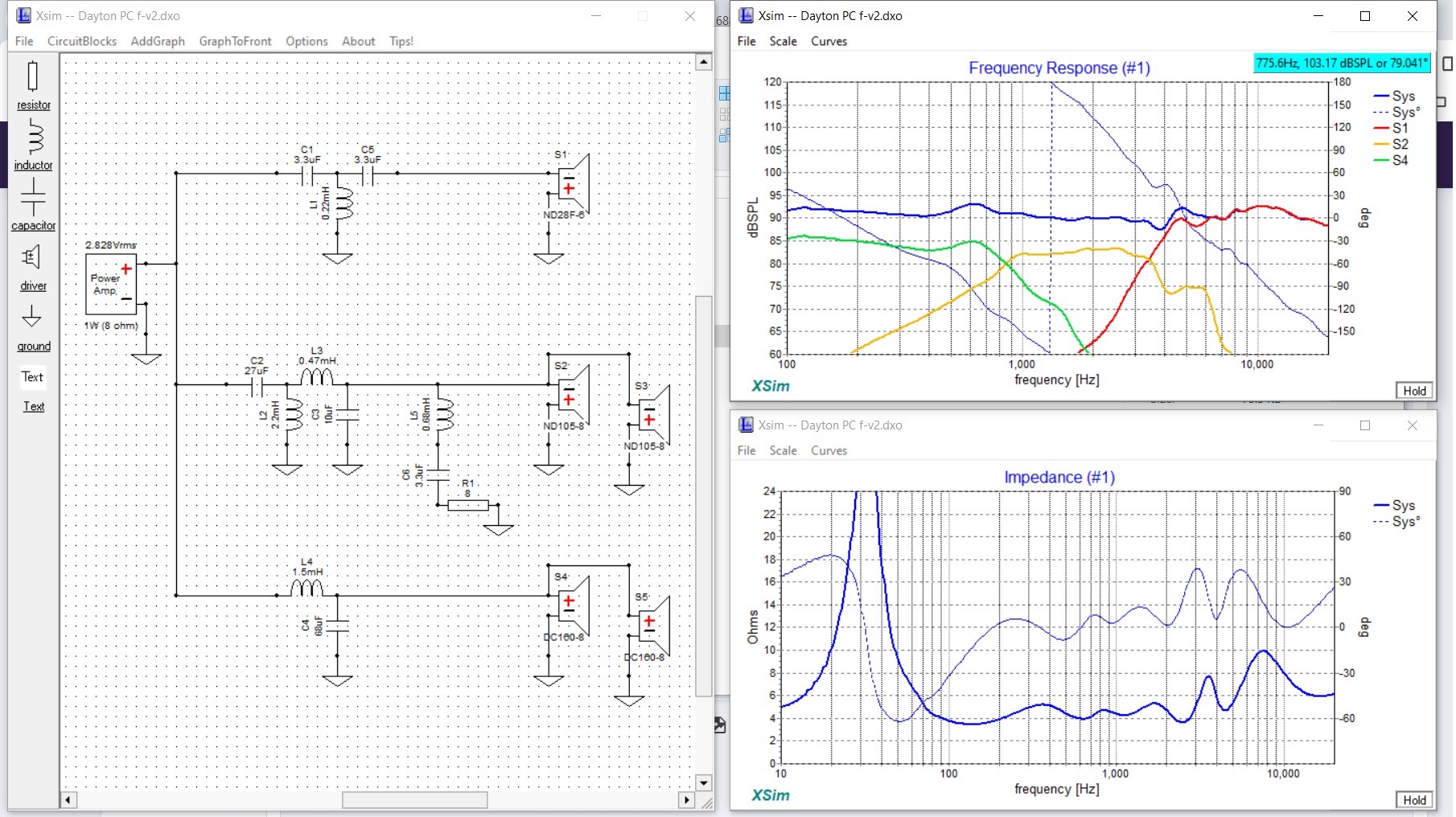

The FRD for the ND20 was not imported for 0deg, so it had some additional attn, it was updated.
The values for the XO are unusual, I've included an update (v2) with a notch for the midrange (has a FR bump) as an example. The impedance should be around 4R as you have 8R drivers in parallel.
[edit] attached a pic of the response
  • Dayton PC f-v2.dxo

My bad, I used the ND20F, that would explain the difference. The ND28F is not sensitive enough to match the dual mid and dual woofer. The ND20F recommends min XO at 3.5Khz.
I used the Akabak3 built in calculator to determine the filter component values. I used LR2 for the woofer and mid, and a BW3 for the tweeter. What calculator did you use.?

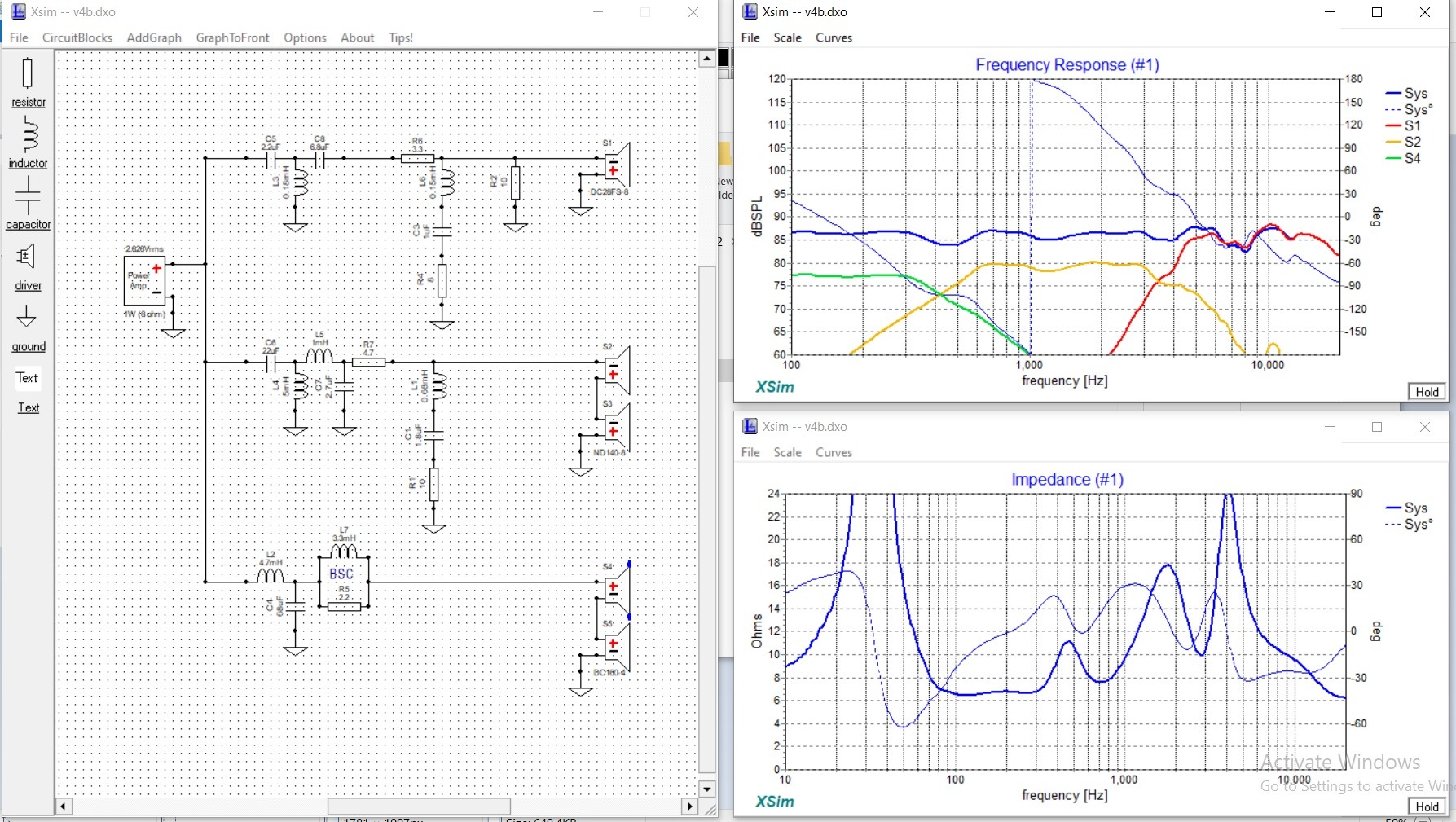

I decided to go to an 8 ohm system out of respect for my amp, NAD, it is capable of working into a 4 ohm load but I would rather have it working into 8 ohm. The files attached are the impedance with and without the crossovers.
  • Dayton PC p.dxo
  • Dayton PC p.dxo

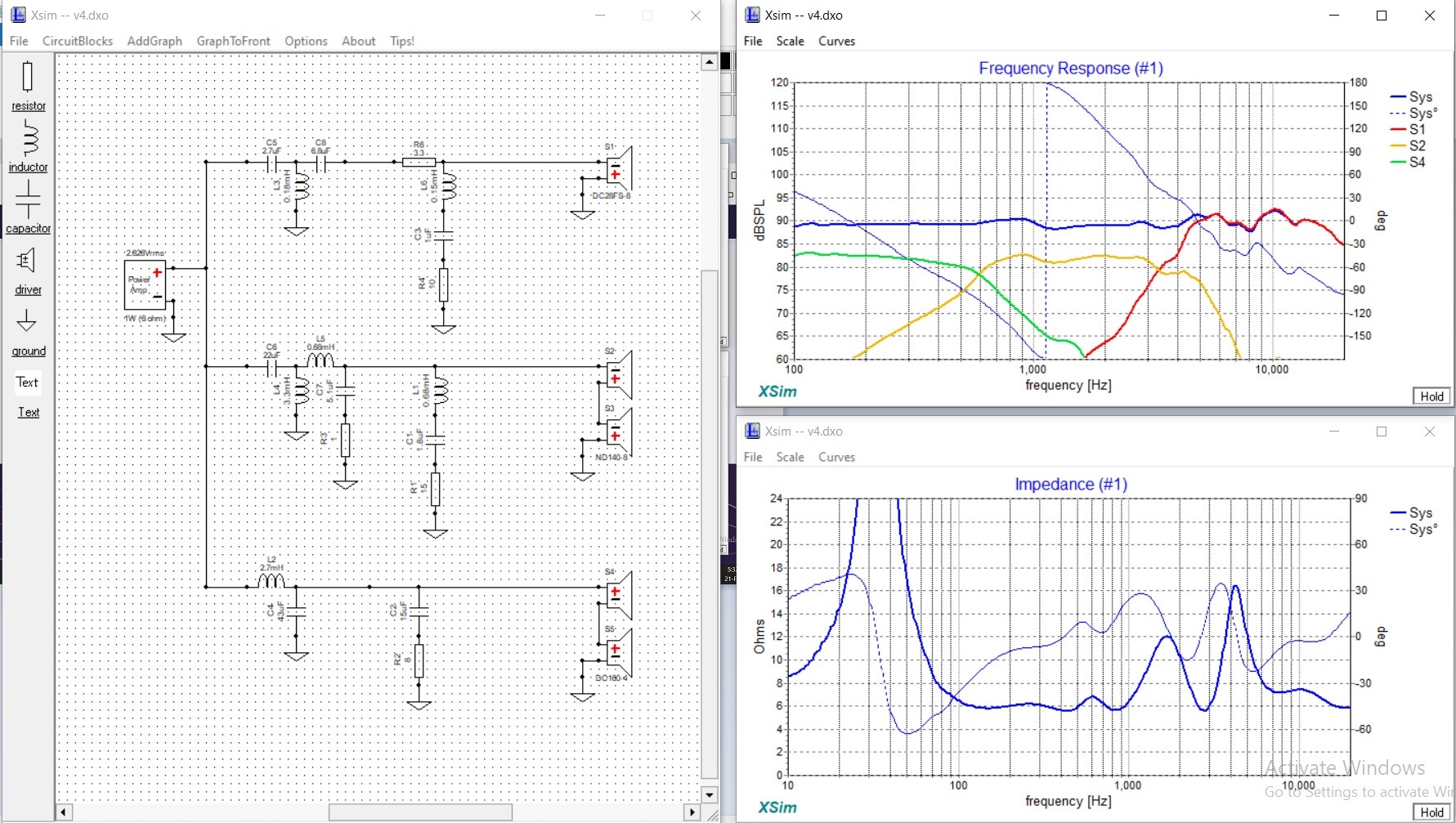

@alpha32 , here's another kick at the can. Two versions to show the effect of the baffle step on speaker sensitivity. Version 4a (no BSC) and version 4b (8in wide baffle). I've also included the FRD for the baffle.
The bumpier the FRD is, the more components required to notch down the bumps. Everyone has their bag of tricks to fix these, looking at examples is a good way to find them. Xsim is fine for XO work but eventually something like VCAD is more a complete tool for speaker design.
