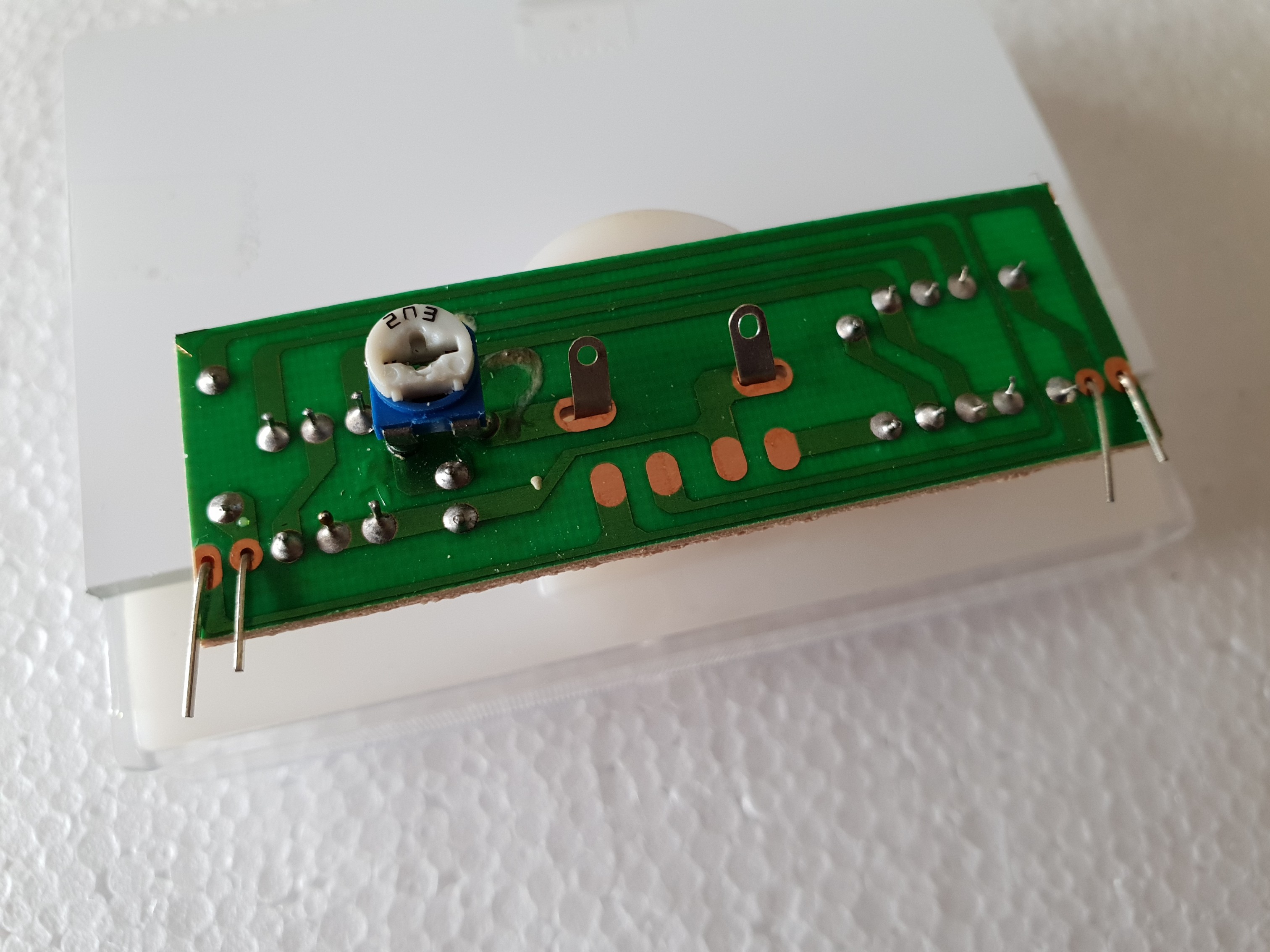

Correct way to connect VU Meter
It looks like the LED backlight supply is connected to the two lefthand pads of that group of four. Beware of polarity and voltage.
Next pad appears to be audio ground (speaker -) and the right hand pad goes to speaker +
I'm not familiar with these. There is PCB with them, not naked instrument. In the central part there are two LED light connectors and two connectors for the VU instrument. You should draw a schematic of that PCB with all the elements in order to figure out what to do. Try to ask for the schematic from the seller with the parameters of the instrument.
I got this back from the Seller. So I guess I should solder the led legs and the gauge tags that are poking through.
Does anyone have a schematic of how I wire this with a Stereo Log Volume Pot?
