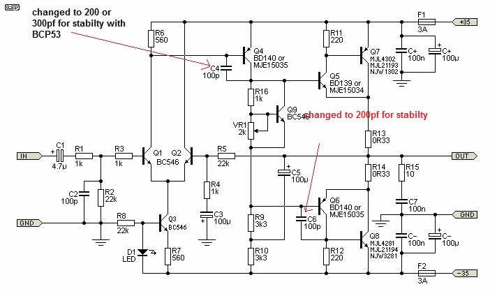

Correct location for VBE bias transistor on CFP output amplifier
does this calculation for the 0.33E resistor sound correct ..

ahh understood , thank god i was going to order a 20W resistor but aint their a way to omit this resistor all together ... some like the attached schematic

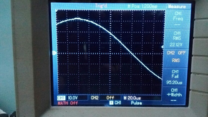

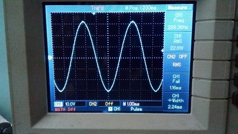

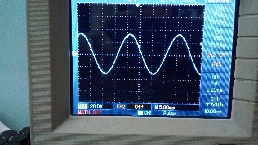

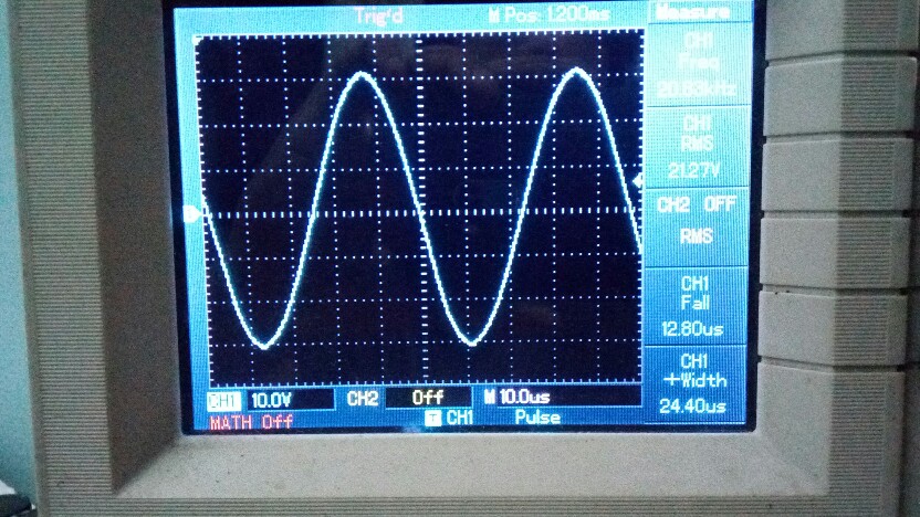

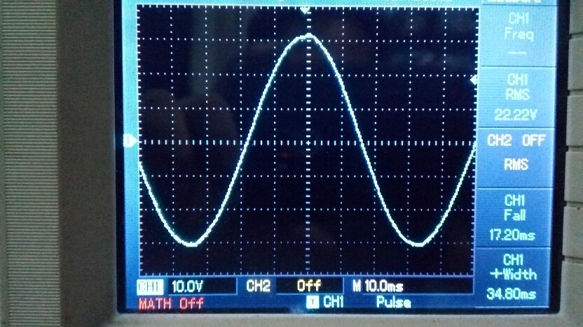

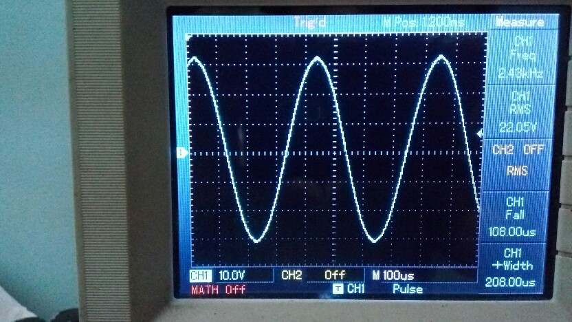

Sine wave test... Supply voltage 45NL loaded it comes down to 39-40VDC

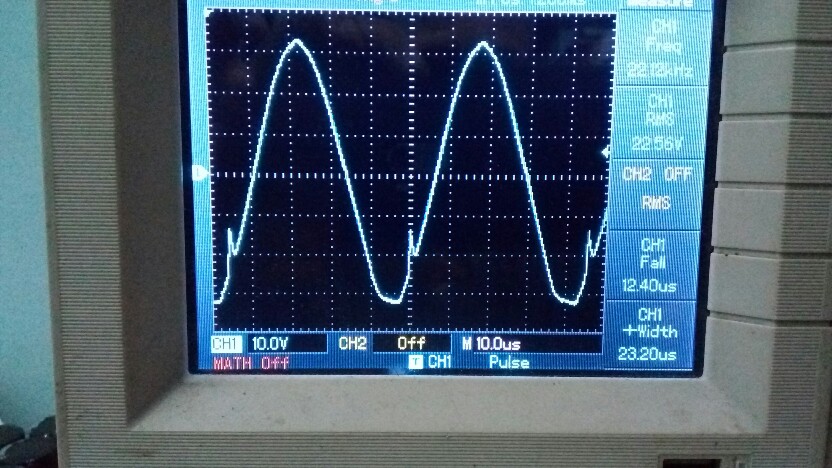

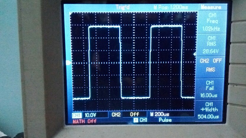

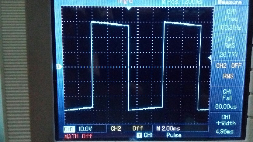

Square wave test.....I think I need to reduce the Miller compensation caps...May be then the lower and higher frequency graph will be a bit better... And load is 3.5E

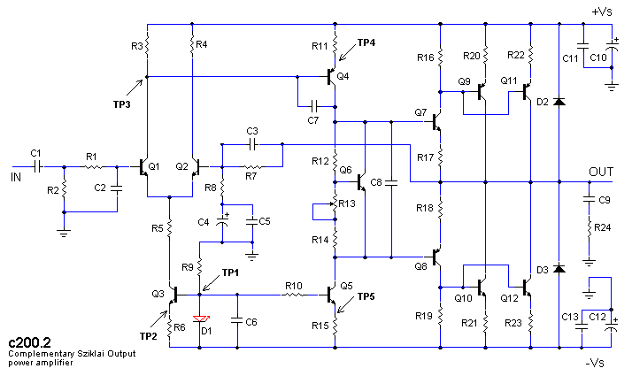

one pair of 150W devices operating from a loaded (already sagged due to high current delivery) is not enough for a reliable 100W into 8ohms output power. And certainly can't be used with a reactive 4ohms load.
Assuming you stay with only one pair for an 8r0 dummy load:
output to load is 28.284Vac and 3.5355Aac (=100W into 8r0)
This current has to flow through the two emitter resistors on alternate half cycles, so we need to apply a 50% duty cycle.
Pdis = Iac^2 * 0r33 * 50% = 3.5355*3.5355*0.33*0.5 = 2.06W
5W 0r33 emitter resistor will get pretty warm during full power testing. And will drop over a volt so you need to increase your loaded supply rails by that volt.
However you are more likely to use a 2pair output stage.
The current through each resistor is now 1.77Aac and each has a Pdis of 0.52W and only drops <0.6V resulting in more maximum power from the same supply rail voltage.
For a 3pair output stage driving a 4r0 dummy load to a maximum output current of 7Aac (=196W into 4r0)
each emitter resistor passes 2.33Aac
Pdis = 2.33*2.33*0.33*0.5 = 0.9W
post88 pic2
the 103Hz square wave is showing a slope indicating that the bass is rolled off.
What is your target passband for this amplifier?
I want a flat frequency response from 10hz - 20khz ... I have noticed that when i increased the miller compensation capacitor for stability the frequency bandwidth gets skewed ... any thoughts ??
