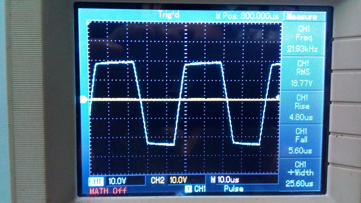

i am using two pairs , but i have faced the same problem with one pair also.. might be I am using 45V rails and a 4E load.. what should be the voltage across R9 ..?? and how do i increase the bootstrap current
R9+R10 set the VAS current.
Ivas = Vrail/ (R9+R10)
note that VAS current changes with supply rail voltage !
As soon as you start to push some output current into your load the supply rail voltage will fall and that reduces the VAS current.
If your 4ohms load demands current, the output devices will place a demand on the driver stage. That places a demand on the VAS stage, since you have no pre-driver.
Can your VAS stage supply sufficient current to meet the current demands of a reactive 4ohms speaker load?

i tried lowering the resistor value to 2.7k on both R9 & R10 ..but the same happens ... I also tried lowering the DC supply rail to 35V and it still had the weird artifact , i even tried one output pair ...but its all the same...
The differential voltage across R9 should be about 22V and steady across the audio range for 45V rails.
Before we proceed, can you measure DC coupled Vout on CH1 and the DC coupled voltage of the negative rail on the same scale on CH2.

i measured the Dc rails its +-45V no load and +-40 V loaded and across R9 its 20V at load and 22V at no load ...
I answered your question on VAS current and how to adjust.
The glitch as the amp comes out of clipping is a different problem. You need to look at the AC behaviour to investigate that.
