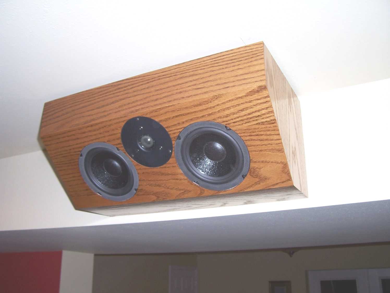

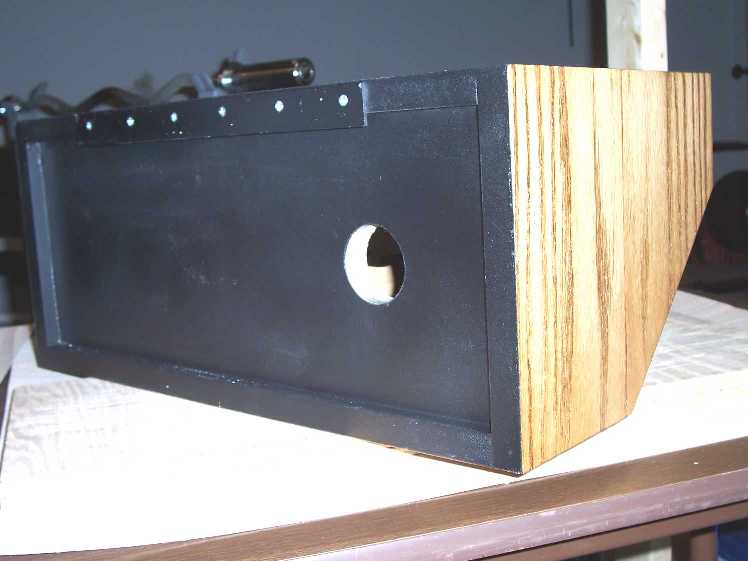

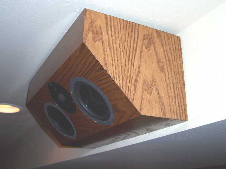

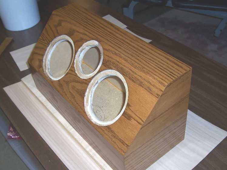

These are some of the first speaker I built. Curt Campbell's Triune.
TriuneTL_07
They are still in use for my wife's HT setup as surrounds

Curt designed these as main speakers and as a center channel. The off center tweeter will help with the diffraction signature of the vertical MTM main speakers. The tweeter offset carried over to the horizontal configuration.

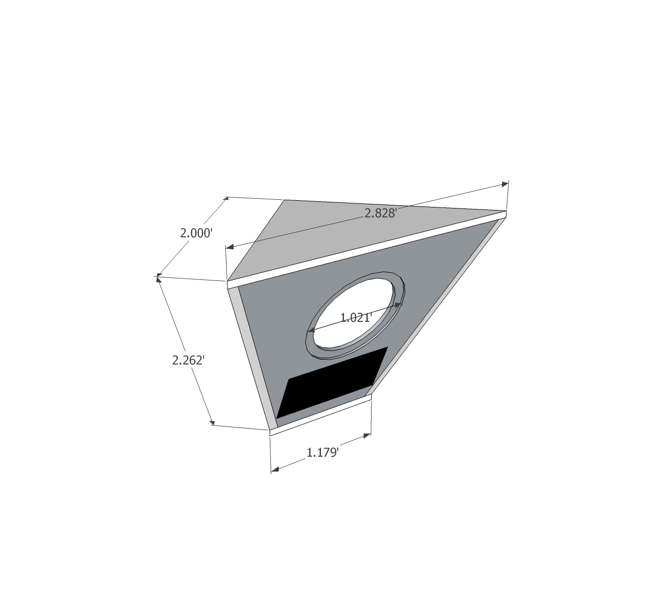

Here is a concept to consider. Its a SEOS12 and compression driver with a 12" woofer structured to aim down from a ceiling corner. I never built it; I got interested in Synergy horns instead. If you did build it you would probably want absorbers on the walls and ceiling immediately adjacent to the cabinet. There is enough cabinet volume there for bass reflex so with the right woofer you could have response down to ~40 Hz.
Something else to consider would be Bwaslo's Small Syns built into a box shaped like this but that would mean taking on a more complex crossover
