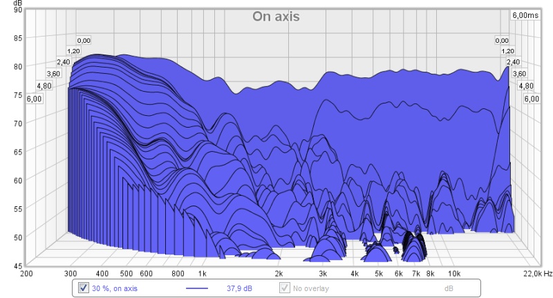

First measurements - the TC5FB00
First up is the smallest one, the TC5FB00! It truly is tiny, with a diameter that is smaller than the R2604 (tweeter) that I've used earlier.
The screws look large, but they are 3x30 mm... I didn't recess the driver, but it only has a <1 mm front plate.
I made a simple box for testing the drivers by heavily stuffing a ~6 l box made of 19 mm MDF:
The edges are chamfered and the driver is placed off-center to reduce diffraction influence.
Measurements are done outside at 1 m distance about 1.7 m above ground.
Here is the results at 0 to 60 deg with 1/24 octave smoothing, no gating:
And with psychoacoustic smoothing:
Compare to manufacture data:
This is the impulse- and step-response on axis:
This is distortion at about 76 dB:
And at about 87 dB:
Interesting driver IMO! I'll try rear mounting it to see if those off-axis dips can be fixed. In that case it it could definitely be used as a tweeter down to about 500 Hz!
/Anton
Nice setup. You can probably avoid the 10 kHz dip if you flush mount it. 11 kHz is approximately 1 inch, which might be the edge of the driver, which looks like it is a little off from the baffle.
There is a lot to like about the response. And it's much smaller. I think arraying multiple drivers could get you to maybe 300 Hz comfortably. But that's not enough. You really need to get to about a 100 Hz comfortably. Maybe you can do some math to figure out the distortion at 100 Hz to hit 110 db with a floor to ceiling array of these drivers.
Excited to see these though! Thanks for sharing!

Yeah, I agree. Probably more useful for other stuff than FTC arrays. 110 dB is insanely loud though, I seldom play above 80 dB in my living room. I'm usually aiming for 95 dB/1 m at reasonable distortion.
