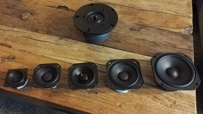

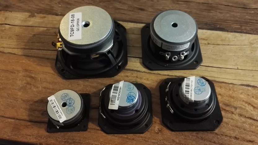

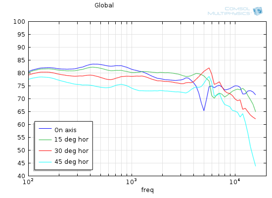

First measurements - the TC5FB00
First up is the smallest one, the TC5FB00! It truly is tiny, with a diameter that is smaller than the R2604 (tweeter) that I've used earlier.
The screws look large, but they are 3x30 mm... I didn't recess the driver, but it only has a <1 mm front plate.

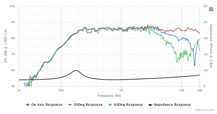

I made a simple box for testing the drivers by heavily stuffing a ~6 l box made of 19 mm MDF:
The edges are chamfered and the driver is placed off-center to reduce diffraction influence.
Measurements are done outside at 1 m distance about 1.7 m above ground.

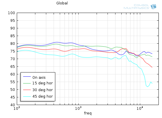

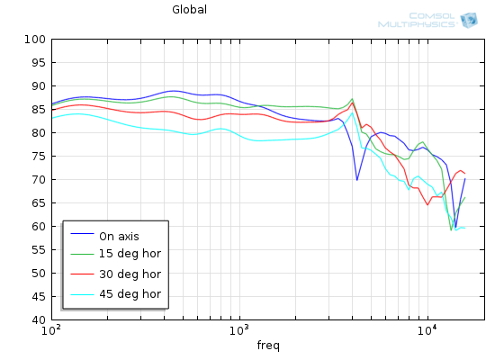

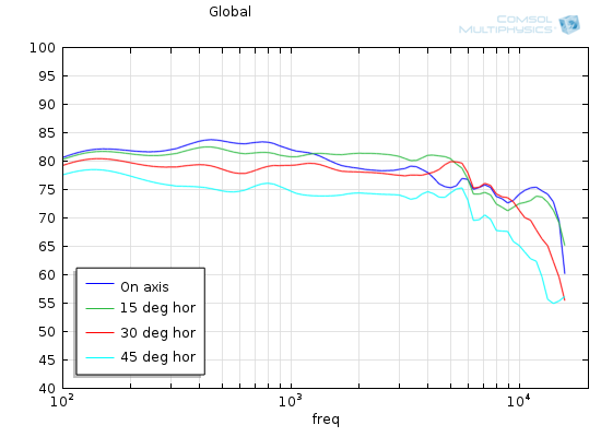

Here is the results at 0 to 60 deg with 1/24 octave smoothing, no gating:
And with psychoacoustic smoothing:
Compare to manufacture data:
This is the impulse- and step-response on axis:
This is distortion at about 76 dB:
And at about 87 dB:
Interesting driver IMO! I'll try rear mounting it to see if those off-axis dips can be fixed. In that case it it could definitely be used as a tweeter down to about 500 Hz!

Nice setup. You can probably avoid the 10 kHz dip if you flush mount it. 11 kHz is approximately 1 inch, which might be the edge of the driver, which looks like it is a little off from the baffle.

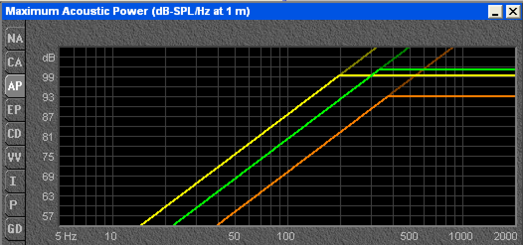

There is a lot to like about the response. And it's much smaller. I think arraying multiple drivers could get you to maybe 300 Hz comfortably. But that's not enough. You really need to get to about a 100 Hz comfortably. Maybe you can do some math to figure out the distortion at 100 Hz to hit 110 db with a floor to ceiling array of these drivers.

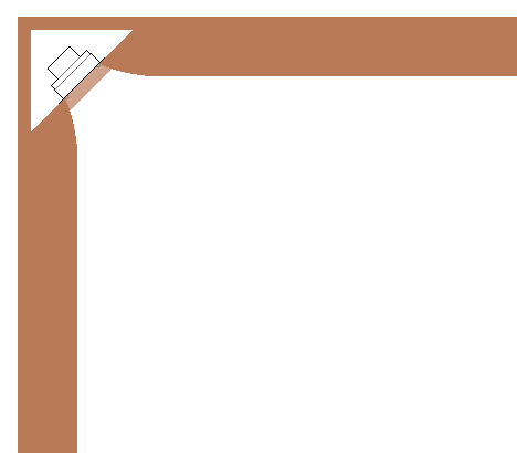

A corner synergy is still a possibility, although the corner FTC array looks very promising in the room it will sit in. And I've never made an array, so that would be fun.

My main reservation is diffraction from the horn entry. However, assuming this can be mitigated (like Bushmeister's did in his build) I'm still optimistic 😎
