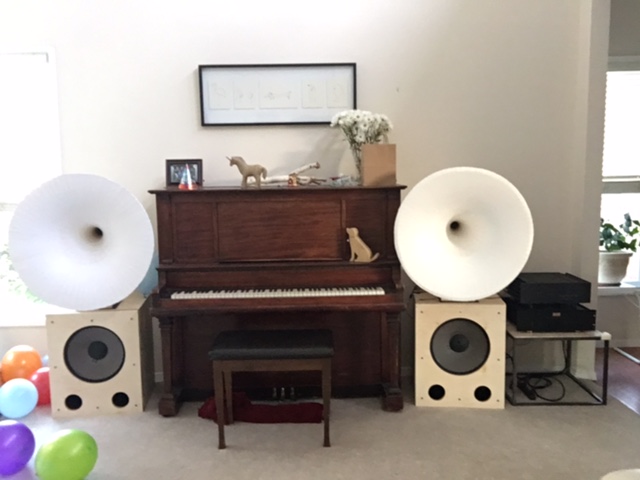

I invited them over to my home to listen to the line arrays and paper horn system. They really liked the system built around the paper horns. The woofers are JBL 2226, and I recently built cabinets for them per the JBL enclosure guide. I used 3/4 inch baltic birch for the first time. Really impressive plywood. It is so uniform and stable and strong. The front baffle is two layers of plywood separated by a thick rubber layer. The woofer is mounted on the front baffle, which is fastened to the enclosure baffle by threaded inserts and screws. Lined on the inside with denim insulation.

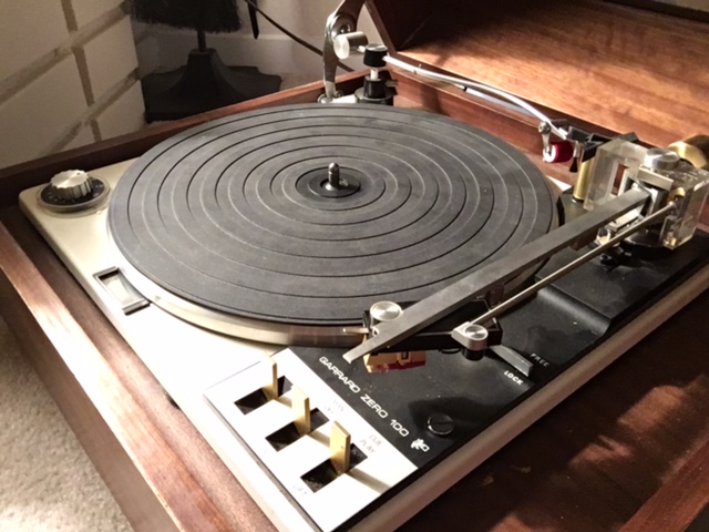

With all the analog gear in their systems, I got the itch again and bought this beauty: Garrard Zero 100. Looking forward to getting it setup.
