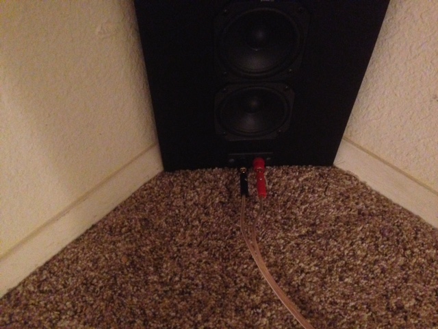

The construction is relatively straight forward. It’s a three-sided cabinet. The front baffle is as narrow as possible so that the drivers can be as close to the corner as possible. The drivers are flush with the front baffle. I had this design in my mind for at least a year but never got around to building it. Finally, after months of frustration at never finding the time to build the cabinets, I asked my friend John (carpenter) to build the cabinets and wire up the drivers.
John completed the build and the arrays are playing music. They occupy very little space, can go plenty loud, are pretty efficient and very low distortion (each driver is barely moving even at loud levels). Using a single 3.5” driver ensures a uniform off-axis response up to a high frequency, above which the Vifa does start to beam, but it is relatively well controlled. The on-axis response is flattened using DRC software, i.e., automatic room correction. The final result is quite good. Measurements coming up shortly. There is still a long way to go. The EQ is doing a pretty good job, but I think it can be better.

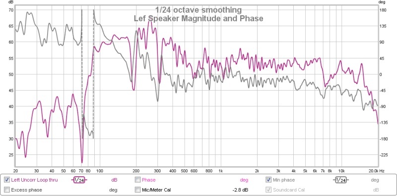

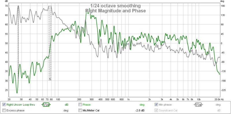

Measurements

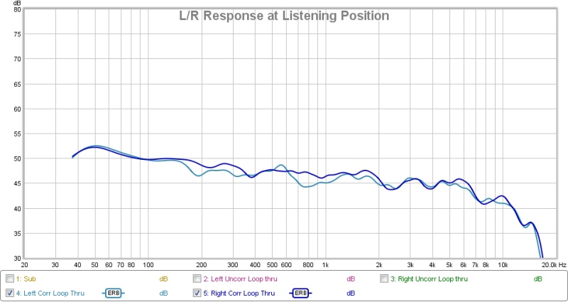

I wanted the drivers to be as close to the wall corner as possible and so that limited how wide the cabinet could be. And it was always going to be 7'-0" tall, the height of the ceiling. The cabinet dimensions sort of limit the bass extension. I can throw power at it and get it flat, but I am not doing that because I use a separate sub and am building two more at the moment. Besides, the resonant frequency of the TC9 is 125 Hz and it may not be a good idea to push it much below that region.
The measurement is made at the couch, just below and behind the projector. It is more than 12 feet away from the speaker. The HF has a 6 db boost past 4 kHz in all the uncorrected measurements. The uncorrected measurements show a pretty impressive impulse response. It is almost the perfect Dirac pulse. But one would expect that given the even frequency and nearly flat phase.

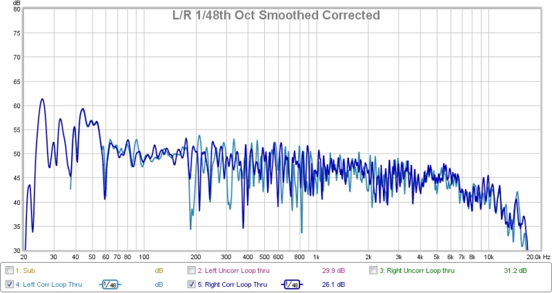

The uncorrected measurements are fed to DRC and the corrected response is convolved through JRiver. The corrected impulse does show some ringing. I suspect it is related to the measurement setup, or it could be that the subwoofer kicks in much before the array. Needs some investigating.

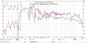

Uncorrected Left FR and phase:
Uncorrected Right FR and phase:

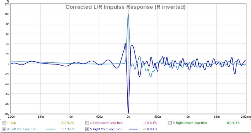

Uncorrected impulse response:
Corrected impulse response:
Corrected FR with sub 1/48th Octave smoothing:
Corrected FR with sub ERB smoothing in REW:

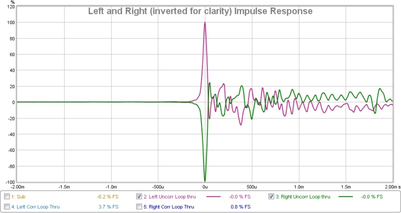

Looks pretty impressive. But is the corrected IR response graphic right? L and R look a lot different from each other, like the L is actually the uncorrected maybe?
What DRC are you using? FIR based or IIR? And is it auto, or are you doing it manually with something like RePhase?
I've always seen best result from manual, but no experience with more modern setups like Dirac, maybe they do better. If you aren't already, I'd recommend eqing from relatively near to the speakers (so you are acting on the speakers, not on position sensitive room effects). You do not want to try to eq out reflections coming from behind you, particularly at above 400Hz or so.
@thunk303, Thanks. I know it looks bad (sort of) but it sounds fantastic. The response at the listening position is so smooth and "liquidy" and they do the "you are there" thing very well. DRC does a fantastic job at EQ.

Yes, it's correct. I know it looks bad and I do need to investigate. It is either the loop through (i.e., my convoluted measurement setup) or it is the subwoofer that does not have the right delay. But the proof is in the pudding, and the pudding tastes quite good 🙂 I'll measure the arrays only (no sub) tomorrow and see what I get. The uncorrected measurement does not have the sub in it.
I am using DRC (DRC: Digital Room Correction), which is a free, auto correction software. It is quite brilliant. It uses a variable window for calculating the response to be corrected, i.e., short for HF, long for LF and smoothly varying in between. It also allows to change the windowing. It is kind of arcane, relatively speaking, but you (Bill) shouldn't have a problem with it. There is also a user guide on diyaudio with custom scripts to get you started (http://www.diyaudio.com/forums/full...ectrical-loudspeaker-correction-networks.html). I use the original ERB setting, which the software designer (Dennis) says matches the ear's response the best. REW has also recently introduced variable filtering. It also has psychoacoustic and ERB filters.
I used to think about EQ'ing the direct sound only, but DRC recommends measuring at the listening position. Dennis uses something called the spectral envelope to do the correction (DRC: Digital Room Correction). All I can say is that it sounds pretty fantastic. I have used rePhase to do manual correction and DRC is leagues ahead.

About construction - does each driver have it's own airspace?

All the drivers share the cabinet volume.

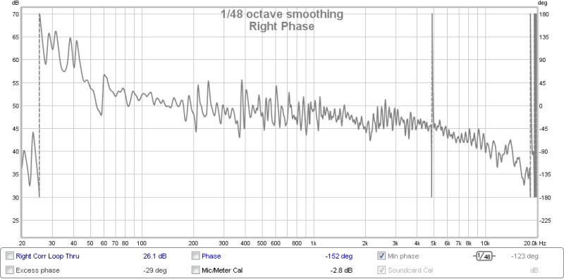

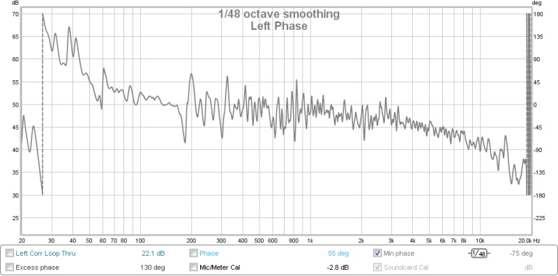

A couple more questions if I may. What does the phase of the corrected signal look like?
Here's the corrected phase:

Thanks Juhazi! All the drivers share the internal volume.

I'd say it's between the two charts you've shown. I'll have to listen again. Yes, I've heard the bit where Jennifer is next to her central voice. I'll say that the separation on orchestral works is better. I'll pick out a few recordings to share notes.
I'd have to agree... need to play Jennifer again but do not have the house to myself this week. I haven't had the depth suggested in the lower chart, but have way more focus than the upper one suggests.
I agree to have heard more separation on other tracks. But I find these charts fun to compare to. I used a couple of tracks as reference all trough my journey and that Jennifer Warnes track did not make it into that selection.
