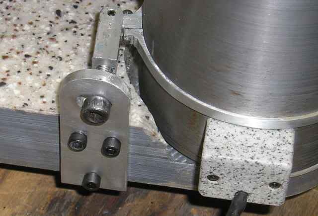

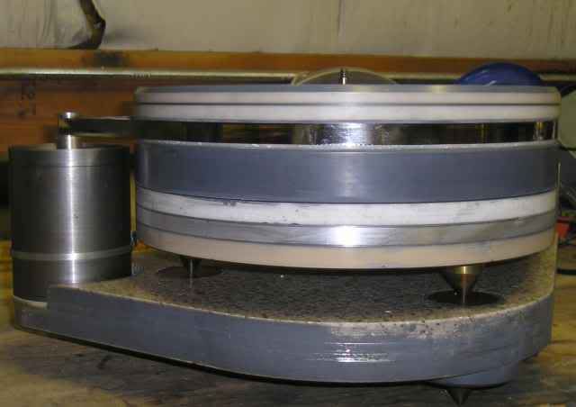

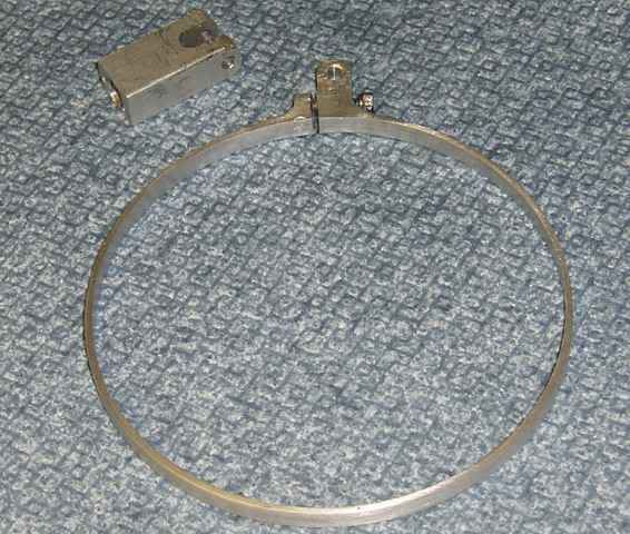

First another chapter in the motor journey. I had discovered that when the motor was left idle for an extended period of time (days), the top bushing would loose enough of it's oil to cause a light scrub. After re-oiling it, it would go away. With a load, I found it was much worse..it would start to scrub after 20 min. or so. Clearly the oil was too light for the job. In addition, the intermittent noise returned. We have been experiencing some bitter cold lately (single digits), and I suspected the metal had contracted enough in my unheated shop to have broken some glue joints on the motor mount. As much as I really didn't want to, I broke down the motor to re-lube and inspect it. Sure enough, two rubber blocks had come free. I re-glued them, and while that was setting, inspected the spindle and bushings. The bushings looked great, but the spindle was a little scuffed. This was caused from the scrubbing. Rather than oil, I reassembled with Mobile1 synthetic bearing grease. This worked a treat. It's as quiet as ever, and in addition, I filled the void in the pulley bottom that covers the bushing, making a dandy grease well. I ran it for several hours under load with no problems. Let's hope that this is the end of it.
The last thing I had done in the shop was to break off a tap in the motor strap for the belt tensioner I've been working on. After punching it out, I drilled the hole clean, and pressed in an aluminum pin, and re-drilled and tapped. Here is the strap, and the matching clevis...

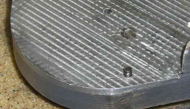

I then mounted a pin in the motor cutout of the plinth for a pivot point...
and drilled a matching hole in the bottom of the motor..
Next I fabricated the bracket for the adjusting screw, and assembled the tensioner...
I still need to polish the pieces, and fabricate a purdy knob for it, but it works fantastic. I used a 28 TPI screw, giving me approx .036” of travel per revolution at the screw, and due to the pivot location, about half that at the motor. Setting up belt tension is actually fun now, compared to the nightmare of fudging the motor by hand before. Here is (finally) the table spinnin' under it's own power with the new motor assembly...
The new pulley profile is excellent. After dialing in the tension/angle, the belt holds it's position dead center. Under load, and the table sitting on a spongy bench, the motor does manage to vibrate ever so slightly..probably made worse from the thinner motor shelf. This noise is barely detectable with a stethoscope on the bottom plinth, but I couldn't detect anything (even with my screwdriver test) on the top plinth. I'm OK with this, and I suspect beefing up the motor shelf, and the table sitting on a proper stand will either eliminate it, or at a minimum, reduce it further.
As far as airborne noise goes, if you hold your ear an inch or so from the pulley, you can hear the hiss of the belt running on the pulley...thats it. You can also feel a slight vibration if you lightly touch the running belt..I'm OK with this as well. The minuscule level of energy here is unlikely to effect my platter.
I'm a happy lad 😀
I said I can see the light at the end of the tunnel earlier. Tallying the remaining tasks has made me realize it's a fairly distant light (finish work,stand, arm,etc.)..but at least I can see it.
-Casey
Edit: I forgot to mention that the motor comes inside with me now.

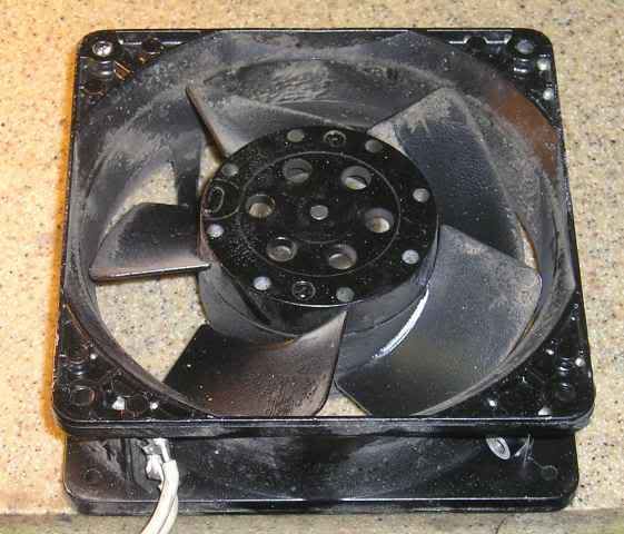

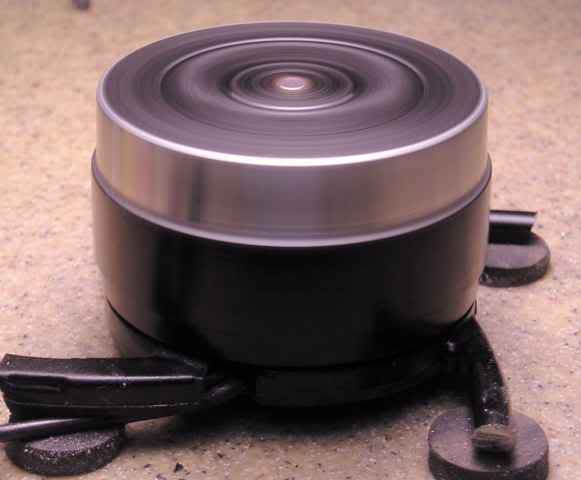

I had intended to hold off on any air pump work until the rest of the table was done, but not knowing if it will work or not has been nagging at me (my implementation, not Tesla's turbine which most definitely works). Since I believe I have everything I need, and it's not a big project, I've decided to bounce back and forth as the mood strikes me. The plan is to make the housing out of Corion and/or Lexan I have laying around, and use Cd-Roms as discs, other than the spindle and motor assy., I should be able to throw together a “proof of concept” pump in a day or so of work, which no doubt will be strung out. I'll simply draft the design actual size, and use the drafts as templates to cut out the pieces with my rotory tool and router. If the first attempt works, or is very close, cool...I'll invest the effort to fine tune it. If not, then I will know it's been a fool's errand, and look at a more conventional air source.
The biggest unknown for me has been the motor to drive it. It needs to be quiet, spin somewhere between 1500-5000 rpm, and have enough oomph to work against the air pressure I'm after. Digging through my junk, I came across a pile of Pabst muffin fans I had pulled from the same motor controller I got the aluminum for my bottom plinth from...
Other than the fact it had blades hanging off it, and it was integral to the fan housing, the motor was pretty close to ideal..120V, 3000rpm, 20 Watts, and running you hear the fan, not the motor. Hmmm I sez. I decided to see if I could pull a usable motor out of it's fan prison. I broke off the blades, trued up the hub with my press mounted Dremel/file, cut out the support arms, and cleaned it up (about an hours work total)...
Beauty. The motor is running in the picture (obviously) just sitting on rubber discs. It's stone quiet, and if you look at the edges of where I cut the supports you'll notice that there isn't any vibration to blur the flash less picture. I plan to run a flat belt around the finished portion of the hub to drive the pump.
Thats one less thing for me to agonize over 😀
-Casey
Hey Casey - I hate to be a party-pooper, but you should be careful about expecting any lifespan from these muffin fan motors, especially with any side-thrust load on them. Just driving their fan blades they will wear out in about a year of continuous duty.
I work with computers (nearly 30 years now) and these things are the most-replaced component (other than keyboards smashed by frustrated users) on computers today.
The upside, however, is that they are plentiful and cheap, so make several!
Jess
Hey Jess-
All of this is true...with garden variety BLDC fans. I myself have cursed the fans in my PC more often than I can count. These, however, are a completely different animal. They are German made synchronous ac motors with bearings to die for...and very expensive. They were designed for industrial duty in a nasty environment. These particular units were pulled from an 80's-90's vintage industrial multi KW 3-phase VFD that probably cost more than your house 😀. When I pulled them, they had a thick layer of nasties on them, and all appeared to be original...everyone still works quietly.
I just timed the spin down to get a handle on the bearing condition...It spun for 1min, 39 sec. Before coming to a full stop after unplugging it
I think it will handle what I'm going to ask from it, and if it does die on me, I've got 5 more to try 😉
-Casey
