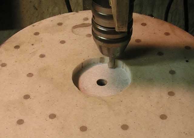

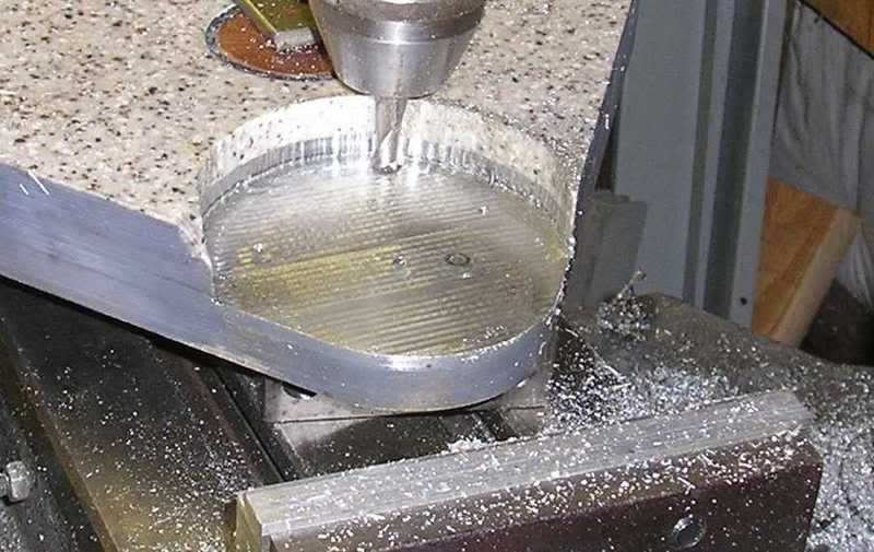

This turned out to be one of those weekends where I didn't get near as far as I had hoped..everything seemed to fight me. I didn't get the table spinning again, but some progress was made.
First up was re-cutting the recess for the spindle bearing. The gap between plinth and platter was .1” , and I wanted .03”, so I cut it down .07”...
I remounted the bearing and platter to measure how deep I needed to cut the motor cutout, and proceeded to mill out .34” This about half way though...
And here it is finished...
This was a time consuming PITA. Not wanting to de-laminate the plinth from excessive vibration and pressure, the max cut I took on a pass was .025”. The real fun though was dealing with the contour on a X-Y table. It's not perfect, but it will clean up well..putty's your buddy 😀 . With the loss of material, reinforcing the motor shelf is no longer an option. I'll mount something from below.
Hopefully next weekend will be more productive..I really want to se it running under it's own power again.
-Casey

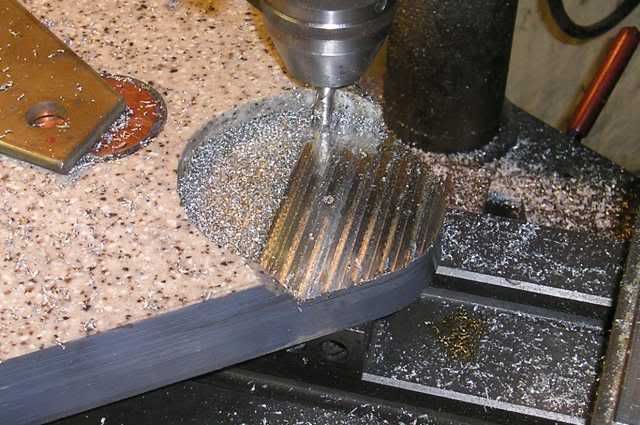

A few things I forgot to mention after I dragged my tired posterior out of the shop last night.
After cutting the RTV out of the foot pods that I laid in during the “Bubble Wrap Follies”, I re-filled them with lead shot, and sealed them back up..for good. I also started on a belt tensioner for the motor...and ended the evening snapping off a 4-40 tap in it. I've got about 4 hours, or so, in the piece with the tap shards, so now I have to figure out how to de-uglify it.
Looking at the picture of the finished motor cutout above, you'll notice a dark circle just to the right of the middle of the exposed aluminum. This is a pressed in threaded insert that I managed to miss when I was salvaging the aluminum. It reminded me just how much of this table is comprised of stuff that was headed for the bin. For those that care about such things (we all should to some degree) I give you my “recycled” material list..
Corion- Intercepted on it's way to the dumpster by my brother at the cabinet shop (sink cut-outs)
Lead Sheeting-End cuts from construction of a x-ray room..it was on deck to be melted into line weights for fishing by a co-worker.
Aluminum (bearing housing, pulley etc.)-End cuts from an aerospace machine shop.
Aluminum Core (top plinth)-Gear plate from an old elevator door closer..fished from dumpster.
Aluminum Core (bot. Plinth)-Back plate from an industrial motor speed control I harvested.
Copper (discs in bot. plinth)-Cut out of an industrial power switcher buss bar.
Bearing Spindle-Machined from a broken 3/4” drive socket extension.
Of the above, the only thing I paid for was the aerospace aluminum.. the 80 cents a pound they would have gotten from the recycler. By far, the largest expense so far in this project has been the kerosene to heat the shop 😀
-Casey
Edit: Added copper to list

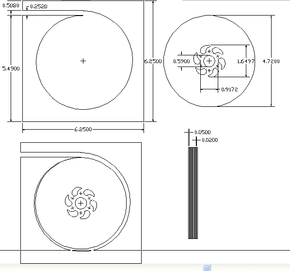

As I an see the light at the end of the tunnel on the table, I have been thinking forward on one of the prime reasons (besides the obvious) I have been building it..as a test bed for some tonearm ideas I've been day dreaming about since I first saw the Ladegaard. After the table is done, and before I can start experimenting, I need a variable, quiet air supply. I asked the requirements of the Ladegaard in another thread to give me an idea of the minimum target.
I have decided that giving a Tesla air pump (you listening nordic😀?) a try would be worth the effort. These things are very efficient, and usually considered when several orders of magnitude more air/pressure are needed. I reason that if it could be a sandblaster at it's optimum 10-50 thousand rpm, it should equal an aquarium pump idling along.
The advantages are:
No pulsations..equivelent to a DC air source.
Infinitely variable
Potentially very quiet..depending on speed.
Any hoo, I have attached a picture showing the basic dimensions of a pump using cd-roms as the discs that I'm considering (waiting for some feedback from the TeslaTurbineList on the spacing) If anyone is interested.
-Casey

It seems to me that a hard drive must have all the components you would need for such a pump: multiple platters, precise high speed spindle motor and driver, and a solid metal chassis that can be made airtight. It's not too hard to disassemble a drive to remove the heads and leave the platters free.
The platters would be too far apart as is, but they are kept in place by simple spacers, so it shouldn't be too hard to make thinner spacers. You could probably add more platters as you make the spacing smaller.
I don't understand how those wierdly shaped holes work in the turbine, but I would say that compared to a hard drive, your drawing pictures them closer to the center. What effect does their distance from the center have?
What's your reason for wanting to use CDs as the discs, rather than hard drive platters?
Hi pixpop,
If you do a search online, you’ll find that a HD was used as a donor for a Tesla Turbine (as opposed to a pump). The platters could (and have) been used, but the motor isn’t stout enough. One word… torque. In the HD, it simply needs to get the platters to speed. In a pump the pressure is pushing both ways, that is, if you have 1 PSI out, you also have 1 PSI pushing back on the periphery of the stack.
The involutes’ shape aids in collecting air at the inlet, used as a turbine they are simply holes for the exhaust. You want these as close to the center as you can get them, maximizing the surface area to push the air. The spiral around the discs (not in a HD) in the housing is an annular diffuser to slow the air exiting down to minimize wasted energy in turbulence. Think expansion chamber in a 2-stroke engine exhaust. This is an early draft that doesn’t show the taper, except at the periphery.
I’m lazy 😀. The CD’s are much easier to cut/machine. If I was going for a high speed monster, I would go with a different material, but the polycarb CD’s should handle what I’m asking from them with ease.

I'd extend the stack - you'll need 10 to 15 CDs to do the job, and I found spacing in the stack to be critical.
I'd also make the involute on say the center 8 disks - it reduces air 'bypass'.
So to sum up. The last disk in the stack (at the back) needs to be solid, and the clearance between the front housing and the first disk needs to be small.
The choice of CDs is a good one, and the whole pump will be as quiet as the balancing of the 'blades'. I had good success using an old TT motor, so it should be easy enough to you to get one working... the trick is getting pressure from them.
As a good starting point - use the built in spacers on the CDs, and see where that gets you to.
Have fun
Owen
