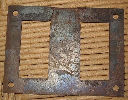

This is an old style core lamination plate. The center tap is bended in order to insert it into the bobbin. What is the pros and cons of of this type/style of plate? Thanks

I've seen it mentioned here:
Practical Transformer Winding
Not all laminations follow the "economy" proportions, though. Here is an example of a lamination that comes in one piece, instead of being divided into an E and an I, and that has the windows proportionally much larger than the E-I lamination shown above. Such a lamination is a bit more expensive to make, because the steel cut from the windows is wasted, unless the manufacturer can find some other use for it. But being able to accomodate a much large winding assembly, it has some advantages in certain cases.
These "non-economy" laminations were quite usual in Europe, many years ago, but nowadays copper is so much more expensive than steel, that transformers are usually designed to use more steel and less copper. And for that goal, the economy lamination is very well suited. So you won't very often come across a lamination like this, unless you are restoring antique equipment.

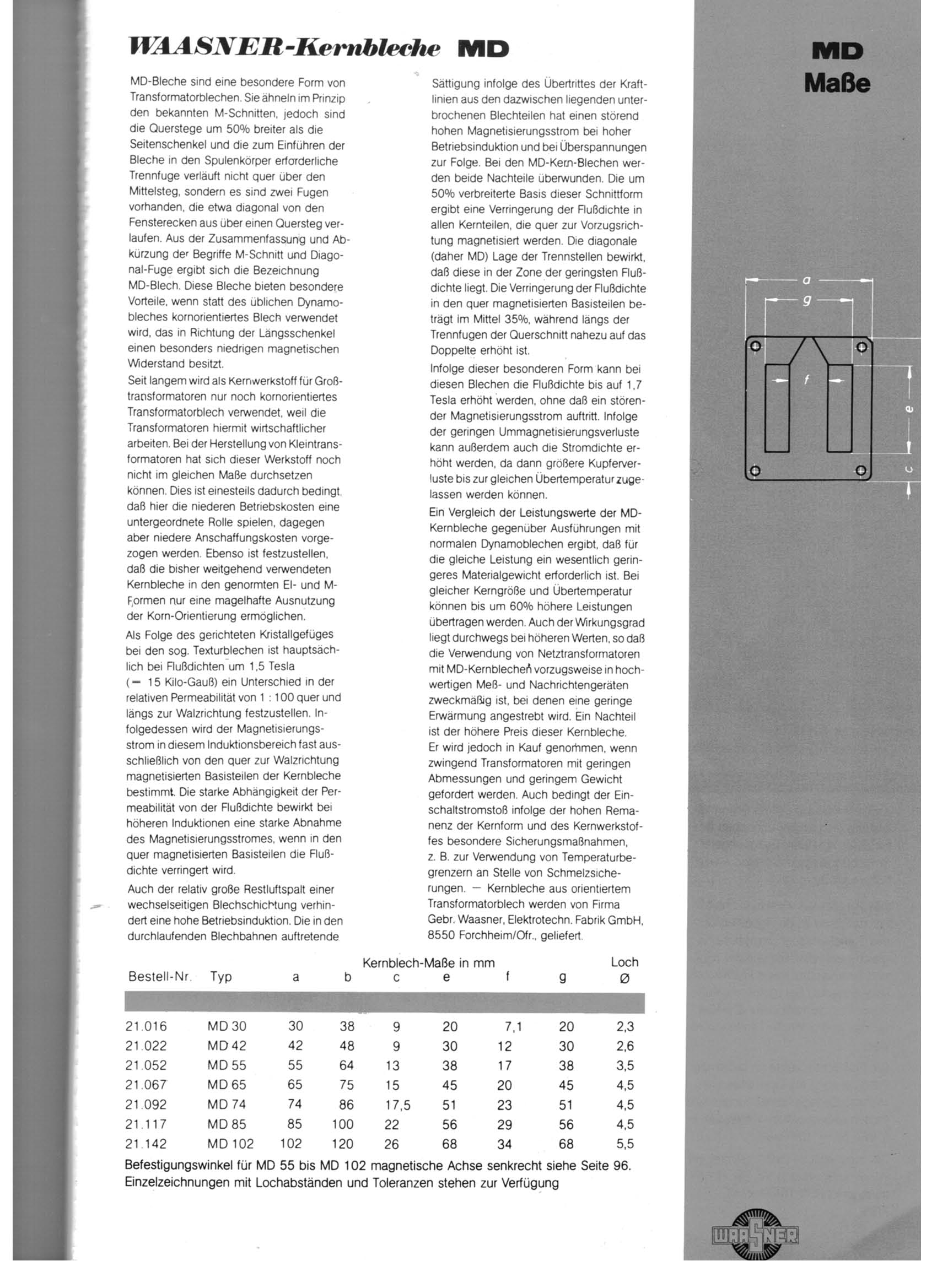

hm pieter, what are you referring too? According to your document the MD cut outperforms the EI and M cuts. And I have an article lying around somewhere promising lower inner resistance even than toroids while having a comparable strayfield and size.
Juergen,
I just took a quick look at that Waasner document, haven't read the whole story.
In my opinion with whatever EI, M or MD core type you will never reach the same level of power "economics" as is possible for toroids, because of the simple fact that with all stamped laminates the corn orientation is not everywhere "in line" with the magnetic field.
Only c-cores and r-cores can approach toroids in that respect.
Also strayfields with non-toroids will always be larger because part of the core is exposed to the outside world; only with toroids, where the coil surrounds the whole core, strayfields are small, especially when it is a low T design.
Toroids have their own drawbacks however.
I'd be interested in the article you have laying around somewhere.

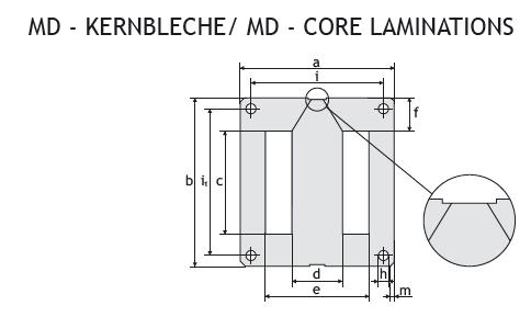

and some blurb on transformers at Jogis Röhrenbude:
Der Uebertrager, das unbekannte Wesen
Der erste große Vorteil ist, man kann genau die selben Spulenkörper verwenden wie beim M-Schnitt. Ein weiterer Vorteil ist, daß der Schnitt im Blech nicht in der magnetischen Hauptachse liegt sondern auf den weniger belasteten Seitenschenkeln. Das D steht für DIAGONAL so wie der Schnitt ausgeführt ist um das Stopfen des Kerns zu ermöglichen. Statt eines Luftspalts hat man hier nur einen Haarspalt.
Damit das Ergebnis optimal wird, wurden die Querschenkel um 50 % verbreitert, die Bleche nur in kornorientierter Form in der magnetischen Hauptachse sowie in dünner 0.35 mm starker Ausführung mit der bestmöglich Silizium-Eisen-Legierung eingesetzt. Damit bekommt man sehr streuarme und leistungsfähige Übertrager in kompakter Bauform. Wenn Netztrafos mit diesem Blechschnitt richtig berechnet und gewickelt werden, sind sie noch streuärmer als Ringkerntrafos.
Der einzige Nachteil der MD-Kerne ist, daß z.B. bei einem M 102 statt den Kernmaßen 102 mm x 102 mm beim MD 102 ein Kernmaß von 102 mm x 120 mm notwendig ist. Angesichts der vielen Vorteile können 18 mm mehr in einer Achse in Kauf genommen werden. Das Volumenmaß eines MD-Kerns ist auch nicht größer als ein Ringkern, denn auch hier gelten die physikalischen Regeln bezüglich des notwendigen Eisenquerschnitts und der notwendigen Windungszahl und der Drahtstärke.
Beim Ringkern hat man auch immer das Problem, was macht man mit den "runden Ecken"? Quadratische oder rechteckige Bauformen lassen sich immer bequem bei bester Raumausnutzung unterbringen. Und da bei richtig gerechneten Netztrafos mit MD-Kern die selbe Streuarmut wie bei Ringkernen erreicht werden kann, können diese problemlos eingesetzt werden.
