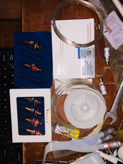

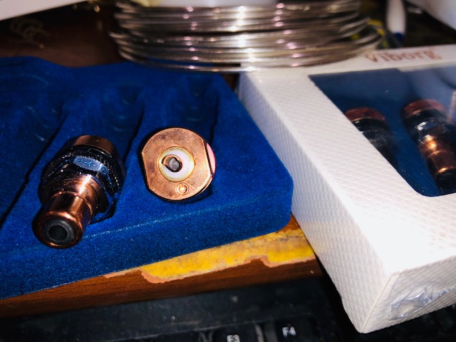

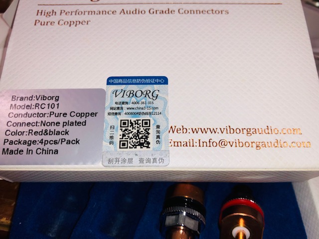

Just arrived
copper RCA female pulgs,
the 1st pic shows my sterling silver wire which i will use as speaker wire for top portion of my Thors MTM, the lower midbass will not benifit from silver, only the mid/high fq's will adda zing factor with silver wire.
The silver flat interconnects you see in pic1, i will give away to my brotherin law, as 1 SOLID 14 gague sterling silver is superior conductance vs 10 super tiny silver wires. also in the pic you can see the cheap brass speaker spades, i will not use, as I will connect DIRECT sterling silver 14 gague wire.,,what else ,,,you can see the sterling silver 14 gague wire in the pic, purchased froma Massachussetts seller.
please leave comments below
I am off to HD to buy small plastic tube clear to house the speaker and interconnect sterling wire.
Gonna add The Zing factor to my system,
I am guessing these pure copper and sterling silver will add, oh say, another 5% pop/Zing factor to the perf.
Please leave comments below
What is zing factor?Just arrived

Be careful with foreign sellers. Red Copper, beryllium copper, copper alloy probably only have as much or less copper content than Brass.
@ JMFahey
OK, yiu got me,,so a shorter copper = same conductance spped as a longer sterling silver wire,,,,hummm, gotta think about that.
You don;'t think that maybe the Siemens in the electrons will pass more smoothly and more electrified via silver vs copper???

The copper posts, for speaker and RCA , look heafty, very well made, and worth the $$$$$.
