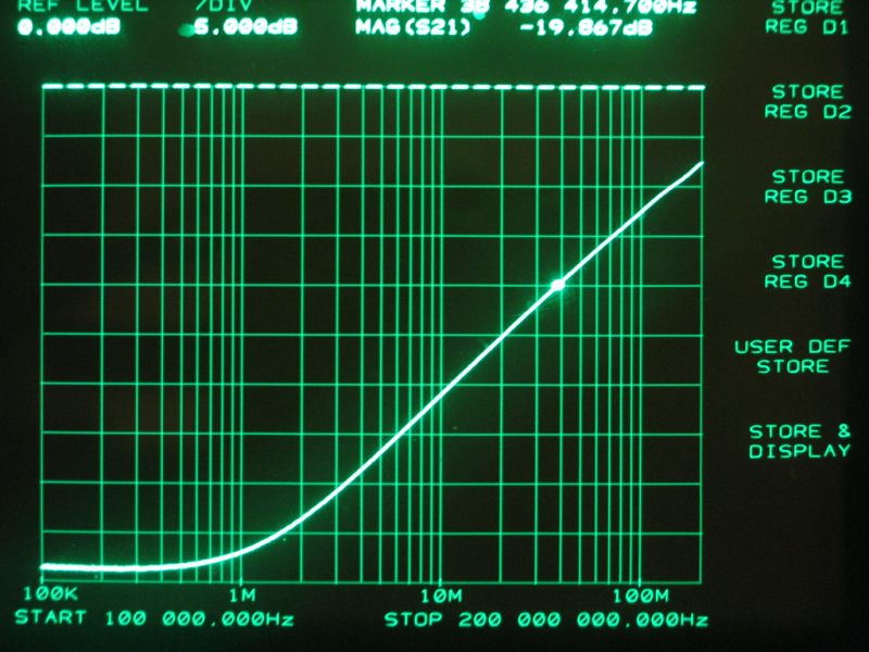

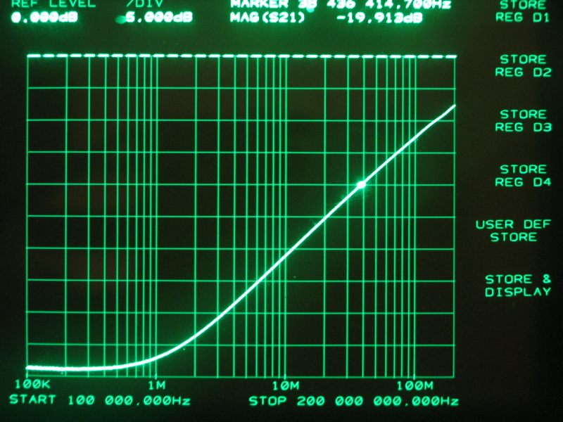

then the copper one -
What you can see is everything equal. At the first sight. But look at the marker magnitude value, that is the measured attenuation value at always the same frequency - it's visible that with copper it goes "deeper", attenuates more, has less ESL. By 0.05dB..😀
But that's real and consistent!
Then, I will not waste more bandwith here, but this value for the alu hat on is -19.885 dB - exactly half way.
For me both theory & practice are satisfied - The change is there, but does not weight in in practice..
Faithfully Yours,
George

Hi George,
Good work. I also knight thee "grand destroyer of capacitors"!
This pretty much make sense and you proved it beyond doubt.
-Chris

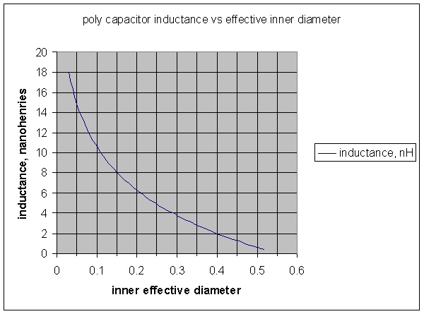

What is also needed for the equations is the diameter of the leads. But, as the capacitor virtual inner lead is an unknown, I will do calcs with a guess of 30 mils (.030 inches) for wire diameter..
The poly:
Modelled as a simple wire pair, .030 dia and spacing of .28 inches, the inductance for this cap is 39 nH. The use of .030 diameter wire is obviously too small, both for the return ground plane and the virtual capacitor diameter.. (as the wire diameter goes down, the inductance goes up..)
So, try .140 dia wire pair, zero spacing..this will be closer to the real thing...this produces an L of 11.69 nH for the capacitor.
This is actually a bit too low, but I cannot model an assymetrical system yet, but will eventually be able to do this when I make my magnetic field software integrate the stored energy of the field.. So, I will have to live with this approximation for now..oh well..
The poly as a coax...using inner 30 mil wire, the L is 17.99 nH...using .140 (half the cap size), the number is 4.17.
Clearly, the effective diameter of the capacitor current is between the two...by adjusting this to get 10 nH, the inner effective diameter is calculated to be .05 inches.
Gotta re-boot...my excel ss went nuts...gonna attach some graphs, but can't make it work..hold on..

Yes, it should. I cannot model that in my spreadsheet, nor in my vb field code. So I can only assume it's presence lowers the inductance by eddy mirroring..
We can, however, use measured coaxial inductance to create a virtual diameter.
Your picture...does it show both foils ending at the input leads?
Here's a graph of the effective inductance..by using a close to perfect outer shield construct, we can find the effective diameter of the capacitor using this graph.
Ideally, the shield should be connected to the top lead all around, if you simply bend the wire over and solder, there will be asymmetrical current distribution along the shield, so there will be incomplete magnetic field cancellation. Simply connecting is not good enough, as we are not worried about the potential voltage, but only how the current travels.
Same at the bottom, where the shield is connected to the ground planes.
Cheers, John

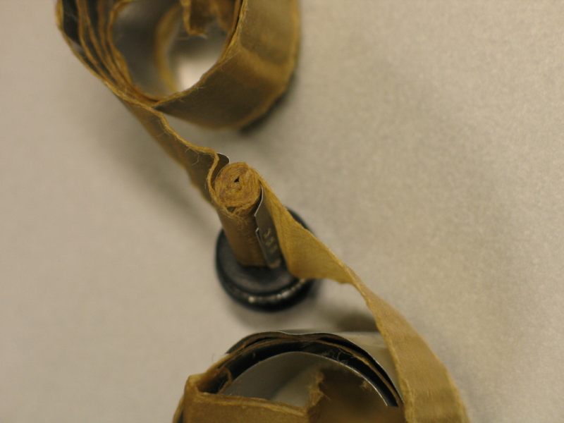

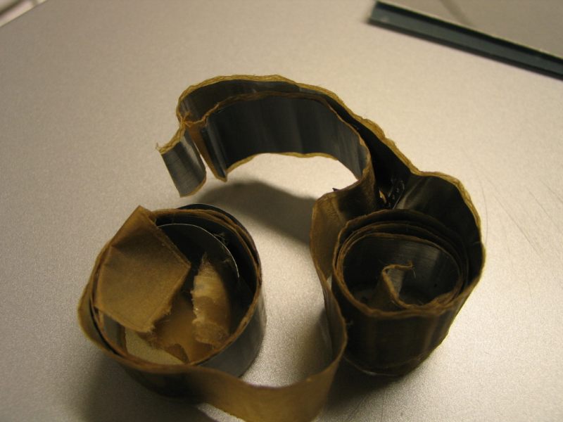

Joseph K said:And the fullstrip..
The strange thing about it is that it fits perfectly Your description, John!
But then why is it cancellating?
The foil displacement is ~15mm, the lead spacing is the usual 5mm / or 20 mil.
Ciao, George
By foil displacement, do you mean the distance the connections were apart along the strip?
If so, then how much of the total foil length of the capacitor is between the connections.. It would seem to be rather small, 5 percent or less of the total capacitor..
That far inside, and so little, there is no wonder the outer shell is of little significance.
We must find a capacitor which is constructed so as to make a very large external solenoidal field..in this way, we can perhaps find a capacitor where the use of copper foil outside can be significant??
Large computer grade capacitors which cannot afford such a hole in the middle comes to mind...
This has been a pleasure..thank you.
Cheers, John
John,
What You can see on the pic is that the input leads are attached at about the 5-10 % of the full roll, as You have described initially. In the first it's visible the still rolled up inner part between the leads, outer part unrolled.
In the last pic all unrolled, the inner part being ~ 2,5inches length of foil.
What you cannot see is that filthy smell..
Yes, You are right, at the "sore thumb" setup the connection was far from perfect, this is why I told I will try it again. practically I will have to reconstruct that small alu can // hat from copper, pinch it on top of the cap with the lead sticking out, then solder it on top and all around the bottom, as much as possible. At the bottom I did it, almost.
Ciao, George

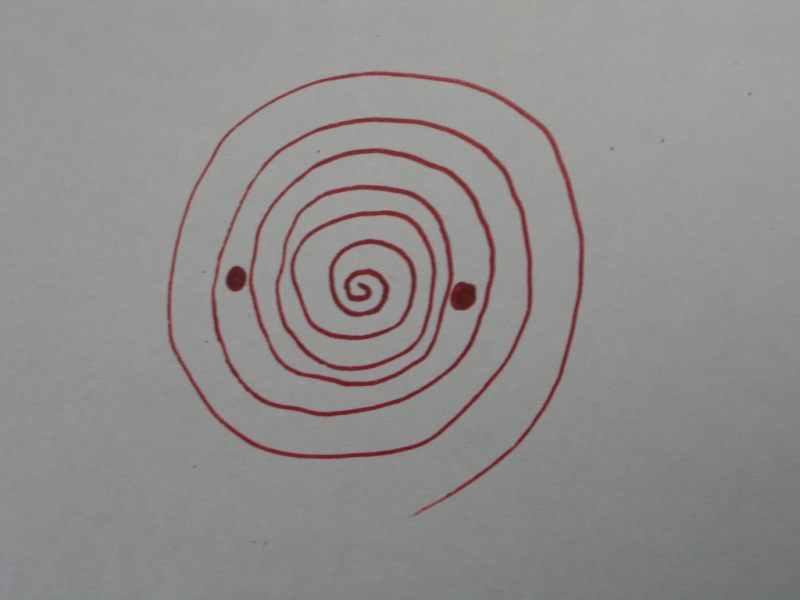

Dear all, but particularly John!
It has just kept on disturbing me, why the theory does not show up in the practical measurements, with radial capacitors?
Then I had a closer look at my own photos - at the time of taking them it was just that - taking them.. Thinking was never my strong side..
So I think to see a basic difference between the real cap structure and the description provided by John. John said:
Note the phrase: solder the bottom lead at the left end.. etc.
While, in the cap destroyed by me, it was like it's shown in my ugly sketch:
So, to make a radial, do this: solder the bottom lead at the left end, but move the top lead a foot away and solder it there..this foot distance will cause the leads to be spaced apart by the thickness of the foil and dielectric times the number of turns you get with the first foot.
So, the leads are NOT displaced by all the length necessary to reach that diameter - instead they are displaced only by the ~ space between the leads! [exactly the length of the half circumference of a roll with the lead space diameter]
[This all because the first lead is not connected to one end of the foil - but are connected with only that sligth shift - so the solenoidal currents are almost totally symmetrical for the ~full foil length, and so they cancel]
In the sketch I have signalled with only one line the full cap sandwitch structure - foil - dielectric - foil. I think this way it can be seen better.
Notice that in this way each of the leads are touching from a different side. One more thing is necessary: the opposite side foils should be displaced [shifted along the dielectric] by this small length described above.
So the resulting stray inductance is equal to this half - circumference, that is, ~ the lead distance. This is why the catalogs mention that ESL is ~ equal to the distance covered by the leads!
