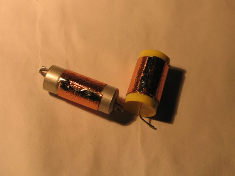

What you say sounds really interesting. Could you be more explicit about a possible measurement with a network analyzer? That is, do you think such an effect shoud show up on it? Because I've tried something, but maybe not the right way?
I've used normal axial wound film caps. Do you think it has a basically different structure with respect to an electrolytic? For me it seemed to be logical, because of the missing alu shield. By the way, just the always present alu can should not have the same effect like the copper foil?
Will show more pics later. No change in the curves, with external copper foil on/off. I would think that SRF dip value, or Q, or RC time costant with the 50 ohm line impedance, something should show a bit of shift, at least?
best regards, george

That is, "invariant" is a bit strong expression, at these size / frequency values the slightest position change on the jig will introduce a slight gross-ESL shift. My statement above should sound like this " At first sight it seemed to be a bit less ESL, but then just by moving the cap by
1 mm I got back the initial values"
putting the foil on /off means moving the cap, unfortunately.
Ciao, George

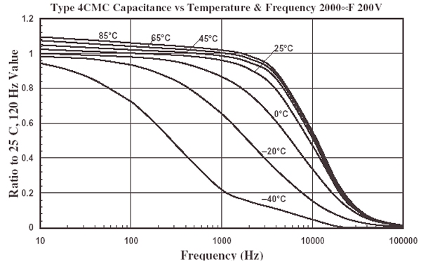

Axial caps are more likely to not have the issue..the leads are pulled out of the same location, so there is no net solenoidal current .
I'll attach a graph of what I'm talking about w/r to cap dropoff with frequency.
I'll also try to make a pic, but I fear I'll have to actually draw by hand (gasp) what I'm talking about and scan in at a later date. Here goes a description..for "current", think ac..

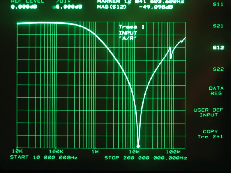

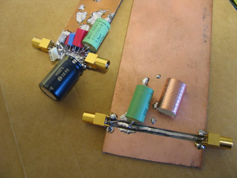

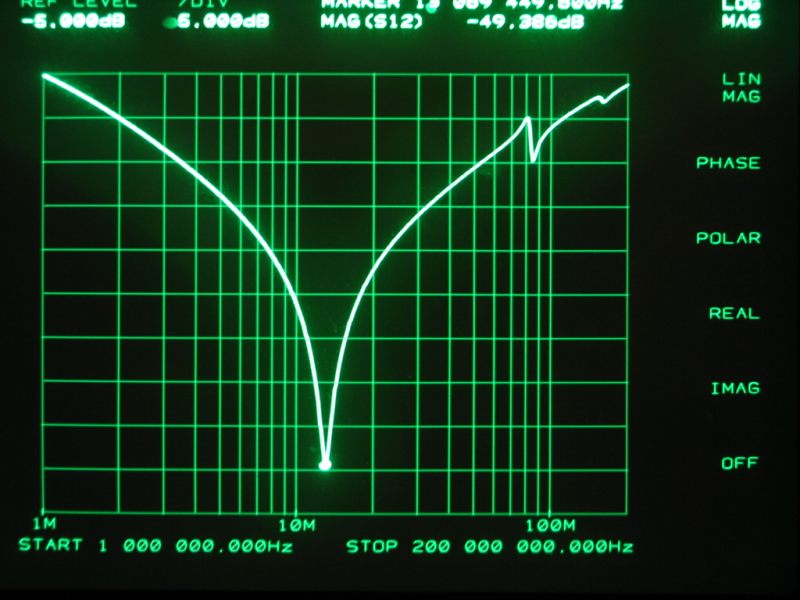

Jneutron,
Oops, you are absolutely right. I was so pretentious that I supposed you know about my measurement method. I've introduced [it & myself]
here
At this post I've explained it a bit further, why is it measuring quite well - at least IMHO. why is it resistive?
As you see, I do not measure inductance - I measure bypass impedance from the attenuation, and I calculate the inductance values from this. This is not a calibrated precise value, but here, and in the majority of practical cases, we are talking about relative impedance changes. Though I would like to point out, that even in absolute terms this method can get quite close, as I have shown it in a thread at the another forum.
The actual test jig now looks like this:[I should have started with this]
But I concur totally with you, that measuring at around nH values is a task.
But, may I ask you what method would you suggest [possibly with my analyzer] to measure that effective capacitance change shown your figure earlier? I would suppose that I should measure the pole formed by a fixed resistance, for example my line impedance, and the deviations should show up like deviations from the 20db/decade declination straight line? The problem here is that the low freq capability of this S-parameter test set is limited at 10kHz..
Ciao, George
