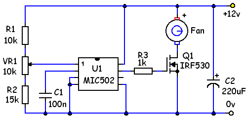

Wow man. I can't believe you went that far to get a temp controlled fan. Look up MIC502 PWM fan controller. I use them all the time. I still have a few of the MIC chips left for various other projects.
I first used them to make a TEC controller for a desktop mini fridge. Only after succeeding in that task I decided to try a few as they were intended. Surprise, they work great for controlling PC fans also.
Just add the proper thermistor network and you are GTG.😉
EDIT:
It should be noted. That schematic is crap. It is not mine. I'm not sure where I found it. That would probably work but I would inclined to use a few diodes and an appropriate inductor to keep from frying the fet/power transistor and to make sure the fan doesn't make funny noises at low RPM.
