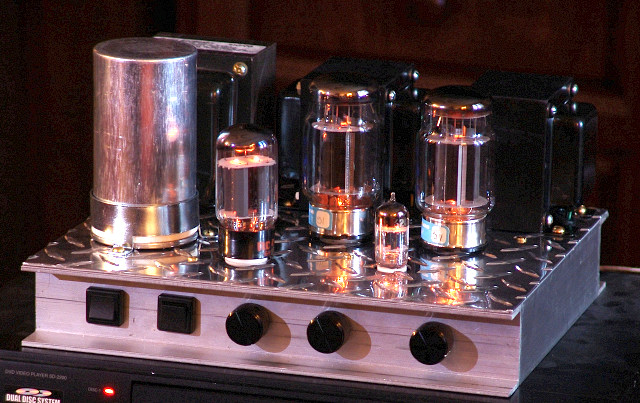

And for the purposes of staying on-topic, I'm trying to figure out how to lay out my next amp using 1/4" to 3/8" aluminum. I have a friend with a milling machine who's willing to let me have a go at fabricating a top plate (I'm a pretty fair amateur machinist), but I need to get the particulars worked out first. It's not easy planning for a multitude of countersunk/counterbored bolts, patterned cooling holes and strategic thinning around the tube sockets. Heck, I might just even go stainless for that matter.

I've always used 3/8" aluminum. For the size we build that is plenty thick and ridged. Your friend should be able to walk you through the process.

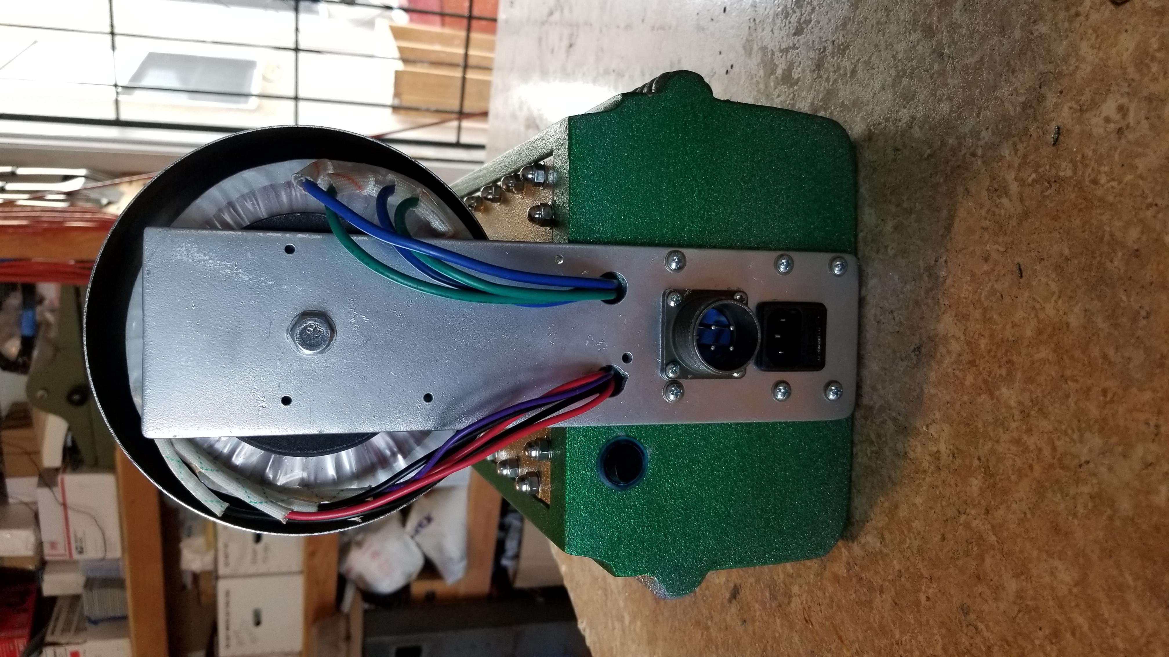

Is that a vertically-mounted Antek toroidal transformer? I did the same thing on a pair of monoblocks two or three years ago. Worked great!

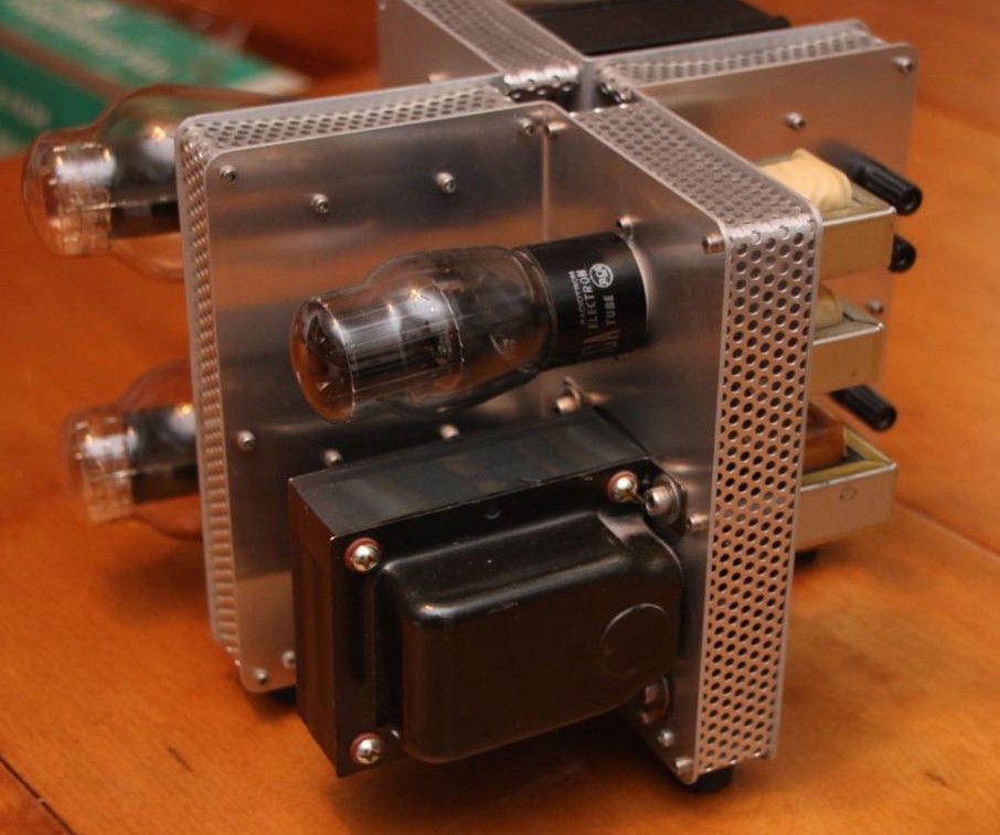

you could use 2 of them.
My first thought was that it would be a rather large amp. Then after dreaming on it last night, I thought that it might be cool to place the two "chassis" vertically with the "eating sides" together with the tubes and transformers sticking out in a horizontally opposed arrangement, like a BMW motorcycle or Subaru car engine.
Signal one one and power on the other.
The next part of the dream has me building two similar looking but different complete amps, one on each chassis. Each fed by the same guitar, and meeting in the middle where the "preamp" meets the "power amp" where blend and balance controls would be.
One "preamp" would do the "clean" guitar sound with its own tone controls, while the other does the "cranked" sounds. The blend / balance part routes a different mix of each sound to two power amps, and to two separate speakers.
I'm leaning toward this plan, which makes life a bit easier since each amp can be built individually, then joined.

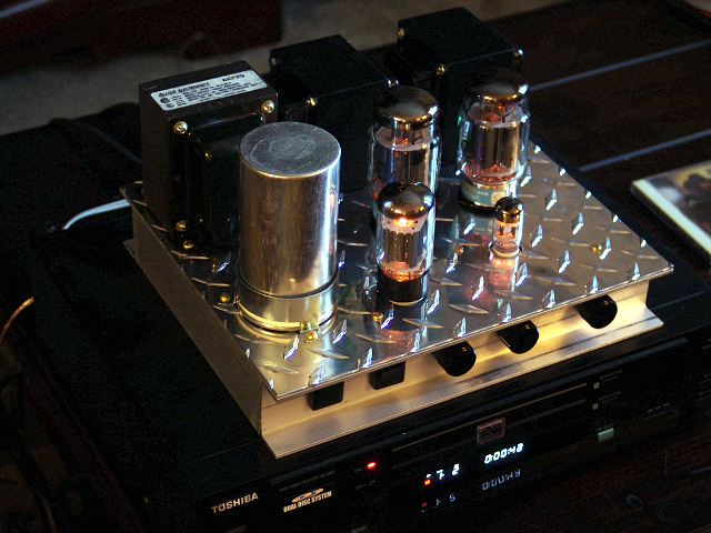

For safety you could "wrap the gap" created by the spacers with a strip of perforated aluminum (like the fi-X amp pictured below in a file stolen shamelessly off of the web). Just a thought, since you've mentioned in previous posts that you might have some curious youngsters about.

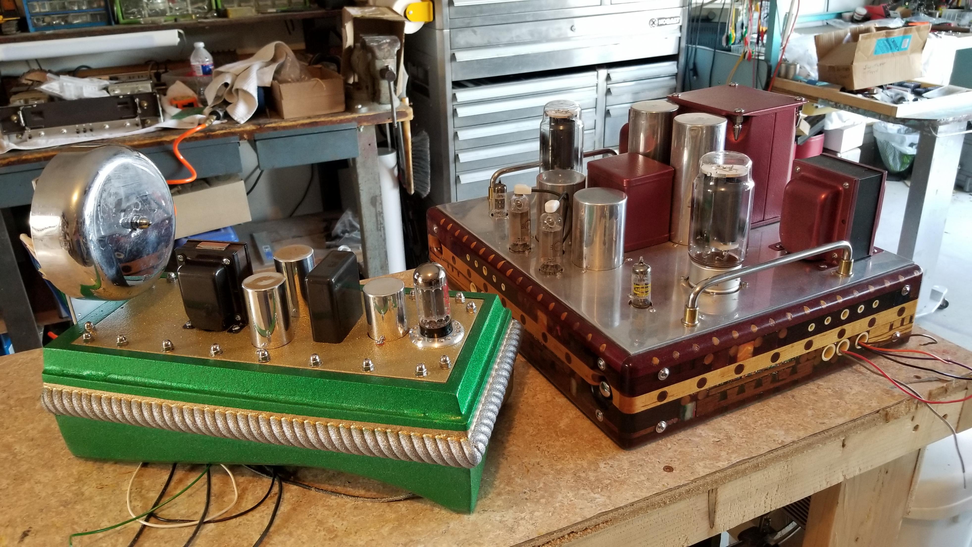

That was my thought. The strip in the front would be solid, and used to mount the pots and switches. Ditto the rear for power, speaker, and pedal board jacks.
I think I still have some of the aluminum channel and diamond plate left over from building the metal SSE, which was glued together with JB Weld, and came a bit "unglued" when it got dropped during a house move. I'll put it back right some day, but even its current (out of) shape, it still works.
I saw one of those a long time ago at a house next door to my brother. This guy had several expensive amps, and a few years later he would buy two TSE's from me, back when I built completed amps for sale.
