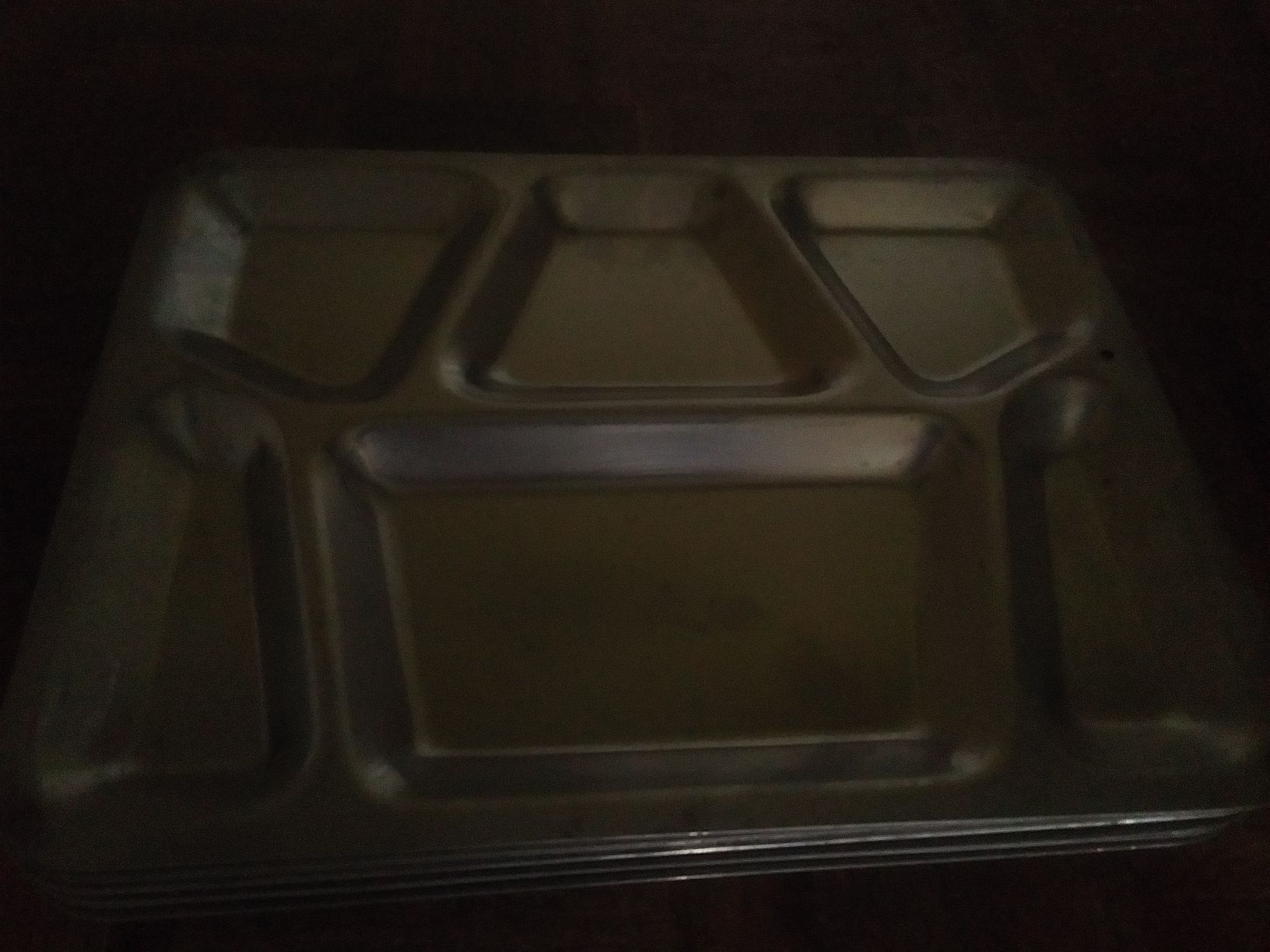

When I started this post today, there were 6 trays available. Now they are all sold out. Maybe I started a new trend.

Cake pans are available in a wide variety of sizes. Just do a search for the size you want.That would be cool to find a cake pan with the same outside measurements.
They are also much more practical in that the divisions in the tray you pictured would make it very difficult to place parts and run wiring. A regular rectangular or square pan, like you would use to bake brownies, would work much better.
I have used cake pans, street signs, Lexan, kitchen countertops, and other random pieces of free or cheap material for amp chassis and top plates. They work but just look traditional or boring. I have made too many amps like this in my life.
One of my favorite oddball amps was made on a piece cut from a mangled hurricane protection panel found in the street after the storm had passed. The tubes were sticking out at opposing angles, making it easy to call this amp the "V6." I didn't have it long before someone bought it on looks alone. A V8 was planned but the hurricane season was over so the Home Depot stores did not restock the panels.
I did buy one of the mess hall trays and will attempt to use it for a guitar amp featuring all metal tubes. The turning point for me will be in how easy it is to drill and punch holes in it. Stainless is notoriously finicky in this respect, and the reason I usually avoid it. It doesn't like paint either.
If it works out, it will be "different." Which is the reason for the metal tubes......Getting a big box full for free didn't hurt either. There were 8 nice metal 6V6's in that box and all have been tested to 30 WPC in a HiFi amp. This one will be lower powered, but stereo, with dissimilar channels, if I can make it all fit.

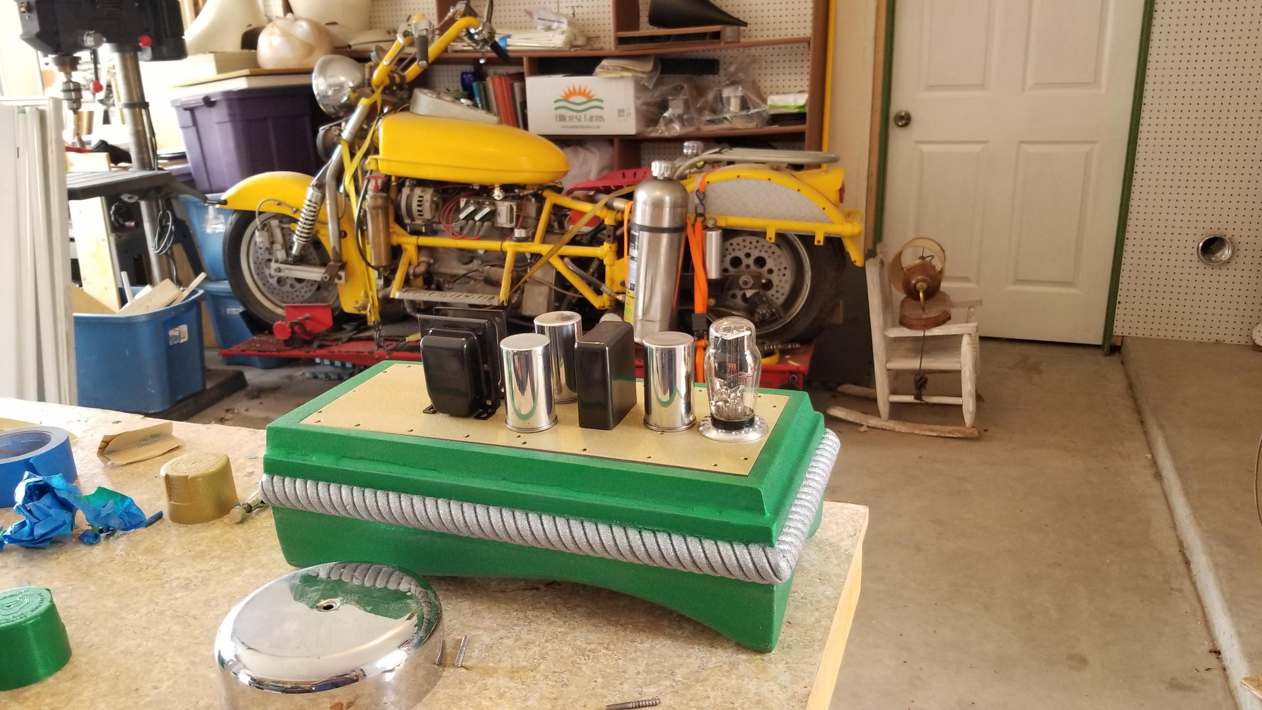

Here is the power supply I am working on now. I will start the assembly Friday after the clear coat dries.

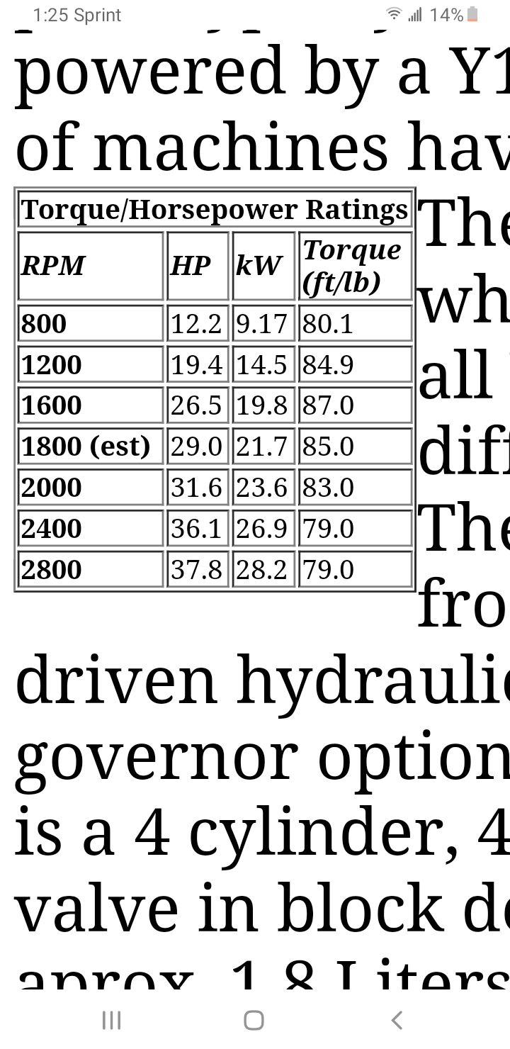

That little green power supply might put out a few hundred watts......that big yellow one is good for a bunch of kilowatts for sure.......1 HP = 746 watts.
90 HP for a 4 cyl flattie is pretty good. The universal Atomic Fours found in old sailboats made 30 HP with 4 cylinders ( I rebuilt a few many years ago), while my first car (also a flattie) needed 6 cylinders for 97 HP.
