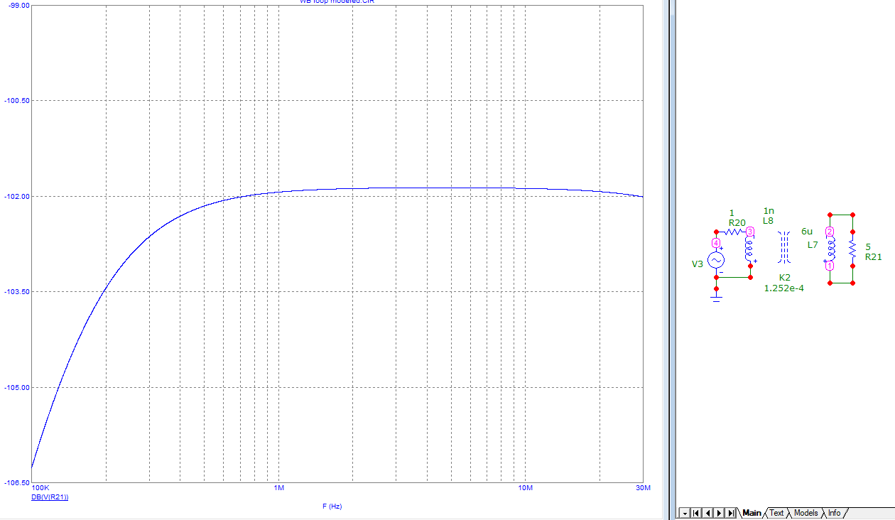

With a low noise low input impedance preamp, the loop can be wideband. Comparison of performance is possible via simulation, loop only (using low impedance, 5R) is rather flat.
