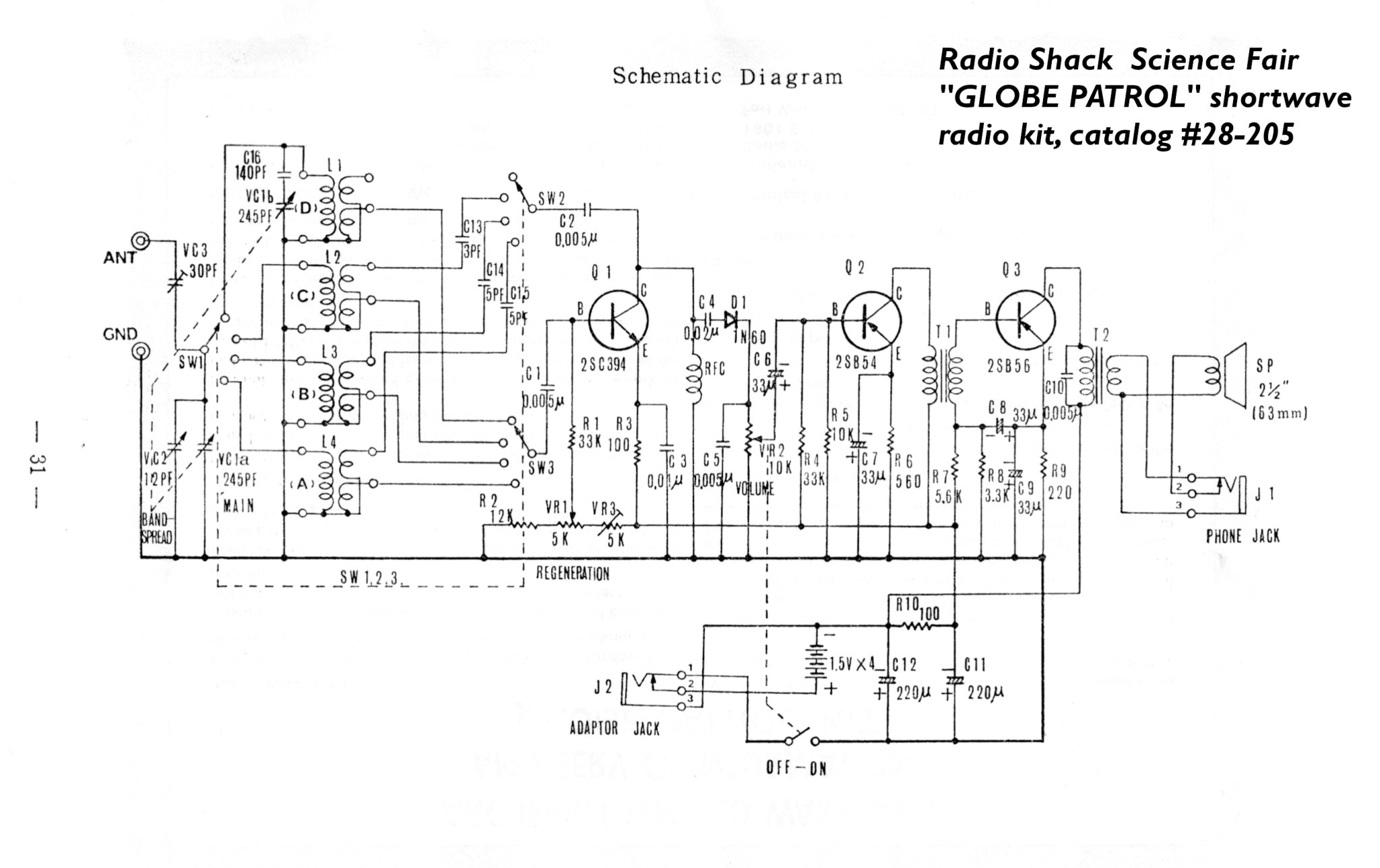

I own a shortwave receiver (bought from Radio Shack) I built back in the late 70s from a kit, a Science Fair "Globe Patrol". It still works(!) but not well: for an antenna I'm using a @22ft piece of 18 gauge wire strung up on my room's walls, and tuning is very erratic/unpredictable and just placing my hand near the metal face plate causes major static issues. I am very sure this is occurring because it requires an external ground & living in an apartment I am not able to install a 4ft copper rod into the soil outside my window as I did 40+ years ago, so I cannot provide it with that.
Is there any way to convert this radio to an internal ground system, like so many portable SW radios use? I've uploaded a scan of the radio's schematic to aid with this. FYI: electronics-wise, I never progressed past building simple gear like this, so hopefully I have the skills to undertake such a conversion (if it's even possible).
What's happening with the static is your body is acting like the other end a capacitively coupled dipole antenna, thus increasing the radio's RF sensitivity as you adjust the coupling. You get background static because there is more resulting RF signal strength.
If not a dipole as Marcel suggested, you could also try grounding the radio to a cold water pipe, or to AC power ground, say, through the screw that holds an AC outlet cover on.
Whatever you do, the radio antenna/ground system you set up will be sensitive to frequency and to arrival direction of radio signals you are trying to pick up. Therefore moving the antenna around and or adjusting its length may help with pick up of particular stations.

From the circuit diagram this is a regenerative (i.e. not a heterodyne type with an IF) receiver. It should be adjusted close to self-oscillation with VR1, where sensitivity is at maximum. When you overadjust it, it will function as a RF transmitter. No wonder this type is not produced any more (perhaps against to FCC rules, too).
There is a tremendous amount of RF noise in most buildings. Switching power supplies, motors and many other sources. A large loop antenna can reject much of it. Try winding about 10 turns of wire around a couple if crossed wooden supports and connect to the ground and antenna terminals. Two yardsticks or something similar could be used. Such antennas do have sharp directivity nulls and can be used to reject inteferrers. You will just have to experiment with tuning and positioning to get best performance. Once tuned to a station such antennas can perform surprisingly well. This radio is simple conceptually, but take quite a bit of finesse to bring in stations. They can be very sensitive and high performance. They were meant to encourage expirimentation. Search loop antennas to get more ideas. Have fun!

Thanks for the explanation. The AC power ground method sounds interesting (if a bit ominous! :unsure:), though the screws here are painted - have to dig up some sandpaper first......
Yes, the instruction manual says that it uses a regenerative circuit.
RF noise: yep! Recently I walked around with my Sony ICF-P36 portable switched to the AM band, and placed it near various electrical devices. WOW. LED bulbs were among the worst, along with phone chargers. But the worst offenders by far were a 42" flatscreen TV and its accompanying Polk Audio soundbar - especially the latter, which generated eerie noises like something heard in a sci-fi movie. On the other hand, my Pioneer A/V receiver was pretty much silent, despite all its processing chips and large power supply (no surprise here though, since such a device needs to be electrically quiet).
That antenna sounds easy to assemble (and that's a good thing since I'm on a budget) - thanks for the suggestion.
