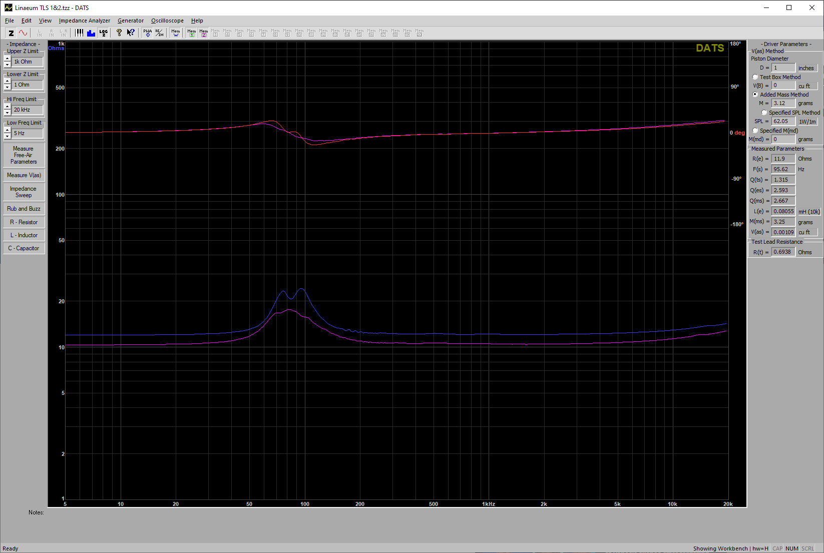

TLS #1:
Re = 11.9 Ohms
Fs = 95.62 Hz
Qts = 1.315
Qes = 2.593
Qms = 2.667
Le = 0.08055 mH
Mms = 3.25 gm
Vas = 0.00109 cu ft
TLS#2:
Re = 10.26 Ohms
Fs = 82.03 Hz
Qts = 1.002
Qes = 2.413
Qms = 1.715
Le = 0.07817 mH
Mms = 3.442
Vas = 0.00139 cu ft
I am not surprised these are somewhat different - I think they are essentially hand made. Are these differences going to be critical for the crossover design?
Question on the Dayton Audio DATS V3 that I used to measure these - I had to put in a "Piston Diameter" so I used 1 since that is a typical tweeter. Is this going to affect the data?
A bit difference between these was that with TLS#1, I only had to add 1.84gm of added mass, while TLS#2 I had to add 4.57gm in order to shift the Fs by at least 25%. I wonder why this is? Maybe the magnets in TLS#2 are stronger?

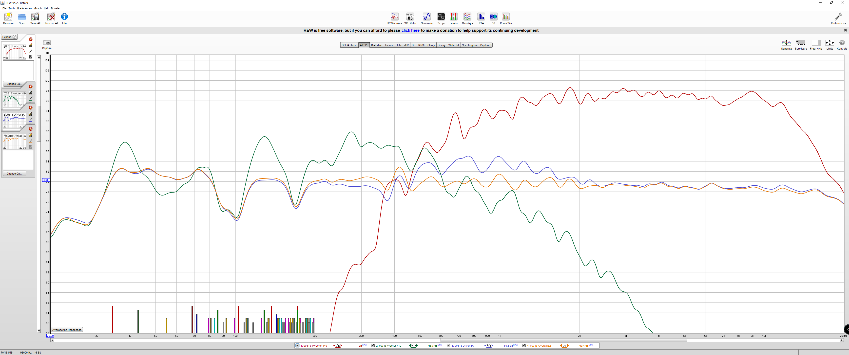

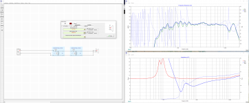

I think I only know enough to be dangerous. Here's what I've got. Should the response curve be the actual raw measurement of the tweeter? Or is this response measured in REW with the active crossover what I want to use?
I just stuck two second order circuit blocks together in series ... oh- the first one was set to 8 ohms. I changed it to 12.33 ohm because that is the approximate impedance of the raw tweeter as displayed in XSim - though this is different than what DATS was reporting for this driver, which is 10.26 ohms.

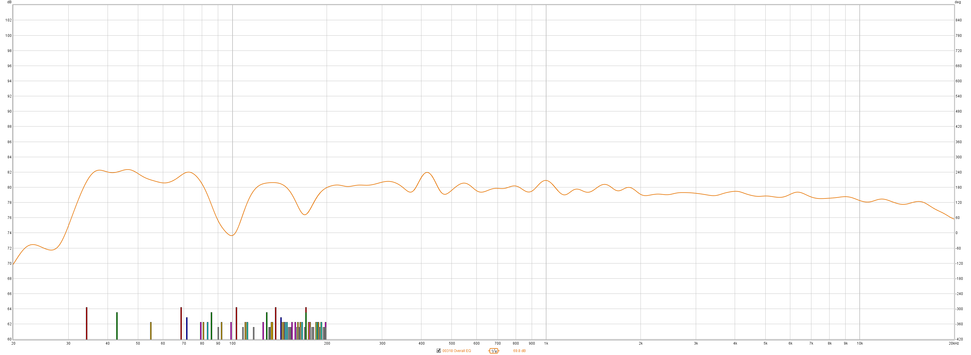

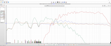

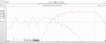

The active crossover is giving me as close to exactly response as I could want. So, it is supremely optimized, as much as is possible. It has essentially flattened all the peaks and rises in each of the drivers response - and then there is an overall PEQ filter applied to the system, which flattens the summed response.

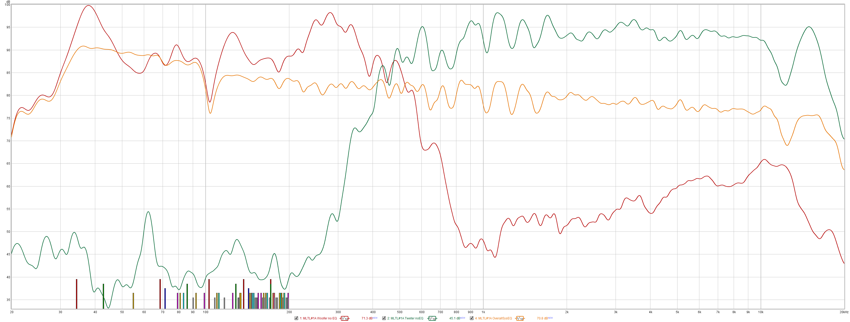

So, the challenge is this - I do not think it is possible to match that precise and focused custom response control, in the analog domain. And certainly I won't be able to do that. Here's the raw drivers on the the crossover, and then the fully EQ'd system.
Actually this is the first version - it had the crossover on the tweeter at 440Hz, and I moved it up to 480Hz, to reduce the rise at the summed crossover point. And I reduced the "room curve" at the bass - this was +1dB/octave below 200Hz, and I have lowered that to 0.7dB/octave. And I have pulled the speakers out into the room ~6" - and added eggcrate foam to the last segment of the MLTL. I will remeasure things soon.
The sharp dip at ~106Hz is a room cancellation, that doesn't occur in the nearfield measurements. I also confirmed that it is a room issue, by putting one of the speakers near the middle of the room, up on a 2' high table and measured the response. It had a completely different set of dips and peaks.
Case in point on my skepticism on being able to get the fine custom control - the tweeter has at least 11 narrow peaks and broad rises that have been truncated. many of them, the SPL decrease is unique. And the dips have been specifically lifted a bit - the most important of which the drop at 10kHz is pushed up to 11kHz, and the dip at 13kHz is lifted maybe 3dB and the response at 20KHz is12dB down instead of 20+.
So, my goal is to do the best analog crossover that I can manage. I think that means starting with what I know about the crossover frequencies and slopes - and then doing the most possible EQ'ing with the least complicated additional components. I have my target response - and the learning curve is steep.

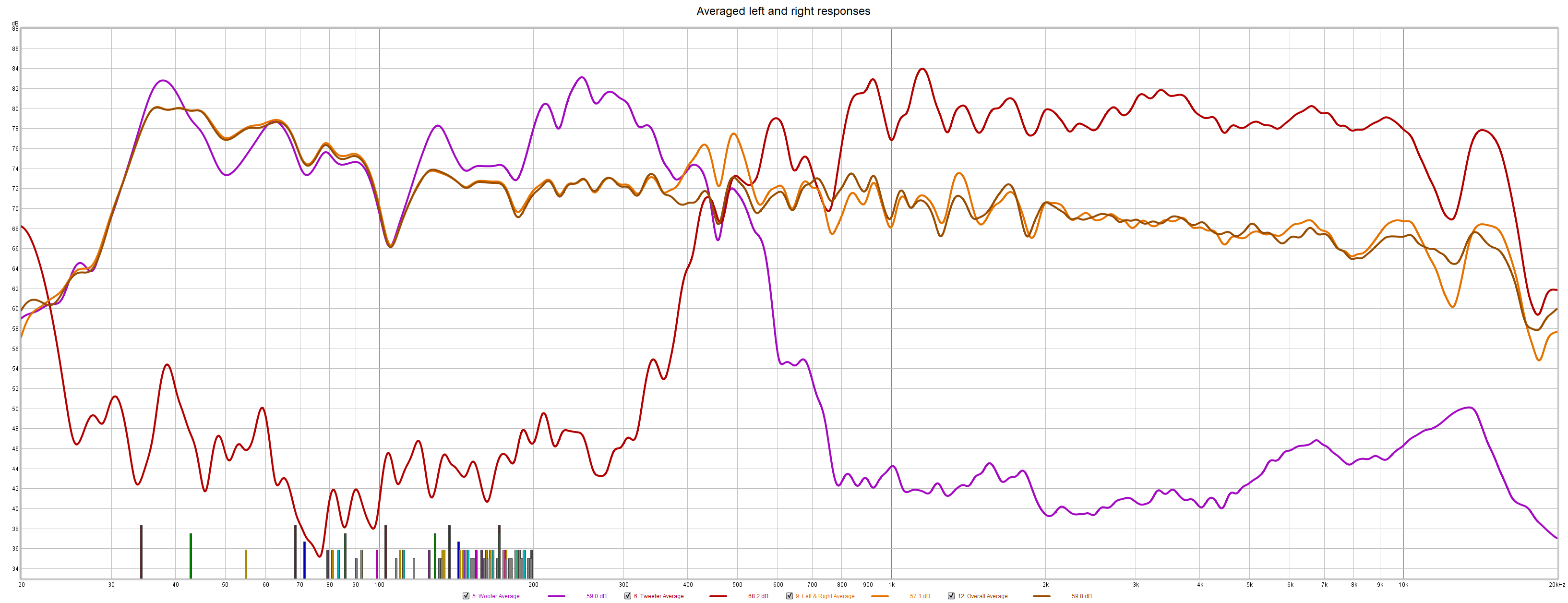

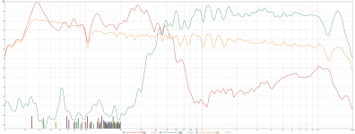

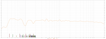

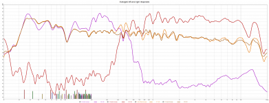

Of course, I found the later measurements I did of both the left and right speakers (the above is just the left speaker). These are the averaged raw woofer responses, and the averaged raw tweeter responses, the averaged left and right response with just the driver PEQ - and the averaged left and right response also with the system PEQ. (But this is with the +1dB/octave on the bass, and without the eggcrate foam, and the current speaker positions).
The overall response is smoother and more even. This is a very high bar, I think, to aim for with an analog crossover.

Unless I'm mistaken, you are wanting the crossing and the equalising to done by the passive components?
Can you do 7 plots. Either post separate plots so we can trace them or do frd and zma.
Woofer impedance, raw response, after cross, Tweeter impedance, raw response, after cross and total response.. like shown above only on separate screenshots, with scale visible and zoomed around +3/-30dB.
