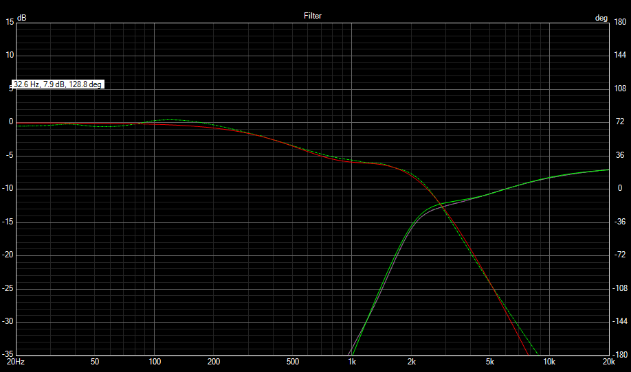

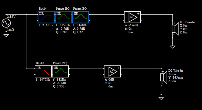

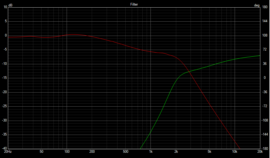

Just right click on most any plot line in VituixCAD, then "save selected as overlay". For example, here is a filter transfer function for a basic 2-way speaker:
With that transfer function saved as an overlay, I simply insert active filter blocks and attempt to reproduce it. I spent 5 minutes and got in the ballpark with only a couple blocks. These parameters can either be copied directly over to the DSP software, or right click on each block and "copy biquad coefficients" to grab the biquad values directly as plain text.
Dcibel it seems your way might be a really simple way for me to laern Vituixcad and simultaneously model the passive crossover. Unfrotunately your link isn't working and I can't put two and two together comparing the passice crossover and the Biquad examples you shown below.
I right clicked and saved all as overlay but nothing happened. What do I do then? If I understood correctly, I am using the passive crossover to use as a model and adding biquads instead of the crossover components after I saved as overlay then chossing Hypex DSP in options and making a new schematic?

It doesn't show you the response that you hear, it shows you the response of the filter. You are measuring the voltage, not the impedance. This is all you need to know to make another filter which matches it.
You need to run the sweep with the crossover in place.
