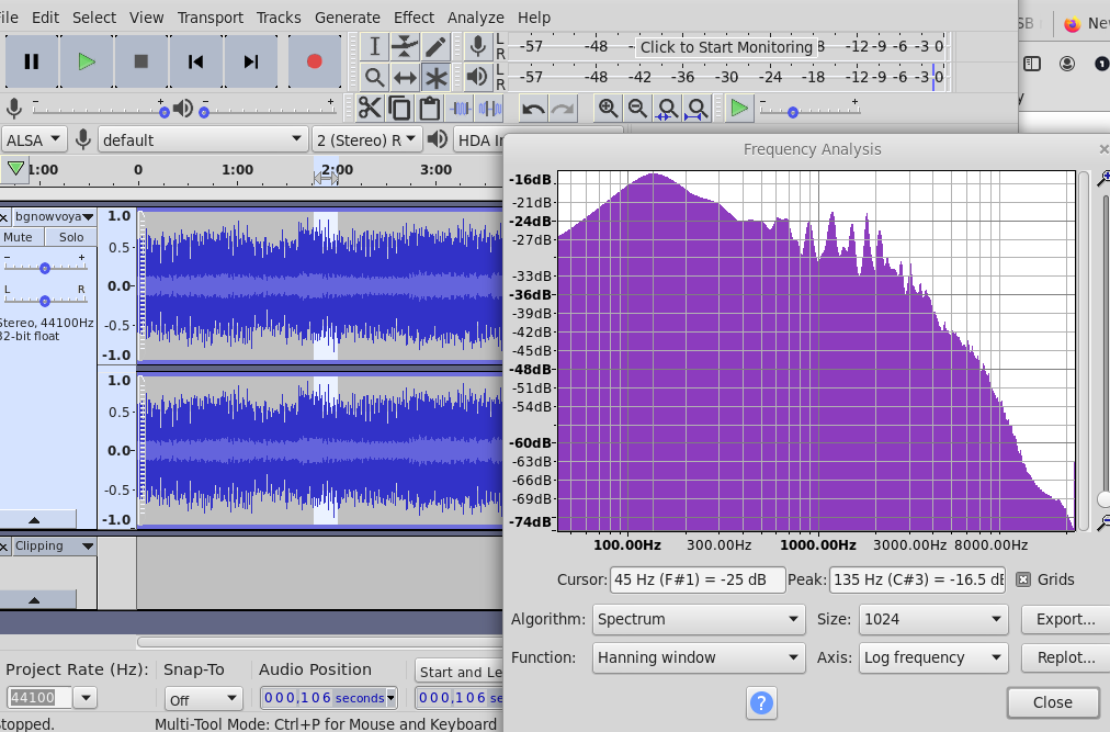

The above pictures apply to "Oye Como Va" by Carlos Santana, converted from a cassette to CD.
The clipping was from the tape I got converted by a friend from cassette tape to CD. I guess he had the recording levels wrong. I get another chance now.
Bob, to avoid clipping is it enough to use the Audacity 'show clipping' feature and adjust accordingly?

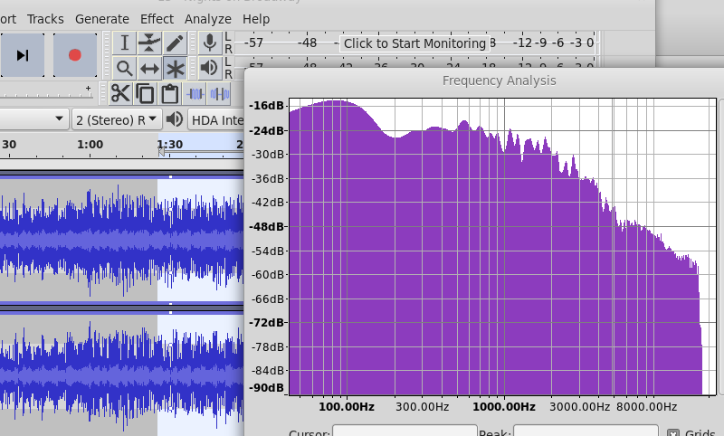

I have decided against hosting even a short clip of the recording, however I am posting a spectral analysis of a short clip, which tells its story. For comparison, a spectral analysis of another file, an .ogg file, from Track 2 of the Bee Gees "Main Course" album. High end is lacking, and it can be boosted satisfactorily with bass and treble. I will look at equalization after playing through my desktop system.

After getting an input signal I adjusted levels to reduce clipping to one or two rare occasions in the song. I played the entire tape through, stopping a tape mid way causes problems for the tape as I have found in the past, and recorded a large clip of several megabytes in .wav format.
I was surprised by the result. The tape played without any detectable wow and flutter, and as I recall at the correct speed. This I can check against the YouTube version. It was all there, the music from 36 years ago, I had occasionally listened to this tape in its highly muffled form a few years ago, but nothing like this. Definitely recoverable. CrO2 tape, it is, one of the first I think, and was played over 1,000 times at least.
The quality is acceptable, now if I can only get the USB connection working...
