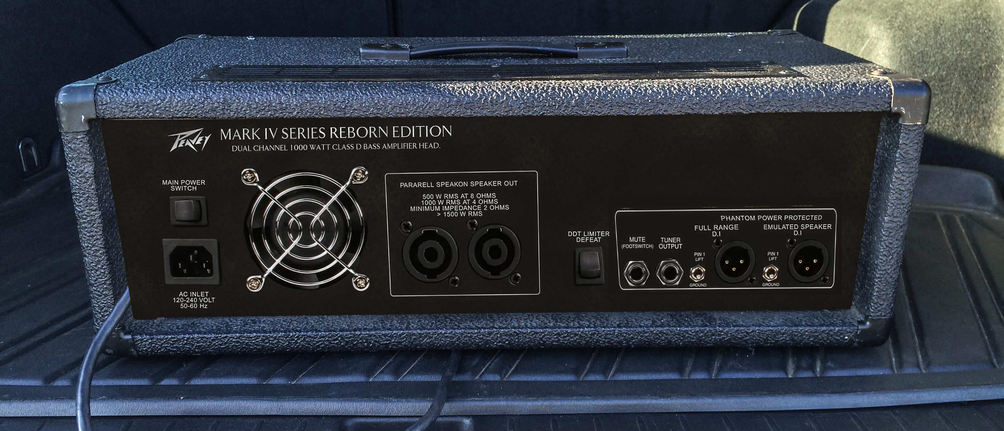

... i was thinking in a way to replace the 400BH power amplifier of this baby and put a D class amp board and integrate all in the bass head chassis.
Hi Julian,
of course, this is easy to do. )If you like I can answer in Spanish also).
Actually I am doing something similar at this moment.
Not considering the arguments down this thread, it is quite easy and the total cost would be about 150 USD for the components.
You can use the complete input processing (EQ etc.) and just remove the power supply and the power amp.
The most compĺex issue is to provide good cooling (fan and air channels) for the baby.
Tell me if you need more info or if you already managed to finish your project!
