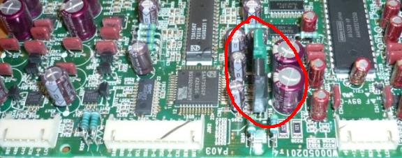

about regulators? If the regulators are on the PSU board - that's makes things very easy
Yes I think it does have regulators, see the pic below, they are D1762 and D1105. Can't I just measure off what voltages come off the main board and then recreate them? Does the presence of regulaters mean I can give it one voltage?
I didn't notice them before. Yes - measure the voltages going into the DAC PCB and comiing out of the PSU PCB. If they match - then there is nothing happening in between and you can probably use the existing PSU.

Originally posted by harrygrey382 I've measure the voltages, at PSU there is a multipin plug. Out of a number of choices, there is +12, -12, 5 and GND. The 12s measure 15V, the 5 measures 10V. At the DAC baord input, the pin marked 5 measures 5V, the pin marked 12 measures 12V. So I suppose there's some regulating going on somewhere.
I assume that the PSU plugs into the main board.....then the main board has a cable that plugs into the DAC board. This, with the values you reported above, suggest that there are regulators on the main board. If this is the case - maybe you should consider retaining the main board (if it is not too big).
