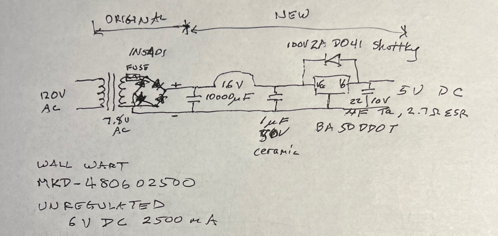

Here's my parts list along with questions:
1) Filter cap: limited by size constraints. I have 2 choices, a 8100µF 25V or a 10000µF 16V (EKYC160ELL103MM25S) Al electrolytic. I am guessing that a higher voltage rating will lend itself to a longer lifetime. I am leaning to the 10000µF one because it will reduce the ripple voltage by 20% into the regulator. Comments?
2) Regulator: BA50DD0T 2A, LDO model. Will get a TO-220 small Al heat sink. Question - should I ground the heat sink or leave it floating since nothing is actually electrically connected to it?
3) Input cap: It will be soldered very near the regulator The application notes say minimum .33µF. I have a choice between a .33 and a 1µF, 50V ceramic (C420C105K5R5TA91707200). Question: Why shouldnt I use the 1µF cap? Size is about the same.
4) Output cap: For stability I choose around a 2 ohm ESR. Ta capacitor, 22µF, 10V, 2.7 ohm ESR (TAP226K010CCS). Its only 50 cents more than an Al.
5) Diode to prevent surge when unplugged: This one I do need some help. The choice is small for axial didoes. A 1N5401 diode has a leakage current of 5µA and a Vf=1V. Dont know if this will work. Shottky diode I found one with .5µA leakage and Vf=.85V. I read that Shottky diodes are not as robust as regular diodes, so I would prefer a 1N5401 if it could work. Comments?

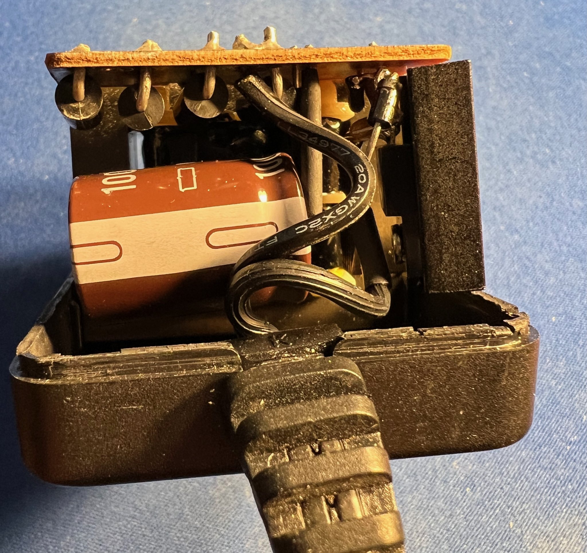

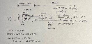

OK. Assembled and tested. Worked great! Exactly 5V out, with my load (Wiim Pro Plus) didnt get hot.
Since no one responded to my questions, this is what I decided to gte:

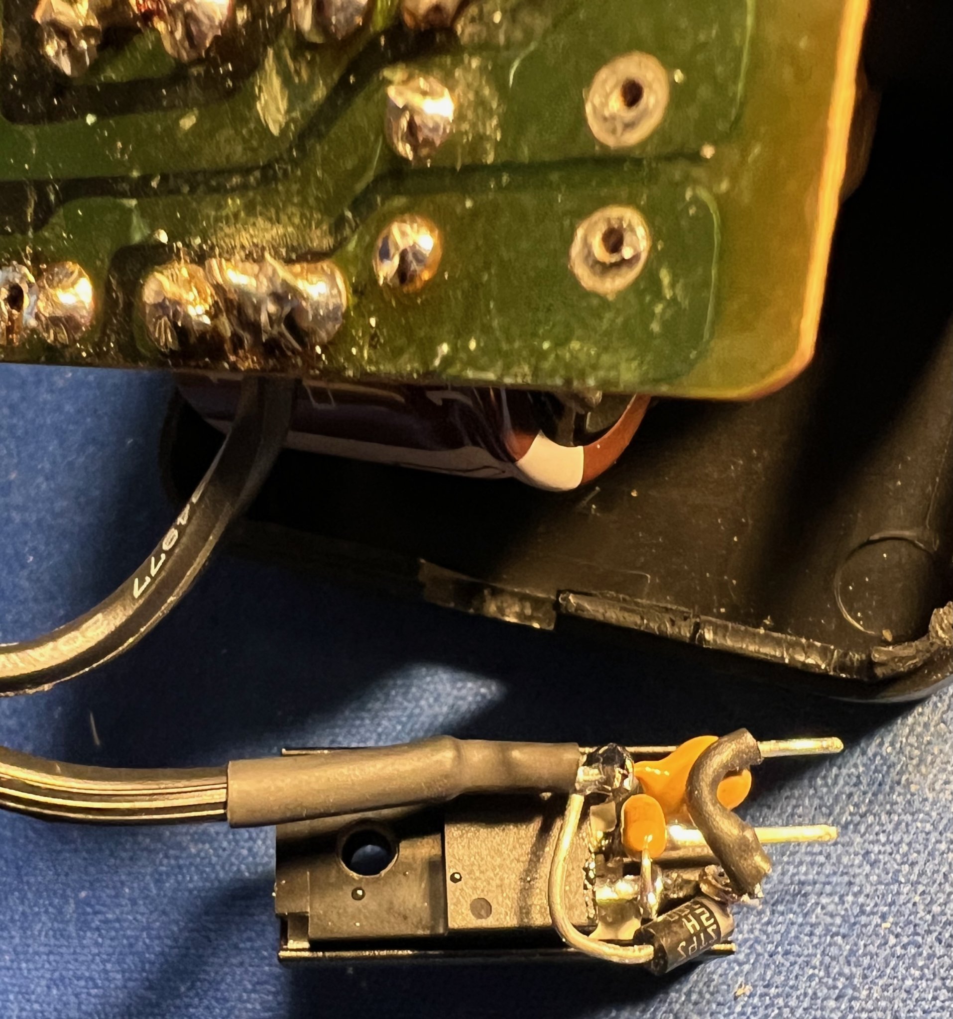

1. 10000 µF 16V cap. Its pretty big, so it was about 1.5" away from the regulator so
2. 1µF ceramic cap near regulator
3. BA50DD0T 2A, LDO with 4W TO-220 heat sink. Turns out that thermal considerations were a limiting factor in that I could only fit a small heat sink. 1.5A x (7.3-5V) = 3.5W That means with just convection, it will reach 120 °C max, which is just below the 150°C thermal limit. Custom enclosures can use custom heat sinks.

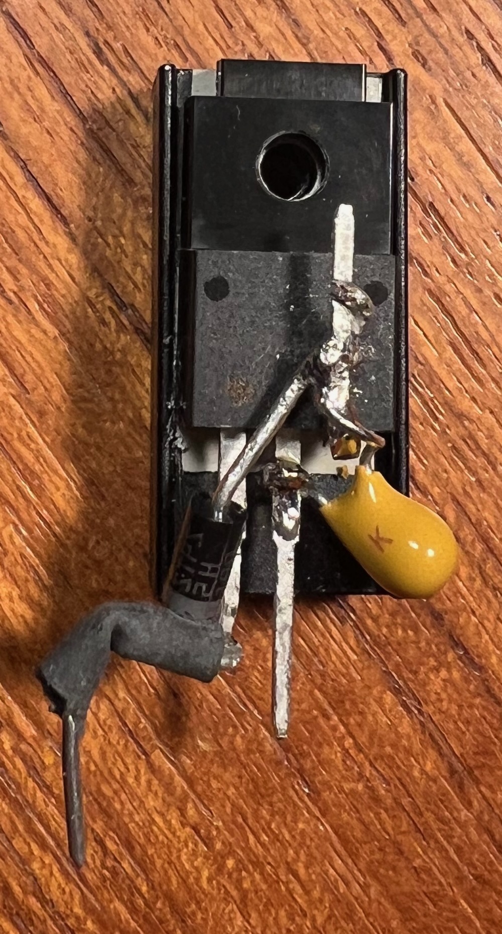

4. i connected the Schottky and antioscillation 22µF cap directly to the pins of the regulator since I ran out of places on the circuit board.

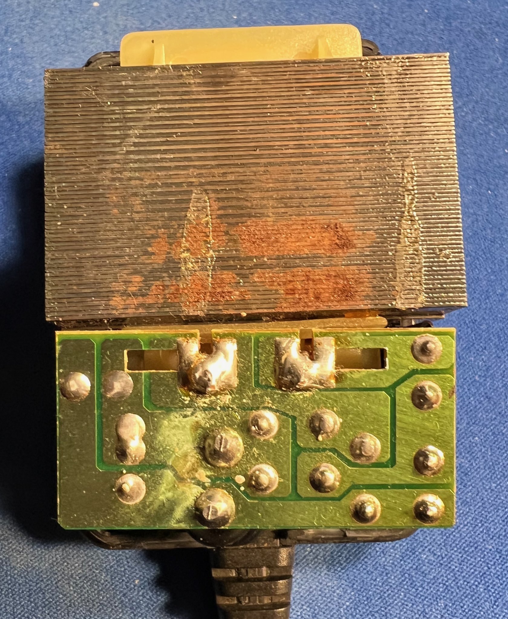

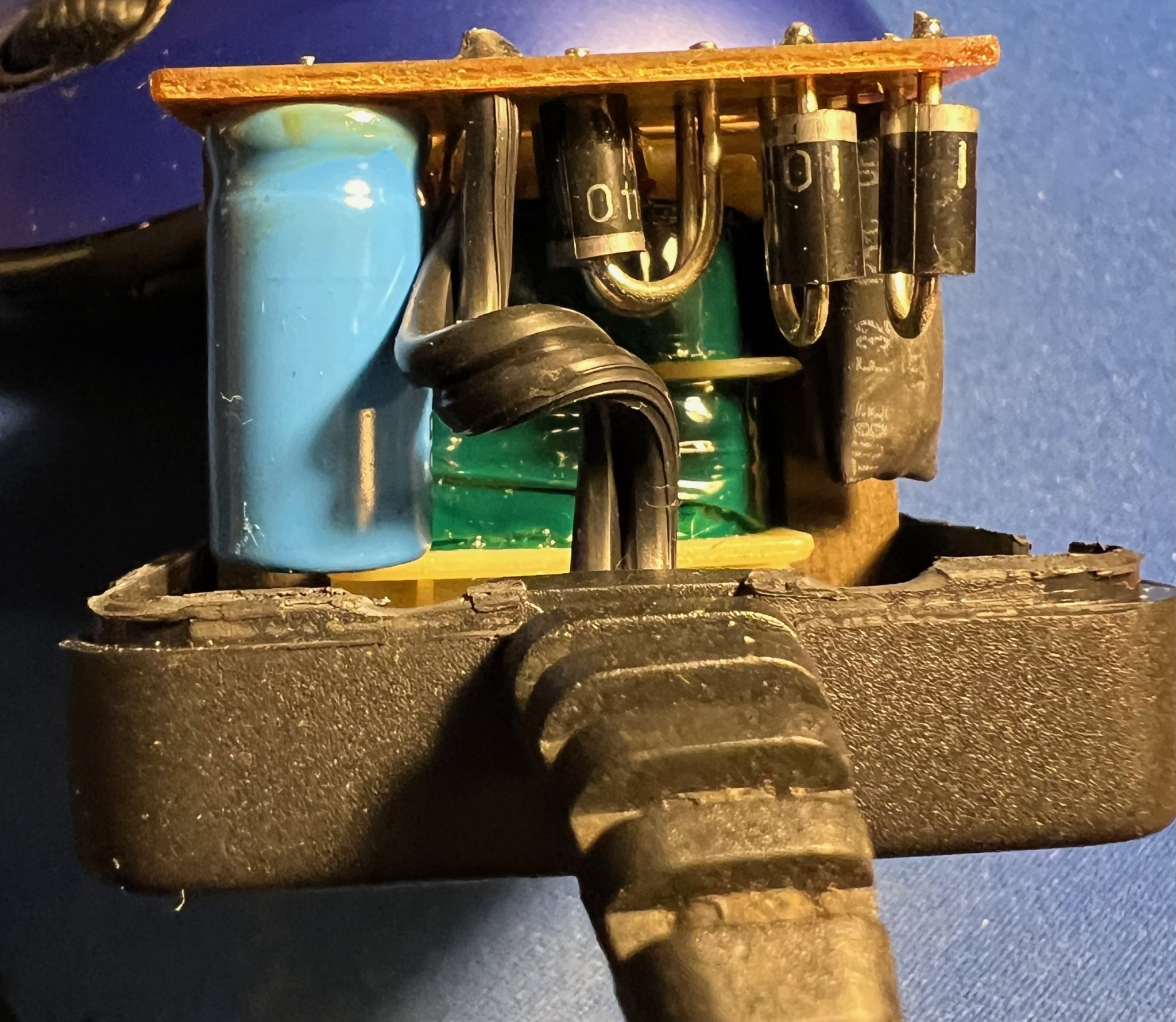

Pictures attached, first 2 are the original wall wart - the cap was leaking.
Next pic is the regulator with the diode and cap soldered to the pins. (Waiting for the M3 screw to be delivered)

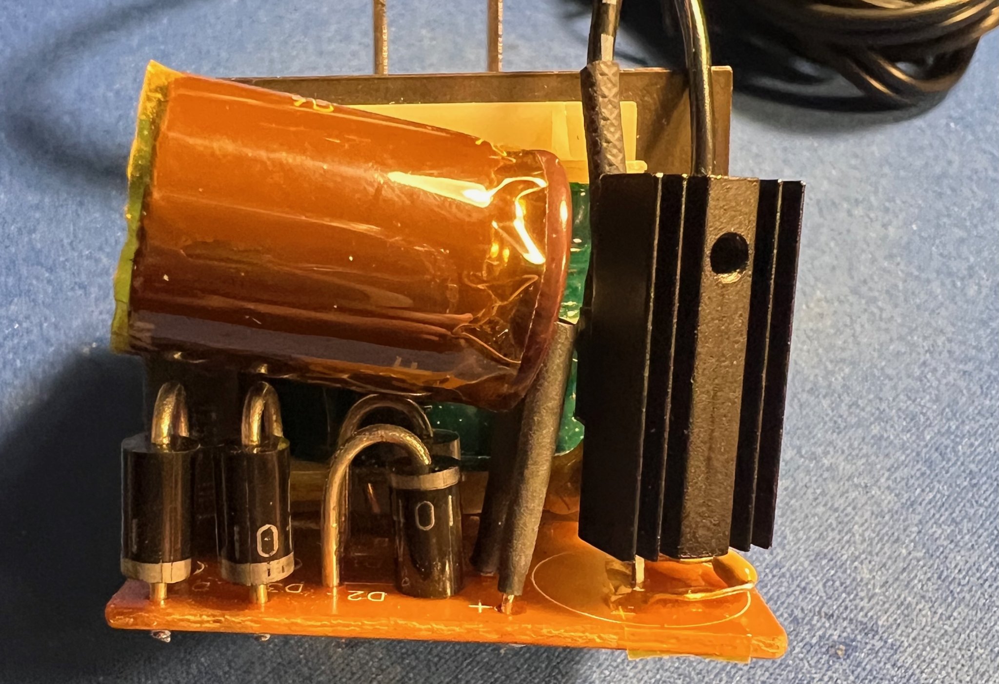

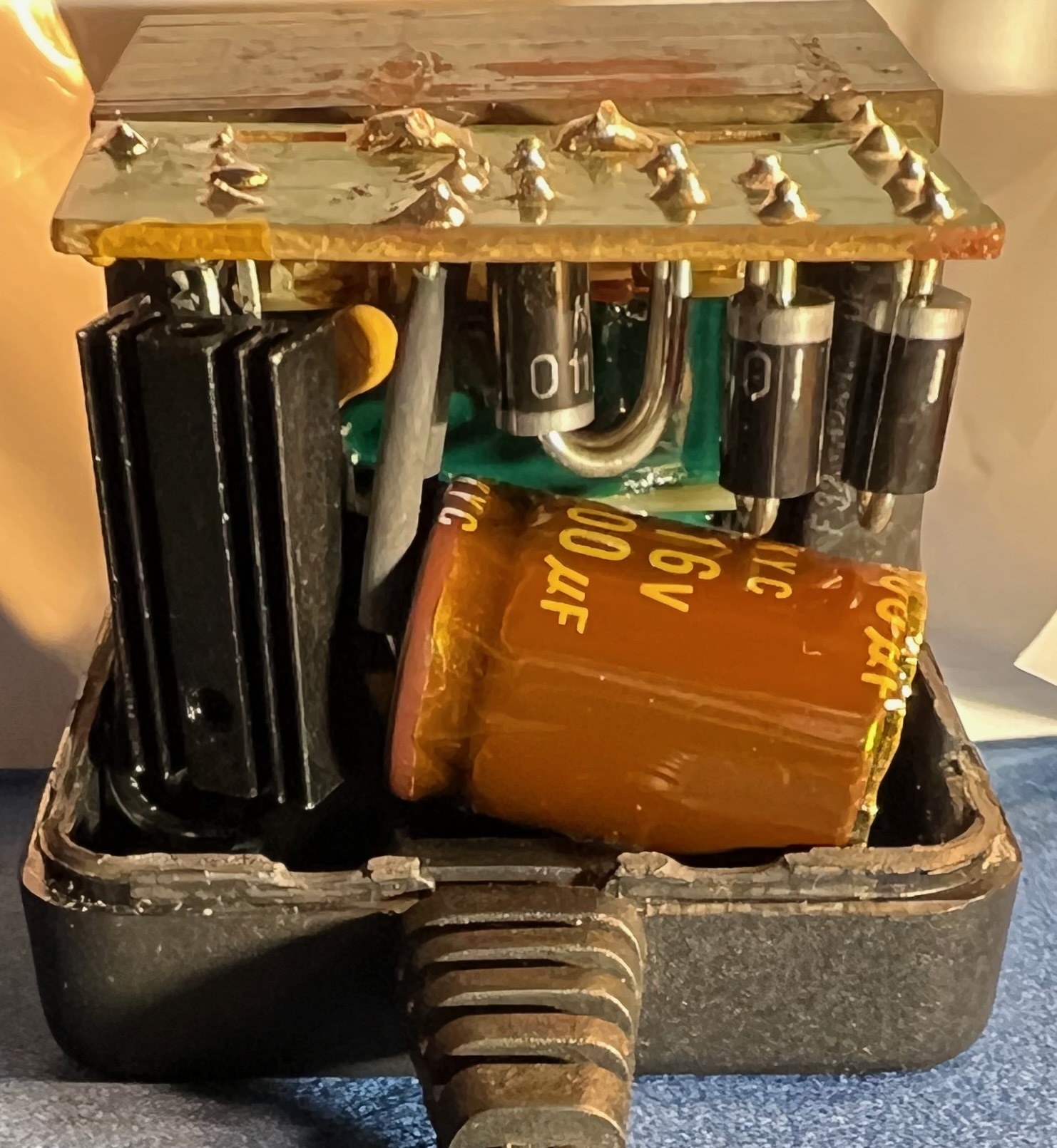

Last 2 pics are the reassembled board. This started out as a 6V, 2.5A wall wart, unregulated

3) you can use bigger than 0.33. In the datasheet they mention the minimum for stability. Choice of ceramic is ideal so 1uF is perfect.
I was looking next if if was possible to use the 5V wall wart, and discovered an error in my calculation:
Vsecondary transformer= (Vout+Vreg+Vrect+Vripple)/.92 x (Vmain/Vmainmin) x .707
= (5 + .7 (LDO BAxxd0) + (4 x .7) + .62)/.92 x (120/112.8) x .707
The error is the forward voltage drop in the rectifier. Since the current only goes thru 2 diodes each wave, it should be 2x not 4. Also the forward voltage drop I used was nominal, and for a 1N5401, it is listed as 1.2V in the data sheet. So the corrected number is 7.1V min for the AC voltage required, which makes it even better, as the 6V wall wart had a 7.8V AC voltage.
Now, the 5V wall wart has a AC voltage of 6.2V <7.1V so this wont work.
I discovered that there are Schottky rectifiers, like the 31DQ04 with a voltage drop of .5V. So using this I get a secondary V requirement of 6.0V vs 6.2V Secondary, so this should work. If the transformer was centered tapped, I could lower this to 5.6V, but the wall wart is not center tapped. As far as I read, Schottly rectifiers dont have high peak reverse voltage, but that is fine for this application. It also has a higher leakage current mA vs µA with 1N5401. Given that this is a 1.5A, 1500x lower should be OK. Since I have the 5V wall wart already, I am going to give this a try as well. More learning!

Update with the 5V 2A wall wart - it works! I replaced the 4 1N5401 bridge rectifiers with a Schottky rectifier because the voltage drop was much less, which lowered the secondary voltage requirement by .5V! This along with the LDO regulator allowed me to be able to use the 6.2V AC from the transformer with room to spare (5.65V). Or it can live with a line voltage down to 101V AC. The cost was an additional $2.40 for the diodes, so whichever you can find, a 5V or 6V 2A wall wart, it would work. The one advantage of the 5V wall wart is that the heat dissipated from the regulator should be lower. Again, first picture is before the mod and the remaining pictures are of the mod. I had to put most of the new parts on the regulator because there was a shortage of thru holes on the PC board.
