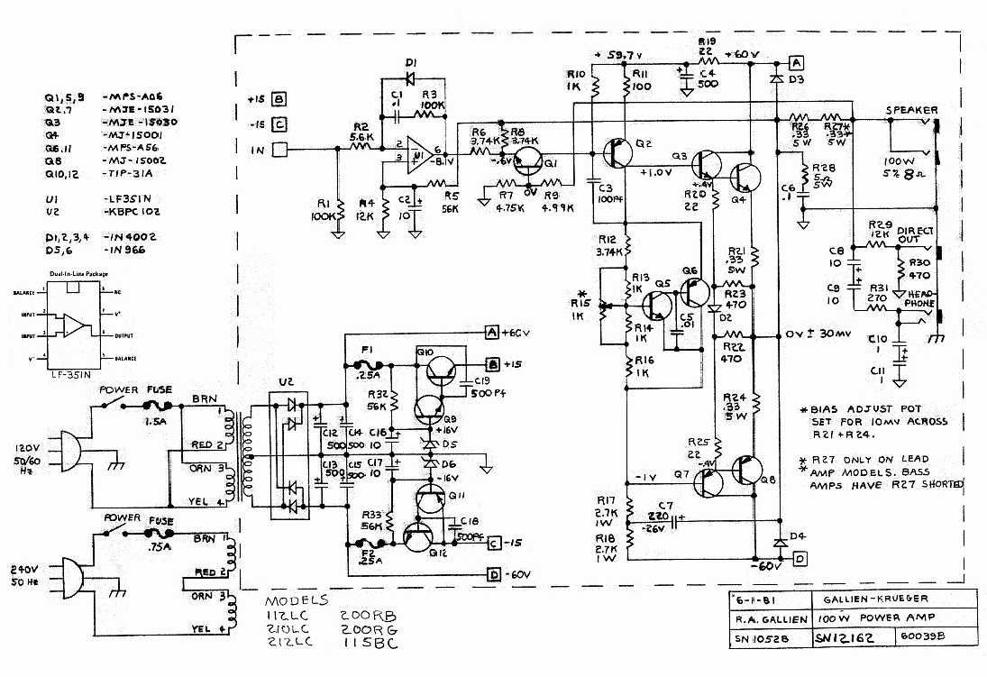

Interesting project. I have the GK 200RG head. I have an issue with the power amp board that keeps toasting the 22 ohm resistor. I may have to re-purpose mine using the ICE board and convert it to a bass amp. Keep us posted on the progress and how it sounds.
Thanks for the reply. I agree you have a similar issue with your GK so it's worth piggybacking on this thread.
I think your 200RG has the same power amp board as mine, or a version of it. I'm attaching that schematic.
I did the same replacement to the output transformers and filter caps, with no joy. The power amp is so basic that it makes sense to retain the preamp and replace the power amp with something else, and keep your GK sound.

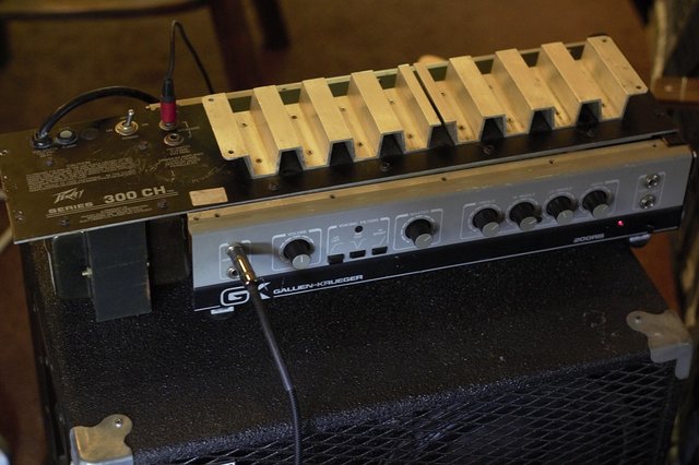

I got that Peavey head that I got for free working again by jumping the broken pot, by just staring at it and figuring it out. I will break even with 150 watts into 4 ohms. Peavey has not responded with the schematic - probably shortstaffed because of the pandemic. I think the Peavey has exactly the same +15v/-15v to the preamp board that the GK uses (as discussed earlier) so I think this is going to be pretty much plug-and-play.
The happy ending to this conversion: the Pallien Kruegey
In the end, this DIY did not involve any electronics at all, really. Peavey didn't get back to me with a schematic and I just checked the output of the 300 Series Monitor head, and it was sending the exact same 15v as the GK. I just figured out what was what and stripped the Peavey leads and plugged them into the GK.
The amp looks kind of funky; gained a lot of weight and got a spiky haircut, so it looks like Guy Fieri I guess. 😀 Sounds fantastic. Just like the GK, but the Peavey power amp is dead quiet. Solid state amps really sound different from one another, and the GK sounds sharp but not clacky, and warm on the bottom, and has this tremendously extreme EQ that gets me what I want.
Had a sentimental attachment to the GK, which I bought in SF 25 years ago for $40, and I like the sound for bass. But now I'm using it for guitar in a quasi solid-state "super reverb," in the sense that it has enormous bottom through a good 210 bass cab.
I play a strat clean with reverb and an obnoxious amount of low end. The amp is using much more power to move low frequencies than a 90w guitar amp typically would. If I can get a cheap 12ax7 preamp for those glassy tones, I may be done fussing about guitar amps.
Many thanks to the thread contributors for inspiration and explication. Didn't turn out to be a modern class D thing, but instead an 'upcycle' of an old amp. This whole thing is sort of bolted together a bit wonky, but I'm not about to embark on the Monsters of Rock tour, so it just has to sit there on my cab and work. Couldn't be happier with the results.
