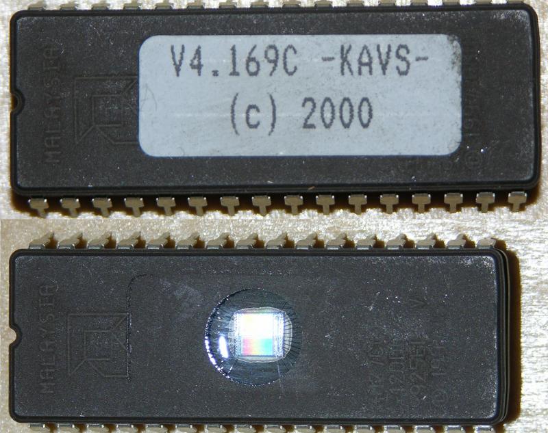

iampivot said:The same procedure applies;
1. identify the microcontroller, eg. take a photo of the PCB and post here.
This is the microcontroller?
Thanks.
The chip is a plain EPROM chip, and it is possible to read out the content of this one if you have a small EPROM programmer.

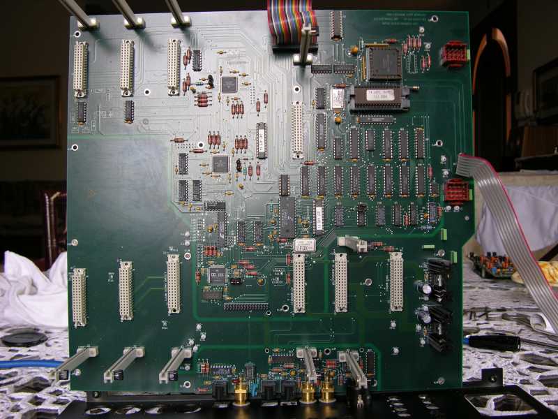

Is there any other chips on the PCB? Can you provide a overview photo of the inside of the case?

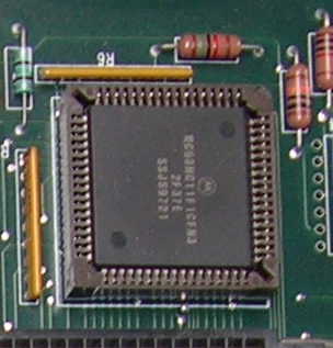

The microcontroller is probably the square one in the upper right corner, sitting in its own socket. Can you post a close up photo of it?
iampivot said:The microcontroller is probably the square one in the upper right corner, sitting in its own socket. Can you post a close up photo of it?
Is this?
If you want more resolution I send tomorrow.
Thanks.
Yes, that's the microcontroller, an MC68HC11F1CFN3. I think that one is similar to the one in the 300iL, except that it doesn't have any internal (E)PROM, thus the external one you've posted pics of previously.
I think the easiest path forward is to get the data off the eeprom, then get the program disassembled using a 68hc11 disassembler. That would allow you to find the entry point where the code needs to be patched. jbug11 is such a disassembler. You can probably find an eeprom programmer on ebay.
I can't really support you on getting the data off the eprom into your computer, or programming it, as I've never done this myself. Time to call in your local electronics guy.
