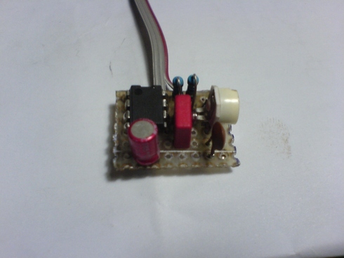

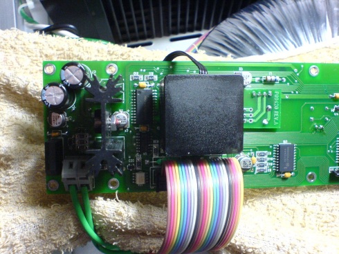

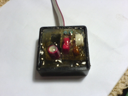

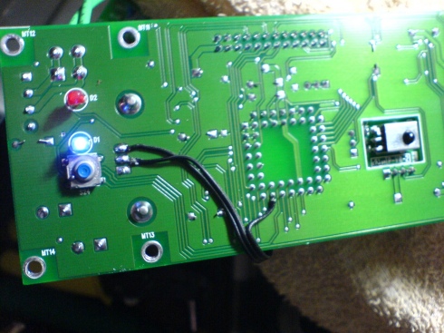

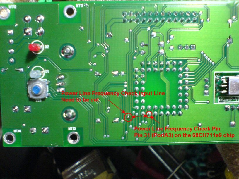

I finally got my 400xi converted the "hard" way😉
I used a 555 timer to build a small astable circuit, feeding the 68CH11 microcontroller with a ~60Hz pulse signal. My 400xi can be turned on normally and every function works now! 😀
Thanks to philbyx and iampivot for providing the crucial info.

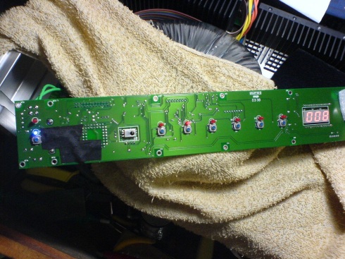

Dear Stevexyz and Jampivot:
I connect the cicuit like your diagram and the amplifier power on but the S1 input has not light and if you connect signal has no output by speakers. Do you known if is possible the amplifier is bad and this input has short circuit by example and the microchip is testing and power off the amplifier and power on every 18 seconds.
The situation is very rare because i check the signal and the circuit is given 60hertz and the amplifier power on but every 18 seconds power off/on/off/on.......... like mencioned before the S1 has no light and no output if you connect signal, the other work well but the amplifier not maintain power on.

Not quite sure what's wrong with your amp. but you need to cut the original circuit (the one that's feeding the power line frequency to the IC) before you connect your oscillator. You also need to power your oscillator. I used the onboard 5v supply so I don't need to use any external power.

Well, maybe your oscillator is not very stable at 60Hz, or there might be something wrong with your amp. You might want to check your oscillator first.

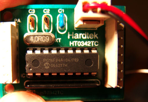

Hi:
Curiosly if i put the switches to 212(120v) and connect to 110volts transformer the remote controler works and some function also for a while but if i put to 222(240v) or 221(220v) the remote control no work and the system is more inestable.
Here is my oscillator made with a pic, normaly more precise but my tester show 61hz.

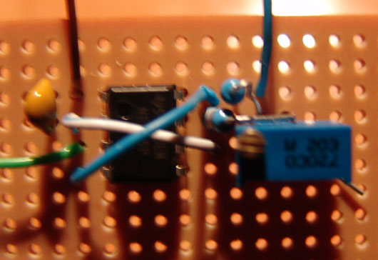

Yeah, I use a potentiometer to vary the input frequency until my amp powered up normally. I'm not quite sure the exact frequency because I don't have a scope, but according to the formula, once I increase the input frequency to some point or higher, my amp will power up normally. You can try it out and see if it works for you. I used a 555 timer circuit. Just do a little google search you should be able to find out lots of websites have the circuit diagram with all components listed and calculation formula.
When the amp senses the frequency is wrong, it doesn't turn on at all. I'm not sure if it senses the frequency after startup as well though.

For measuring frequencies, you only need a multimeter that can count frequencies as well, they should be pretty cheap.
