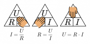

Ohms Law... the most necessary formula in electrical matters. Practice this just a few times with 5V, 9V, 12V etc. so you know how it works. In the LED case the LED has an Uf or forward voltage which you distract. So in case Ubatt is 12V and Uf of a normal green/amber/red LED is around 1.8V and desired result is a dimmed LED at 2.5 mA then:
(12 - 1.8)/0.0025 = R series = ?

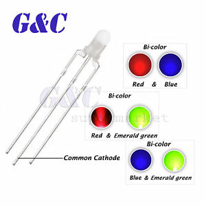

Now if you read the datasheet carefully you will see an "overcurrent LED" can be connected about the same way as the power on LED/Thermal LED. If you play very loud and the amplifier overheats the power on LED will stop glowing indicating the amplifier is overheating. This tends to be forgotten. For true LED porn you could combine the 2 functions with a bicolor LED with common cathode and both OC/Thermal pin high so both 5V under normal circumstances. The LED will emit the 2 colors mixed, in the case or a red/blue bicolor LED the light will be purple. When one of the error situations occur either one of the anodes will be pulled low and the LED color will change. Yes that also means 2 series resistors. Thermal could be terrible blue light, overcurrent could be red light in that case.
